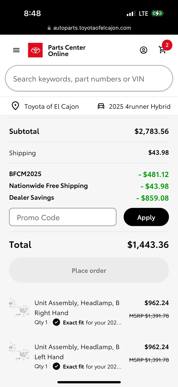

Look at other dealers. I live in Phoenix but nearest dealer who offers 25% off is in Tucson (2hr drive). I found a dealer in California (no sales tax & free shipping). Attached price for set with price breakdown.
