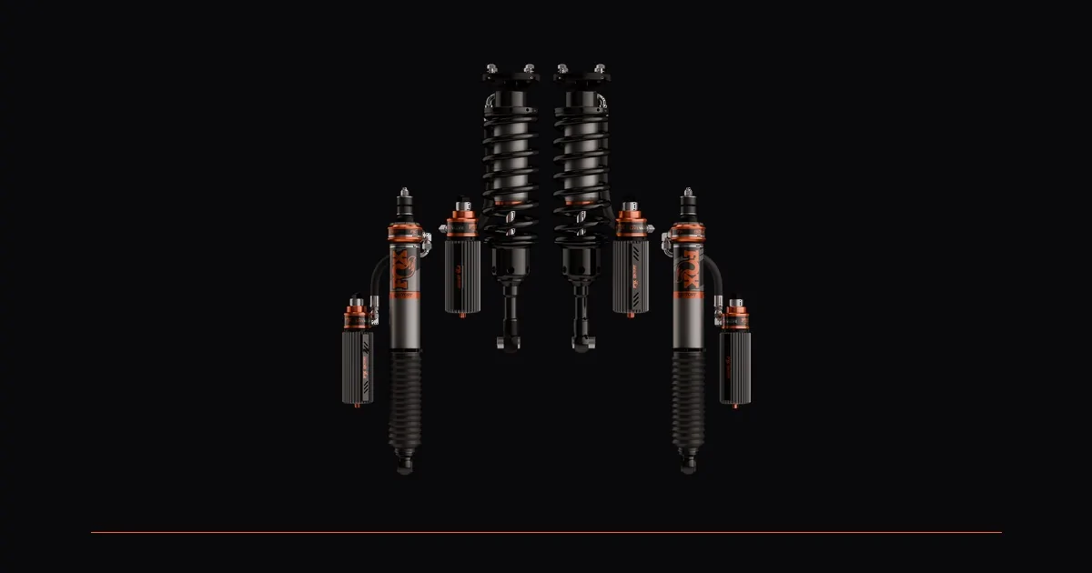

Factory Race Series 3.2 Internal Bypass Coilovers (front pair). Internal bypass means the shock body has ports machined at specific intervals along the inside wall. As the piston moves through its stroke, it passes these ports. Early in the stroke, fluid bypasses through open ports keeping damping soft. Deeper in, fewer ports are open so resistance increases progressively. Same design Fox uses in Baja. Each shock also has an electronic solenoid valve that controls compression damping in real time by restricting or opening fluid flow.
Factory Race Series 3.2 Internal Bypass Shocks (rear pair). Same architecture. Stem mount with rubber bushings on top, eyelet on bottom. Each gets its own solenoid. Four shocks, four solenoids, four corners of independent damping control.

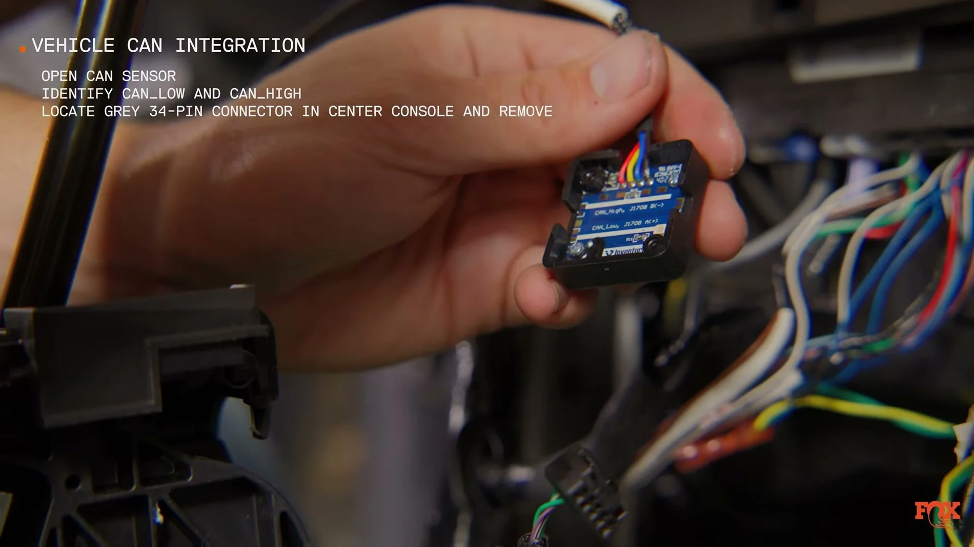

CAN Sensor. Taps into the Tacoma's data network. Reads speed, steering angle, brake pressure, throttle. Clamps onto two wires (pin 25 CAN High, pin 26 CAN Low) on a gray 34-pin connector behind the center console. No cutting. No splicing.

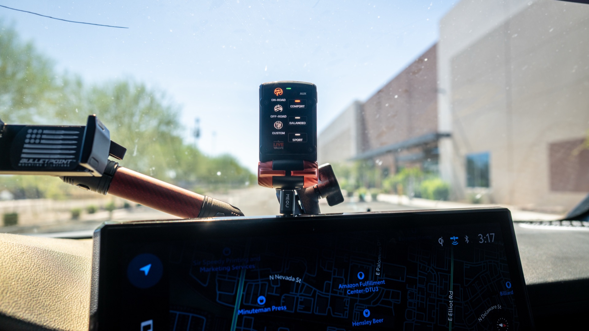

Mode Selector. Red dial, mounts left of the steering wheel. On-Road, Off-Road, Custom. Bluetooth. Press start/stop 11 times to pair (seriously).

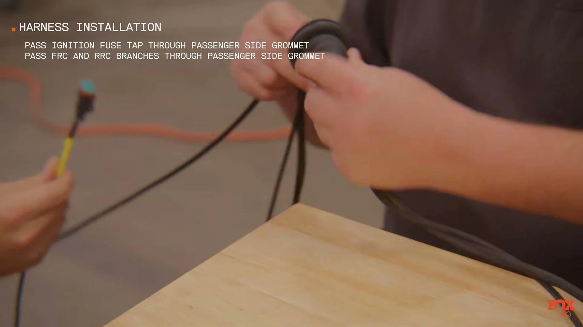

Wiring loom. Labeled branches to all four corners: FLC, FRC, RLC, RRC, plus IMU, CAN, sensor, power, and ignition. Includes grommets, zip ties, a 3-amp fuse, and an ignition fuse tap for slot F5.

The electrical side is where it gets real. Fox's video runs 19 minutes. Both front seats come out. Entire center console gets pulled. Gear selector removed. Wiring routes through holes in the cab floor, down the frame rails to each shock. CAN bus tap, IMU mounting, ECU under the carpet, power to the hybrid battery, ignition fuse tap at slot F5.
2024 Tacoma Fox 3.2 Live Valve for the 4th Gen cable-routing
Plan 5-6 hours for the electrical side alone.

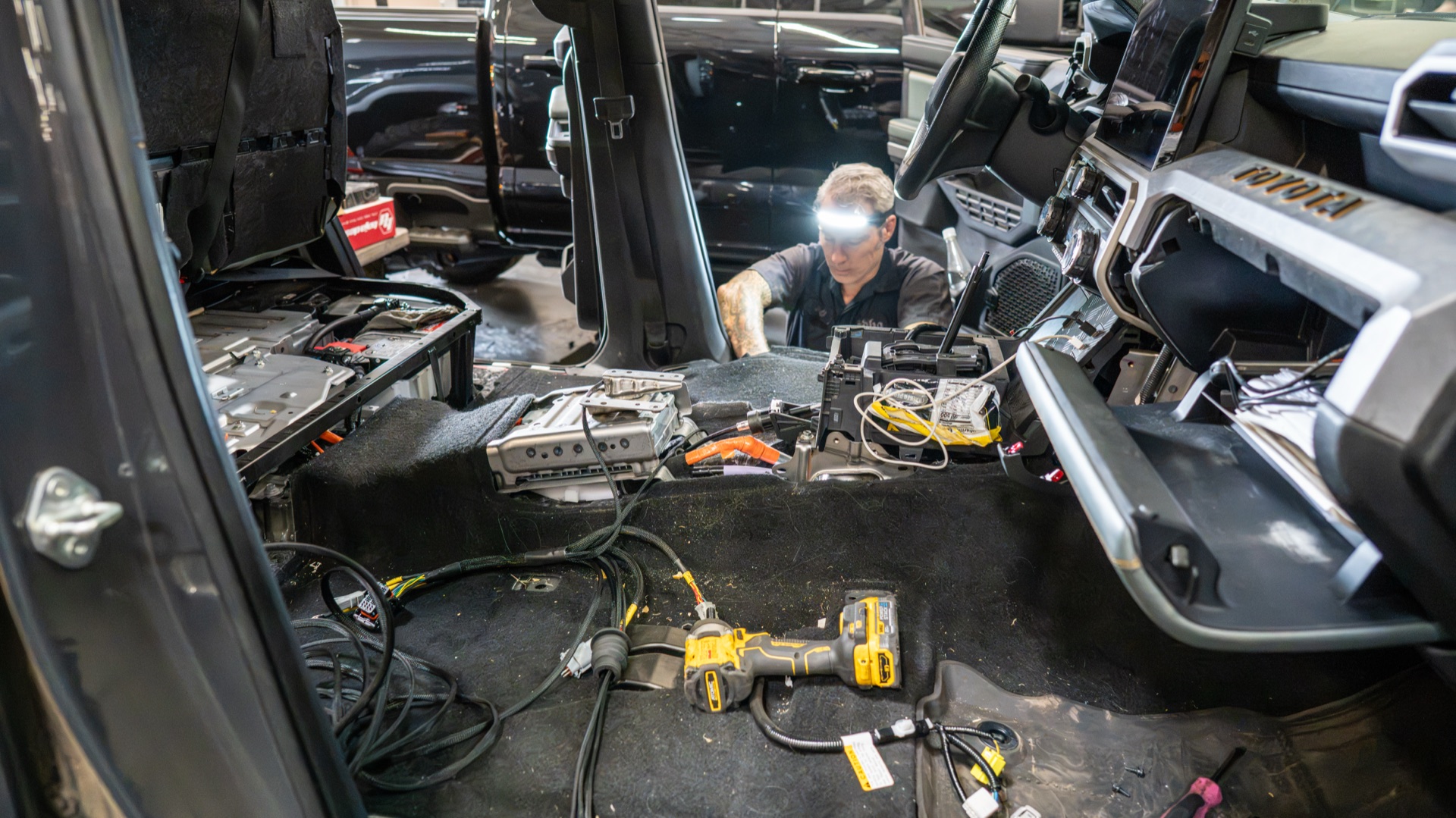

Some honest numbers for anyone considering this kit. Fox's install videos make the wiring look like an afternoon. It took SDHQ about 19 hours of labor to do it right on the hybrid, and "doing it right" meant pulling the entire interior down to bare metal. The double-sided-tape IMU mount from the video didn't work out on my truck either, so they fabricated a custom mount for it. If you're doing this in your driveway, plan for double the hours, or budget $2-4k in shop labor.
2024 Tacoma Fox 3.2 Live Valve for the 4th Gen sdhq-cab-teardown

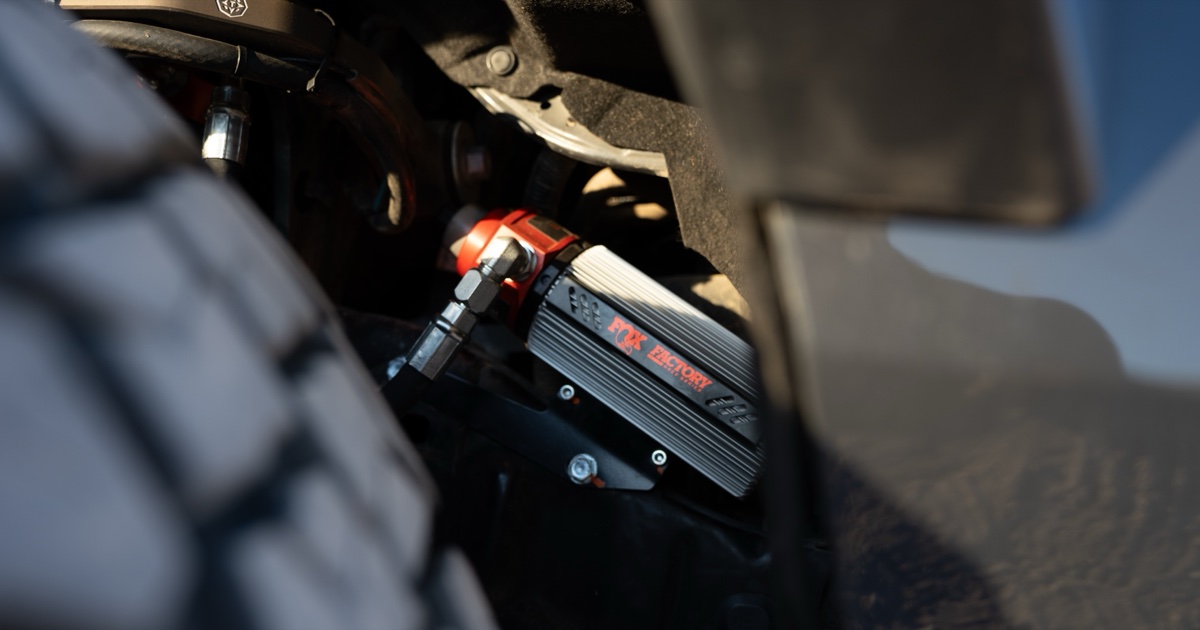

  • Best moment so far: fast runs on badly rutted forest roads off FR130 by Sitgreaves. 10/10, the system just eats that terrain.
  • On-road is the shocker. Flatter cornering at higher speed and a way more comfortable daily ride.
  • Not all sunshine: the front sits lower than the Kings did with 600lb coils and rubs the inner fender both sides. Steel bumper + winch is more than the factory-spec Fox springs want to carry. Getting that dialed next.
2024 Tacoma Fox 3.2 Live Valve for the 4th Gen sdhq-mode-selector
