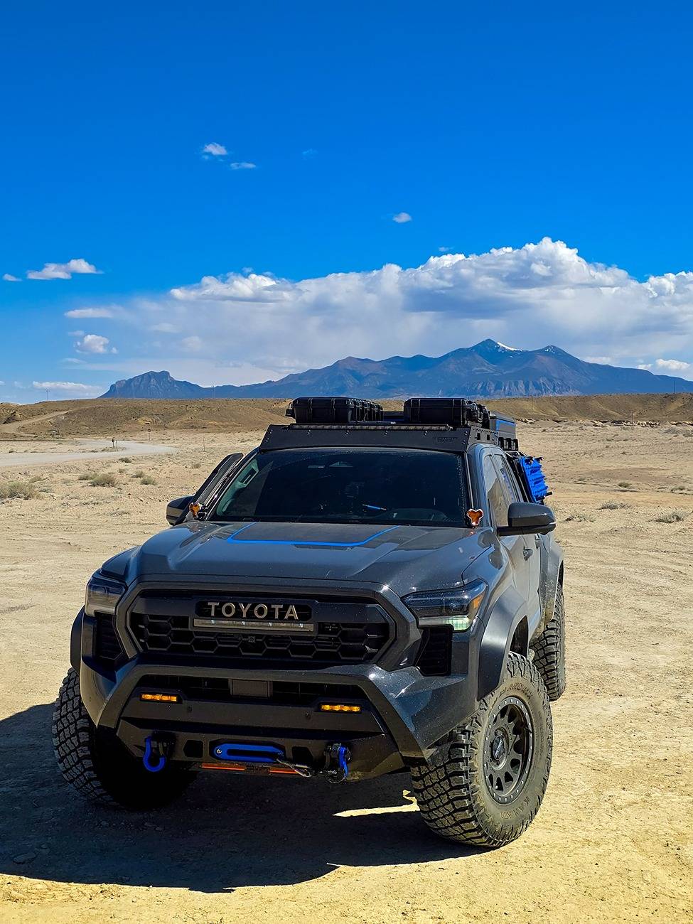

You haven't researched aftermarket bumpers or looked at there install guides at all have you. You easily know if the sensors will work before even ordering.

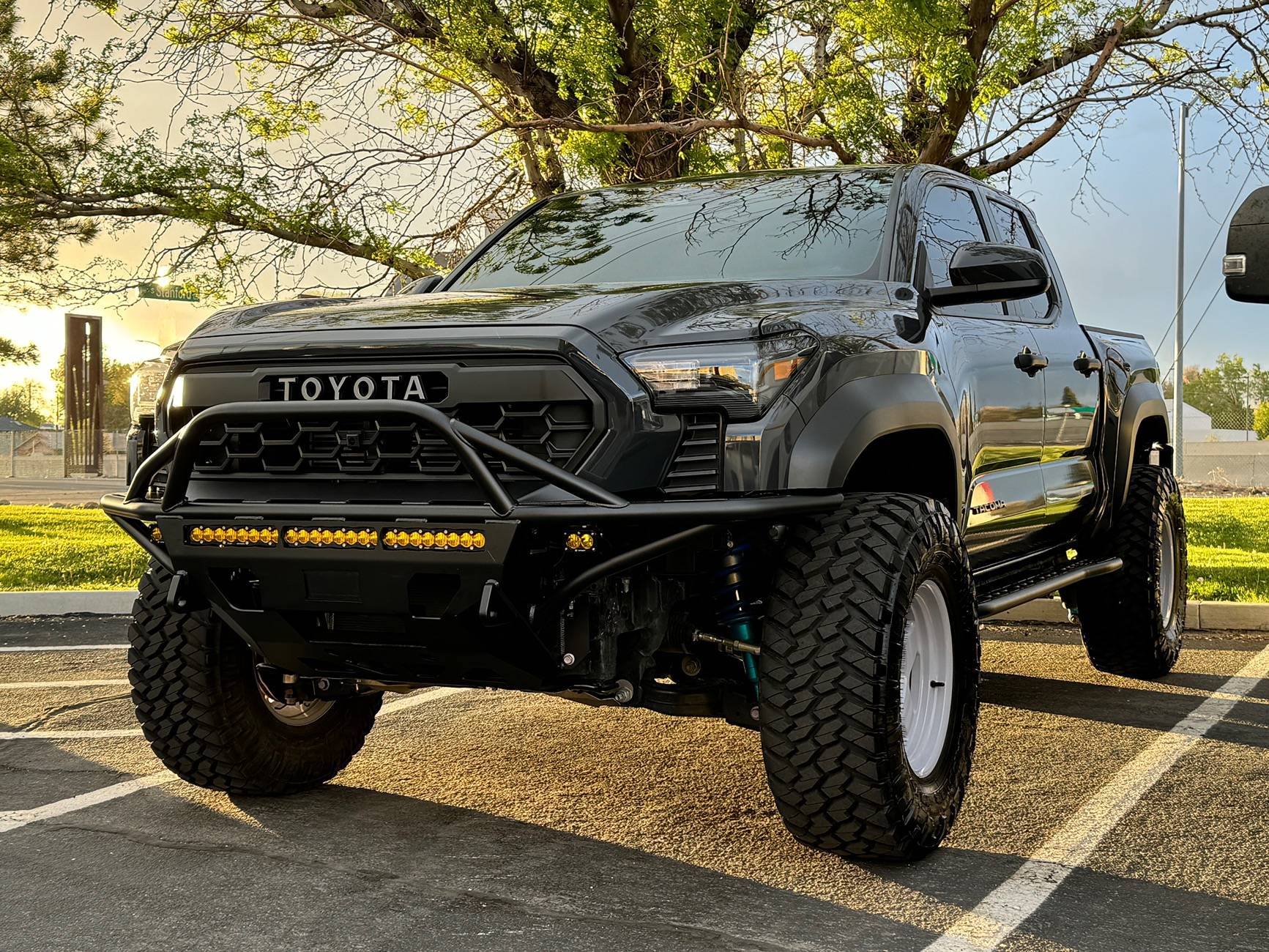

I ran the adaptive cruise control all the way to Moab from Sacramento. Lmao. I don’t know what his problem is but he clearly doesn’t have a clue about what R&D is. This isn’t something that was simply just slapped on. This was thought out, then executed. Sheesh.

My C4 front bumper.

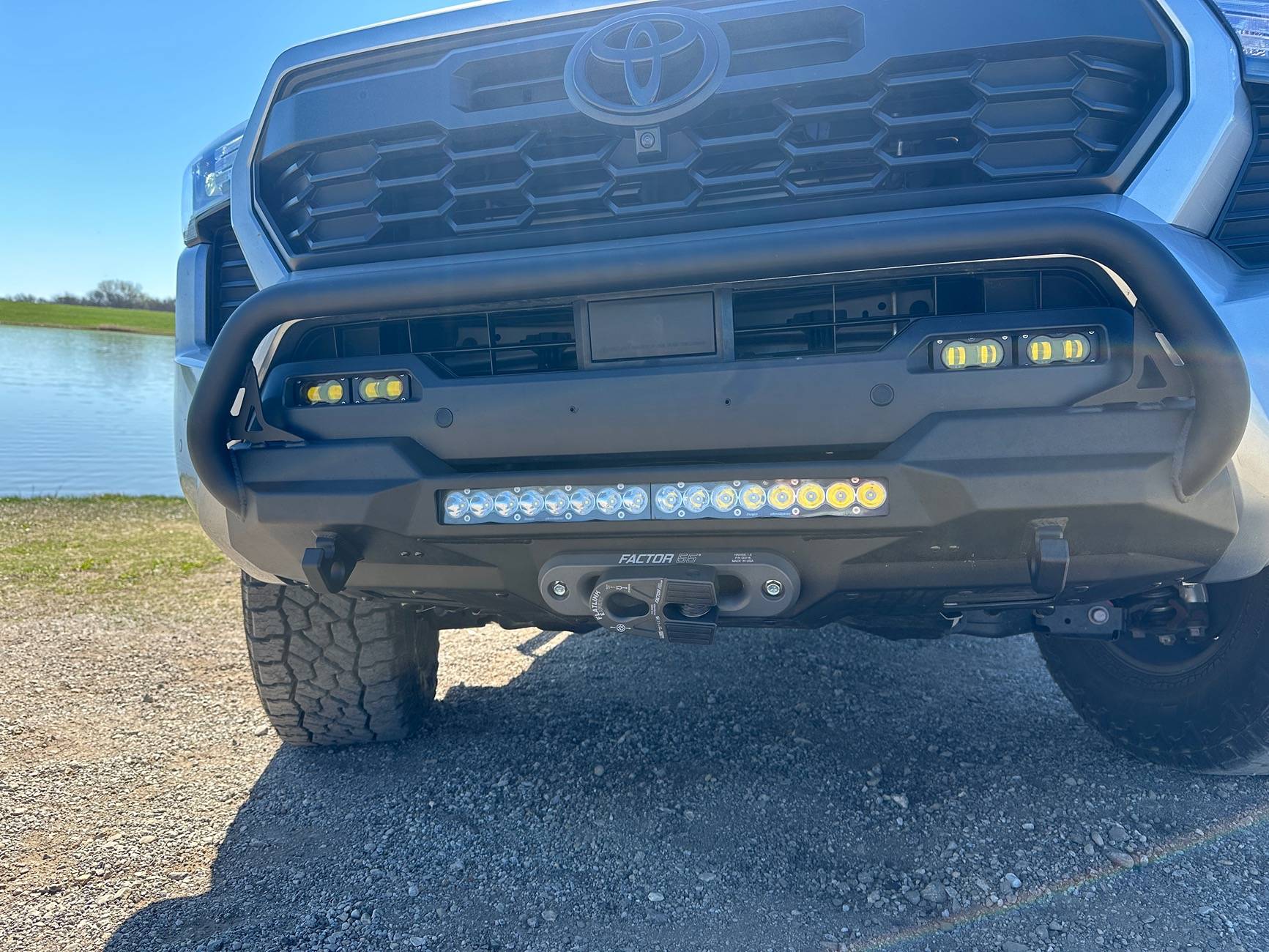

My only comment is before you purchase look at the install instructions. Pay attention to how the bumper attaches and if you think it would survive a winch pull. Some of these bumpers I would not trust to survive a winch extraction.
I went with C4.

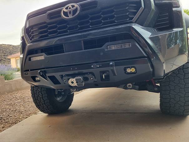

All I will say is a Toyota tech told me if you remove the grille you need to disconnect the battery first, before unplugging the grille plugs. Otherwise, your run the risk of loosing the sonar sensor and it will need to be reprogrammed.
And before you say it ... this isn't something I heard. I'm speaking from experience. I learned this the hard way. My truck was two days at the dealer while they tried to figure out how to reset the sonar. As far as I'm concerned every single company that sells aftermarket front bumpers needs to say this up front in their install directions. DISCONNECT THE F'N BATTERY BEFORE REMOVING THE GRILLE.
My C4 front bumper.

Good thing it’s in the garage. ?

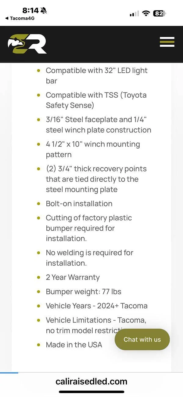

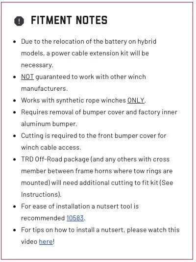

Hey! If you're still in the market for a front bumper, check out the Cali Raised Stealth Bumper for the 2024+ Tacoma:
? Stealth Bumper – 2024 Tacoma
It’s a low-profile hybrid-style bumper that keeps things tight to the body—perfect if you want added protection without going full-blown bulky. Designed to fit most 20" or 32" light bars, winch-ready, and bolt-on install with no cutting required.
Plus, you can add side recovery points and a bull bar if you want to build it out over time. Clean, functional, and trail-tested.
Your website clearly states that cutting is required. Did you guys change something?
At the 6:33 mark, you can clearly see the only “cutting” involved is just trimming a couple of small plastic tabs behind the grille no cutting the bumper, no pulling the whole front end off like older setups required.
So yeah, to clarify:
  • Yes, the website says "cutting"—but it's very minimal.
  • No metal or bumper cutting, just a few plastic pieces.
  • Totally hidden, keeps the OEM look, and installs in about 1–1.5 hours.
Way cleaner than the old-school installs. If you're still on the fence, that video makes it pretty clear how easy the process is now.
