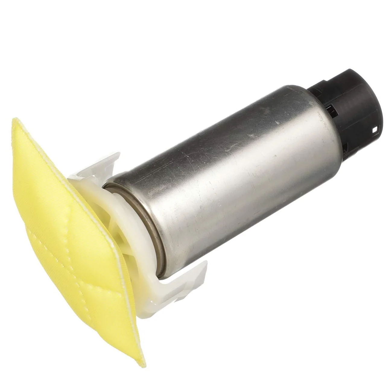

The filter is part of the pump inside the sending unit. The pump could be changed out but I doubt it would be an upgrade(unless you are getting a higher volume/pressure pump), it would likely have an OE equivalent filter as its just a small pad on the bottom. Only way I could think of "upgrading" it is by adding in an additional filter inline which really isn't worth it. This is what it looks like:
Had no idea that the filter was integrated.
Thanks for giving me a clue!
Yea most modern vehicles have the filter integrated into the pump/sending unit. Very rarely do gas vehicles use an inline filter still. Pretty much just diesel trucks for the most part.
