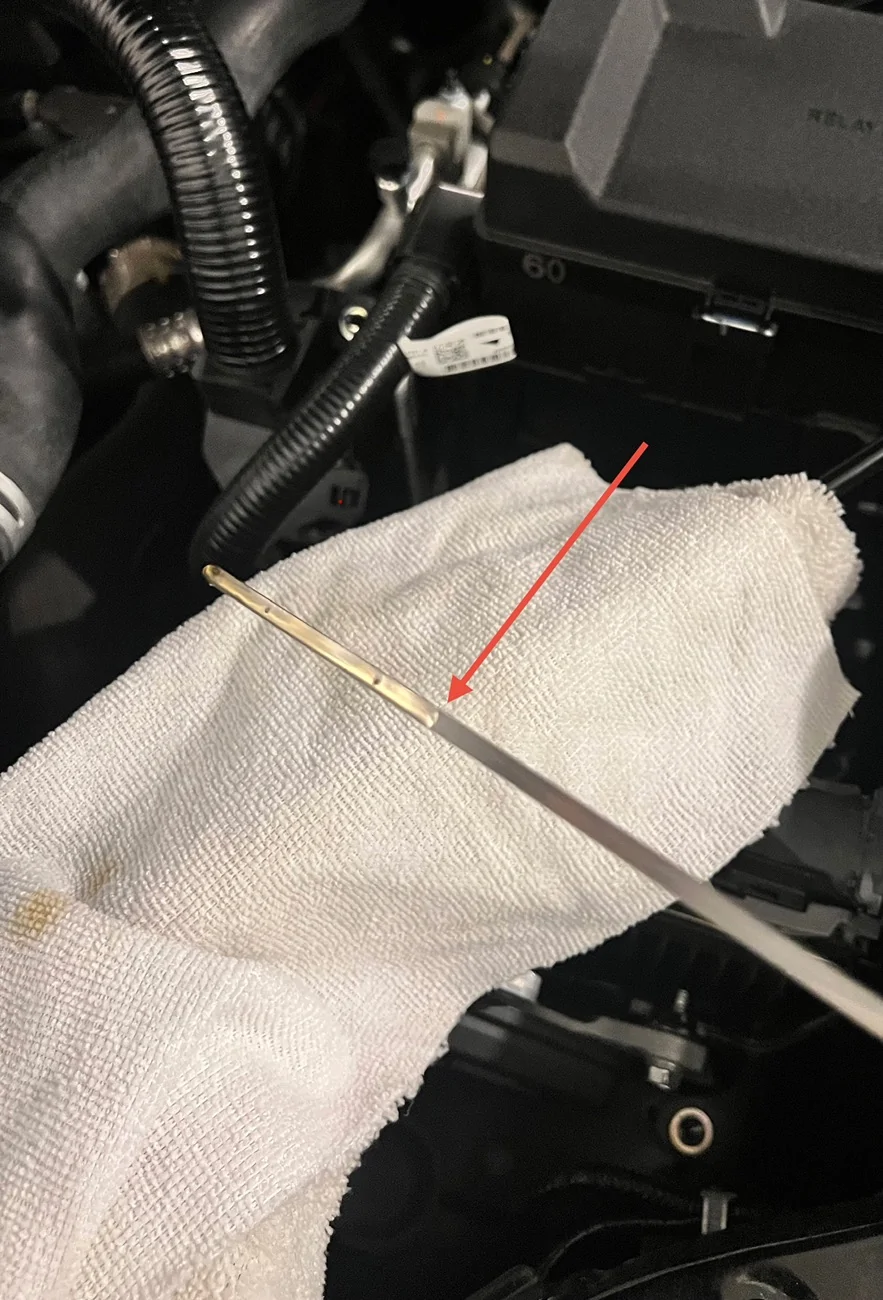

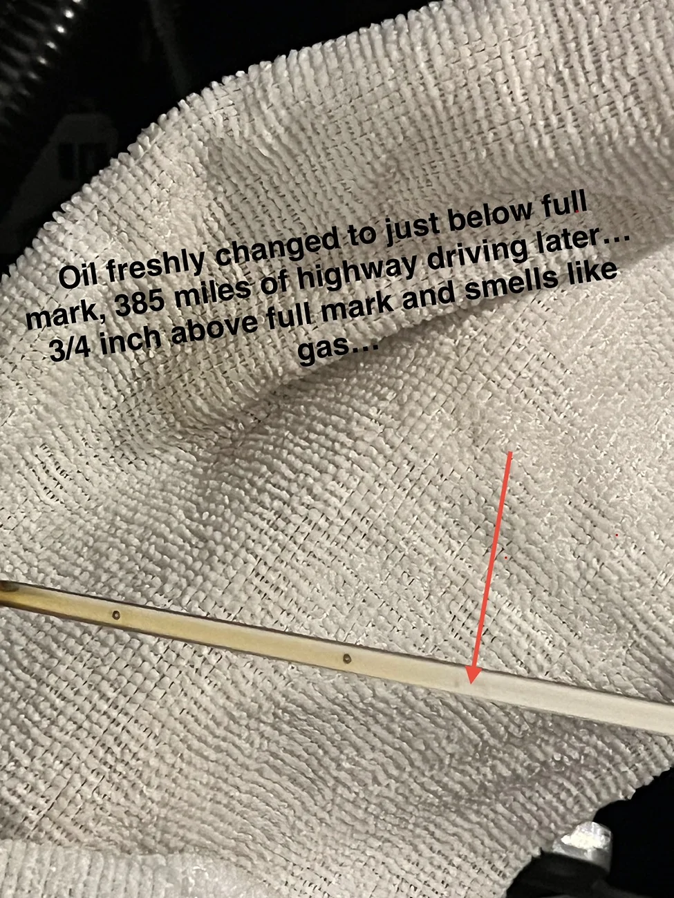

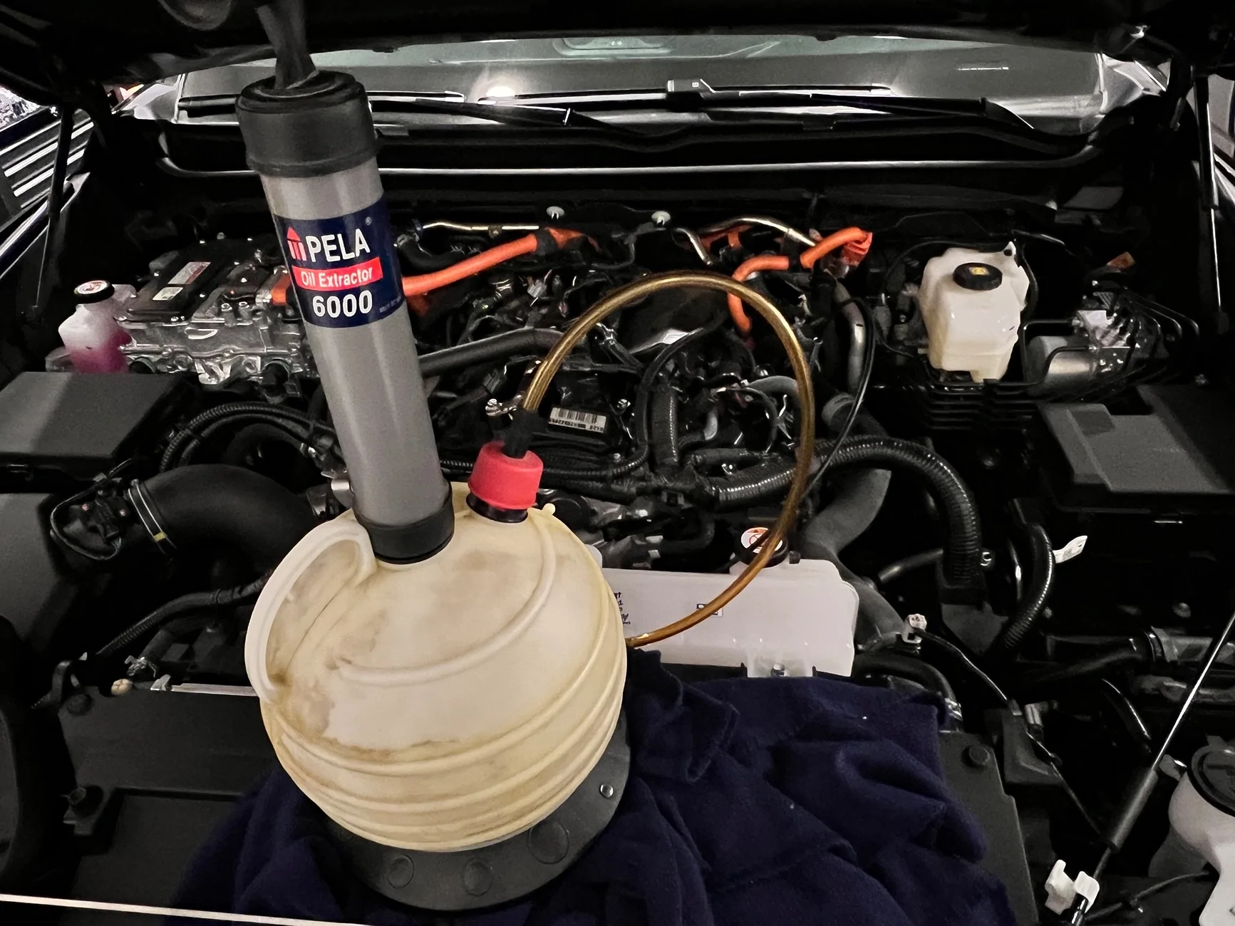

Gas in oil. Overfull crankcase. This isn’t normal. I’ll never be able to go a full OCI in the winter…
Did you check it when cold. Mine did the same thing when hot, and when I rechecked it in the morning, it was normal. Now when I change the oil, I try to get it 3/4 full and call it good.

@Rocko yeah I always check it cold, and multiple times. I just don't understand what this engines problem is! Maybe it has something to do with the excessively high fuel consumption during cold weather? It chugs gas on the highway as bad or worse than my 5.7 Tundra ever did...yet with half the cylinders, the end result is gas in the oil. Idfk anymore. Last thing I want to do is waste my time visiting the dealer...they won't do anything or even acknowledge it as a problem
2,412
3,113
Yeah, I don't think the dealer will do anything about this. But my last truck was a 5.7L Tundra and my 4th gen gets a lot better mileage than it ever did. That makes me think that there really is something wrong with your truck. Good luck and keep us posted.

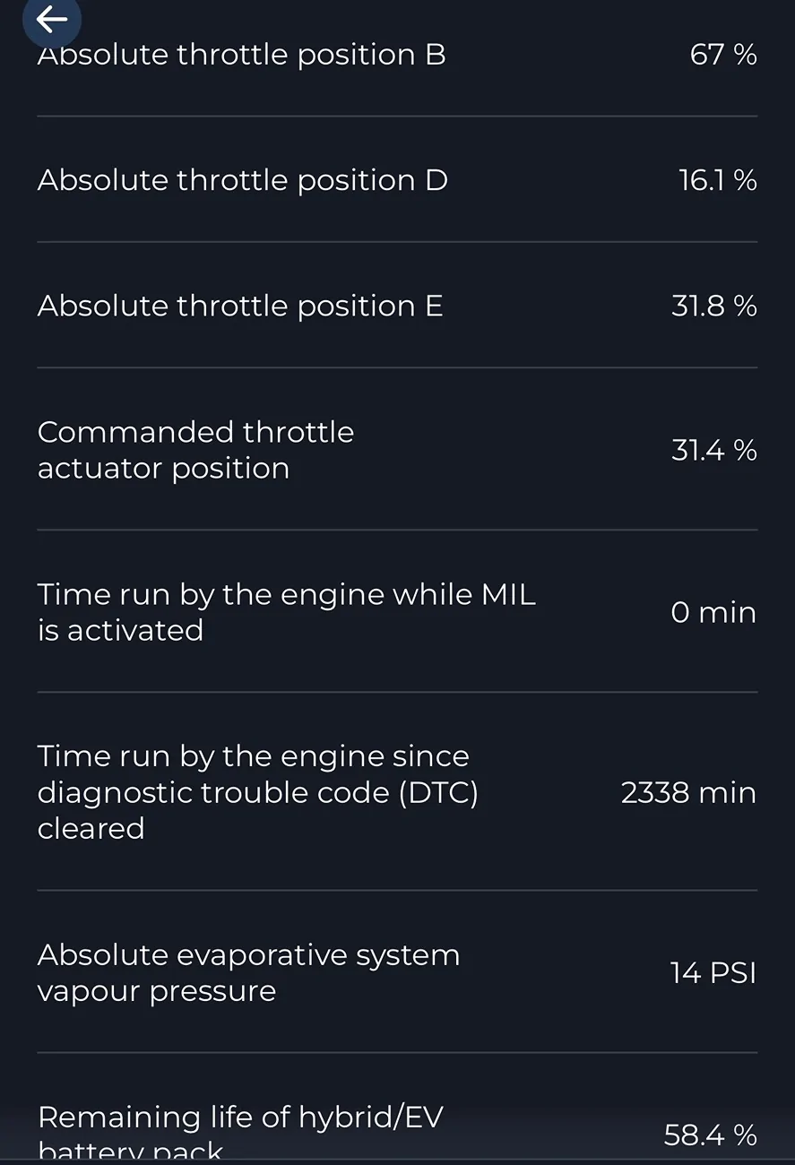

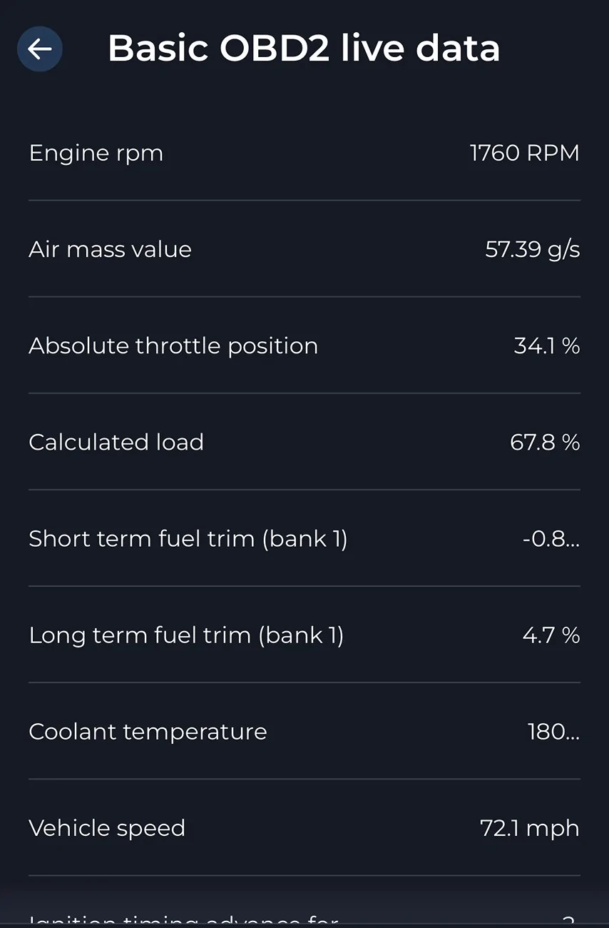

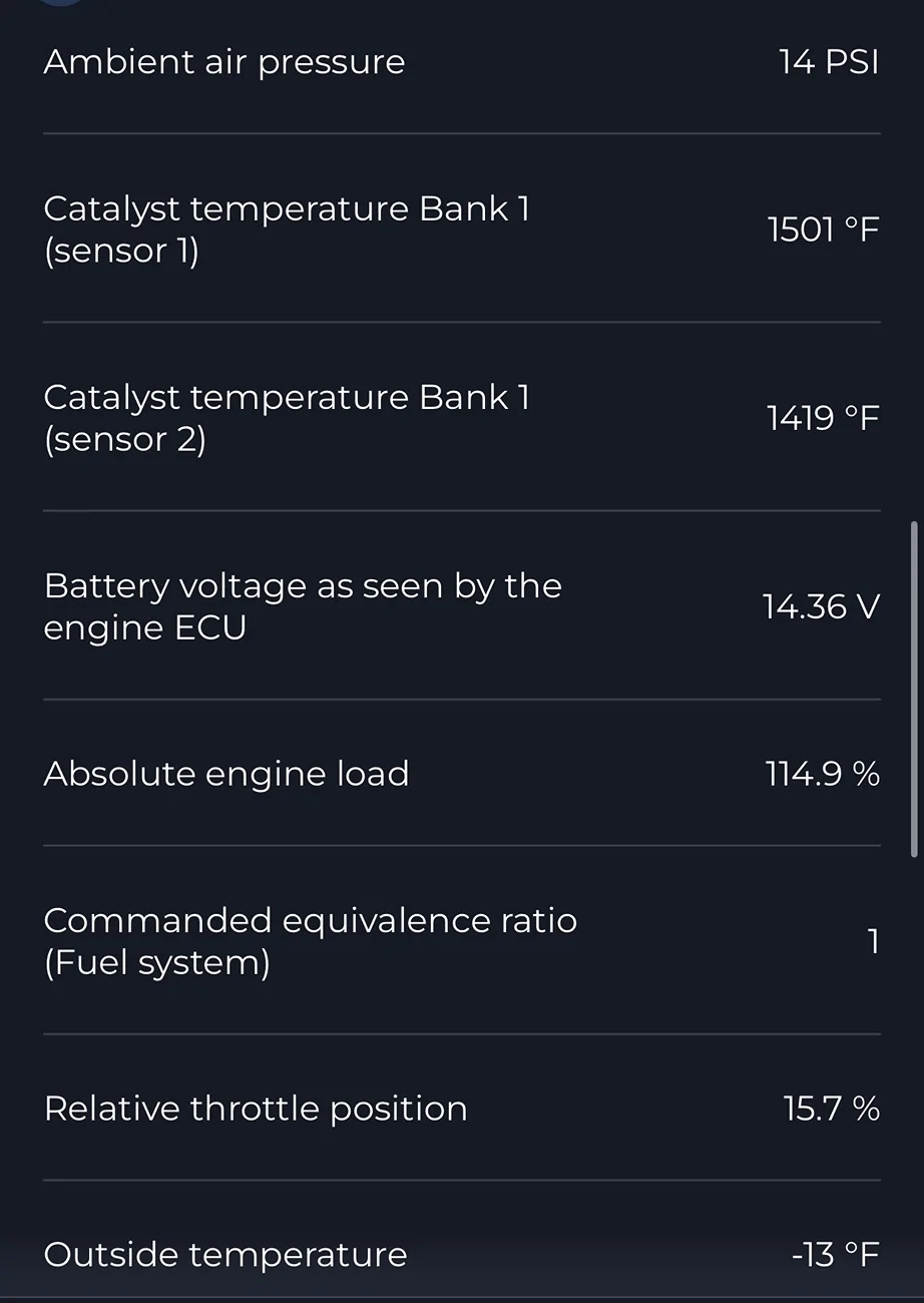

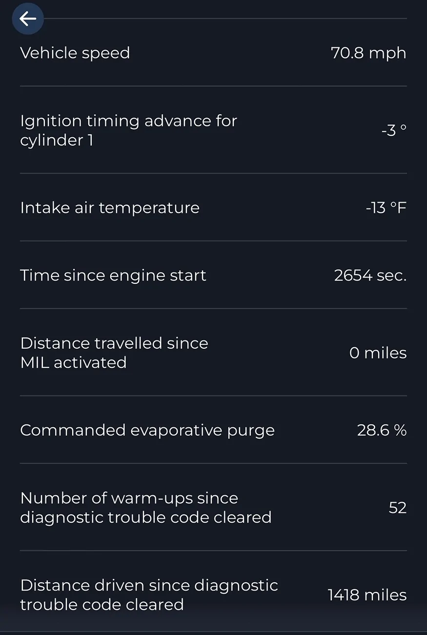

This is a screenshot of my live engine data, driving highway speeds in -13f (-25c) temps, taken 1 hour into trip, burning regular 87 (10% ethanol). Engine oil temperature is simply too low (185f). My dad was driving his 5.7 hemi ram in same conditions, his engine oil temperature was 210-212f (99-100c), same conditions, same gas.
No wonder my engine gets gas in the oil during the winter…it can’t run hot enough in the cold temps

I think the best thing someone can do is monitor the oil level during cold operating conditions (say -13f and below). If it gets too high (say 1/2 inch above full mark) and you're nowhere near due for an oil change, you need to vacuum the oil down to the add mark, and top it off with fresh oil. Keep in mind, if you are choosing to stick with the Toyota recommended 0w20 grade oil...when it gets 1/2 inch above the full mark...you are approaching near 5% fuel diluted oil and that 20 weight oil is now sheared down to a 15 or 10. It is simply not ok to keep running it like this, especially if it keeps increasing during extreme cold conditions. I have moved to a 5w30 grade, and will run that all year/all seasons. My reasoning is that there is always going to be a certain % of fuel in the oil, higher in the winter, lower to almost none in the summer. The 30 weight grade will more than likely shear down to a 20 weight grade anyways. I'd rather have that, then a 0w20 shearing down to a 15 or 10 weight grade and causing actual engine wear/damage while I cluelessly zoom around in my Tacoma. This is the best compromise I can come up with, with my next action to block off sections of the front of the truck. I just don't want it to look stupid. As a diesel truck owner, one winter I got lazy and didn't put my winter front on the truck. On a 5 hour road trip in -30f temps with a nasty wind...the diesel fuel started to gel up and the engine cut out. Luckily I had a jug of Diesel 911, dumped that in, and a pair of Carhartt work pants in the back seat. Those work pants got strapped across the grill, and I was able to make it home. So...I definitely know cold. Just never had any "winter" issues before with a gas vehicle.
