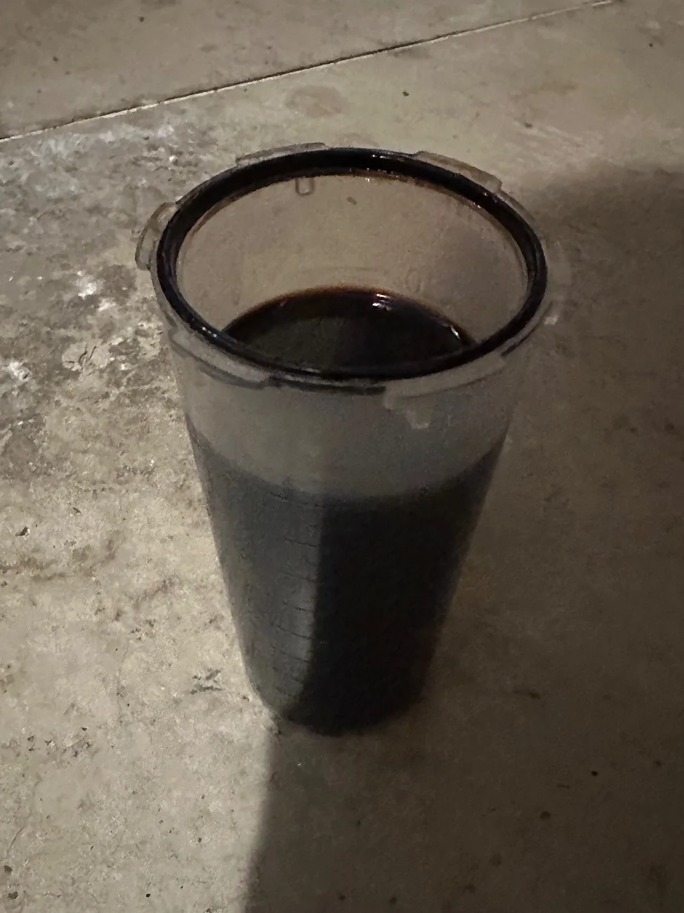

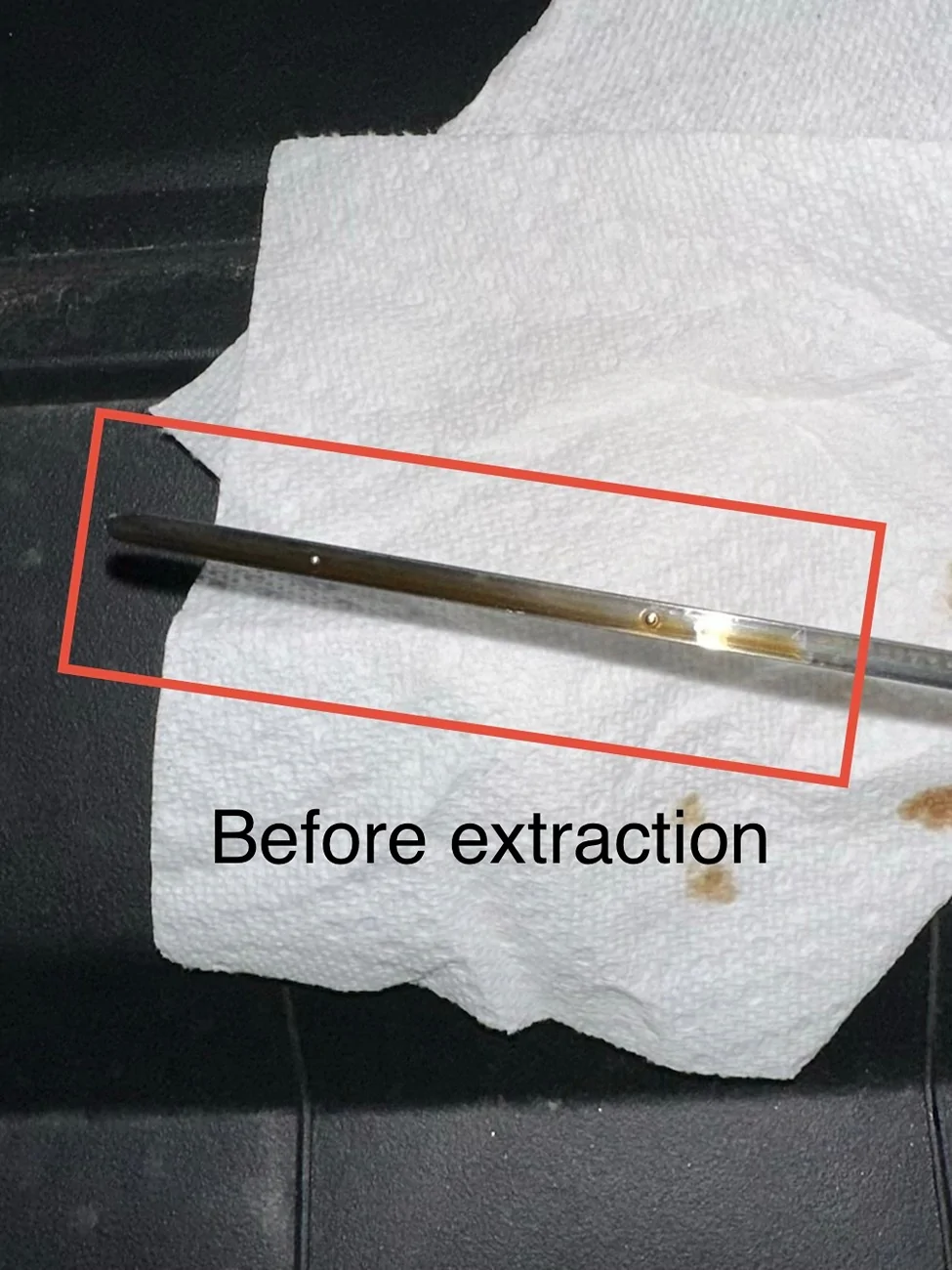

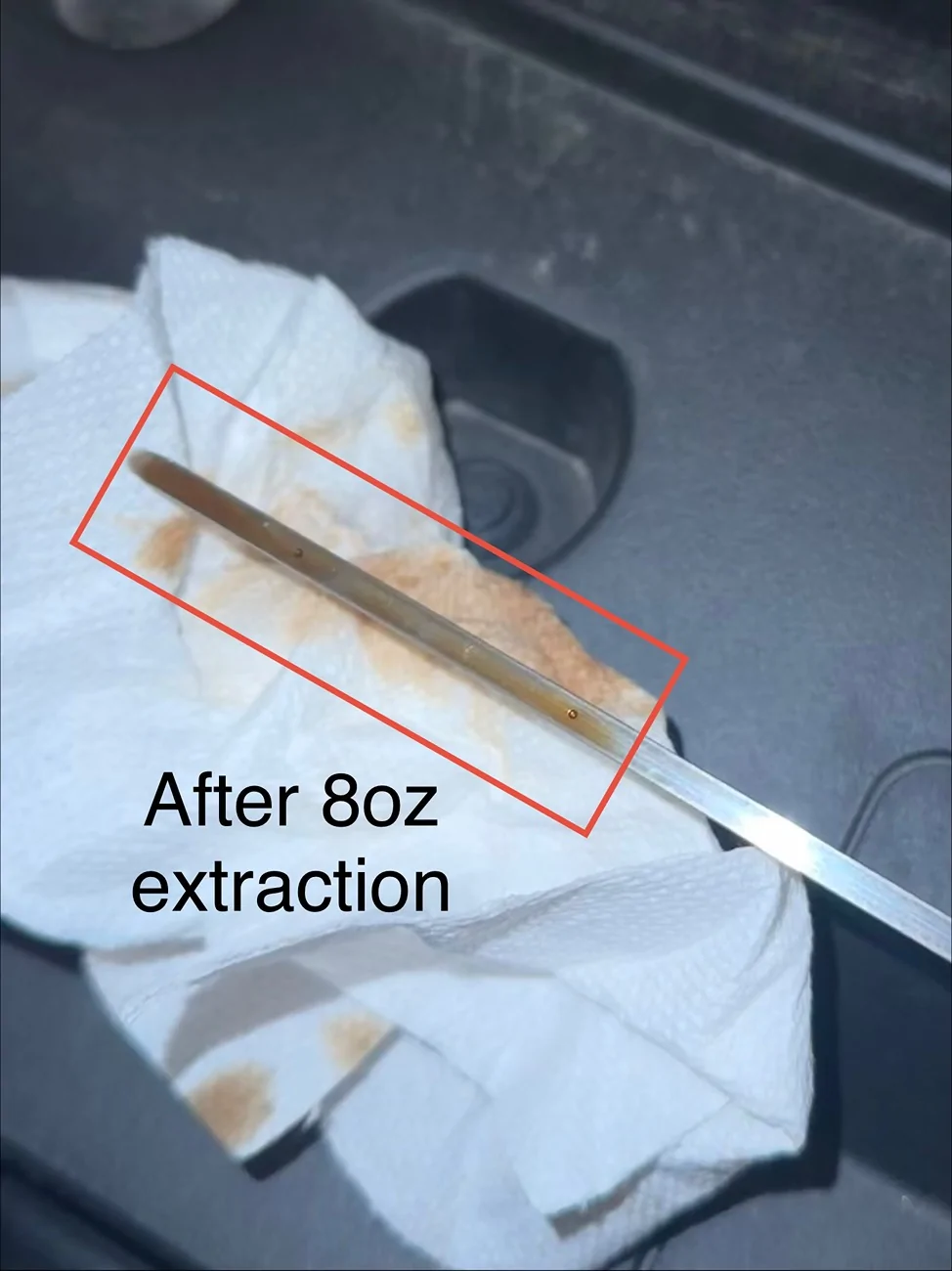

I just checked my oil yesterday and was surprised to see it above the second dot by a good margin. 3400 miles on the oil. Problem is Toyota filled it up last and I remember checking the oil after but don’t remember if it was that high (I basically wanted to check the color to confirm they changed it). Odometer at 9300 miles
I have a 25 iforce max and this is concerning. I do a lot of short trips in town, even if I used tow mode this thread implies the engine won’t get warm enough. I ordered an oil analysis kit from amsoil and am going to try to extract some in the meantime to get it lower.
Any updates from other posters in this thread? I saw that someone removed oil and the level came right back… did it continue to climb?

Yeesh. I am going to keep 4 oz and send it for analysis. I know 0-20 is low viscosity but it seems like water to me.
2,412
3,113
@4nimal Looking forward to seeing the results of that oil analysis. I have had to make a lot of short trips lately, and I need to check my oil level.
