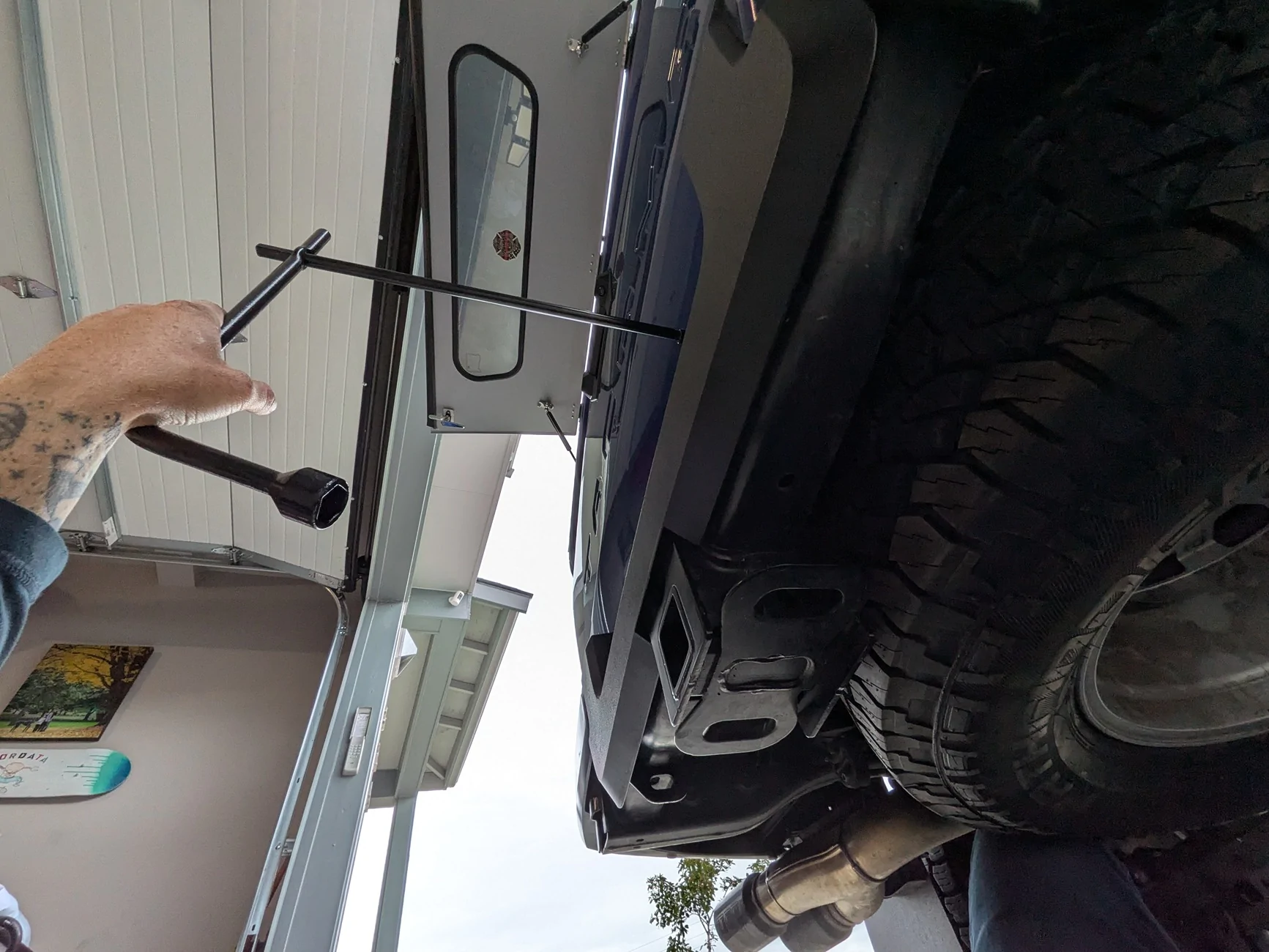

Oh snap! Held to towards the passenger side by an inch or so while tightening
Way to stick with it until you figured it out!!! That's great information to know that it can be moved around a bit!

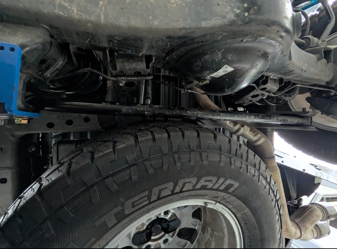

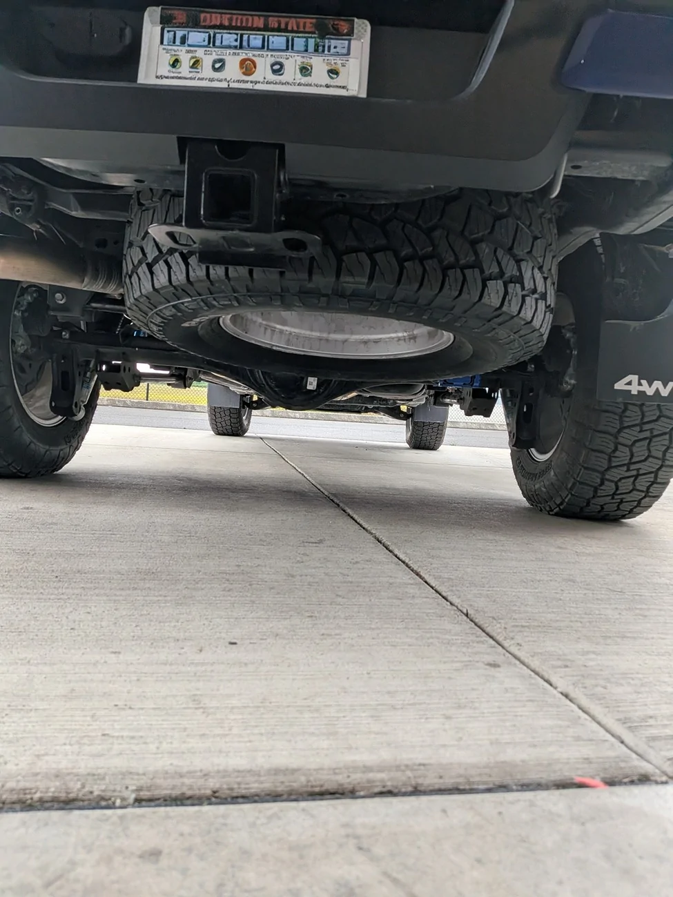

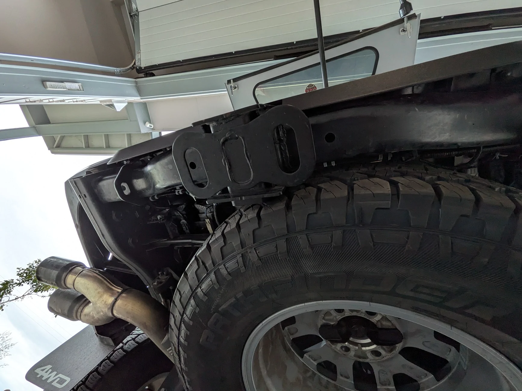

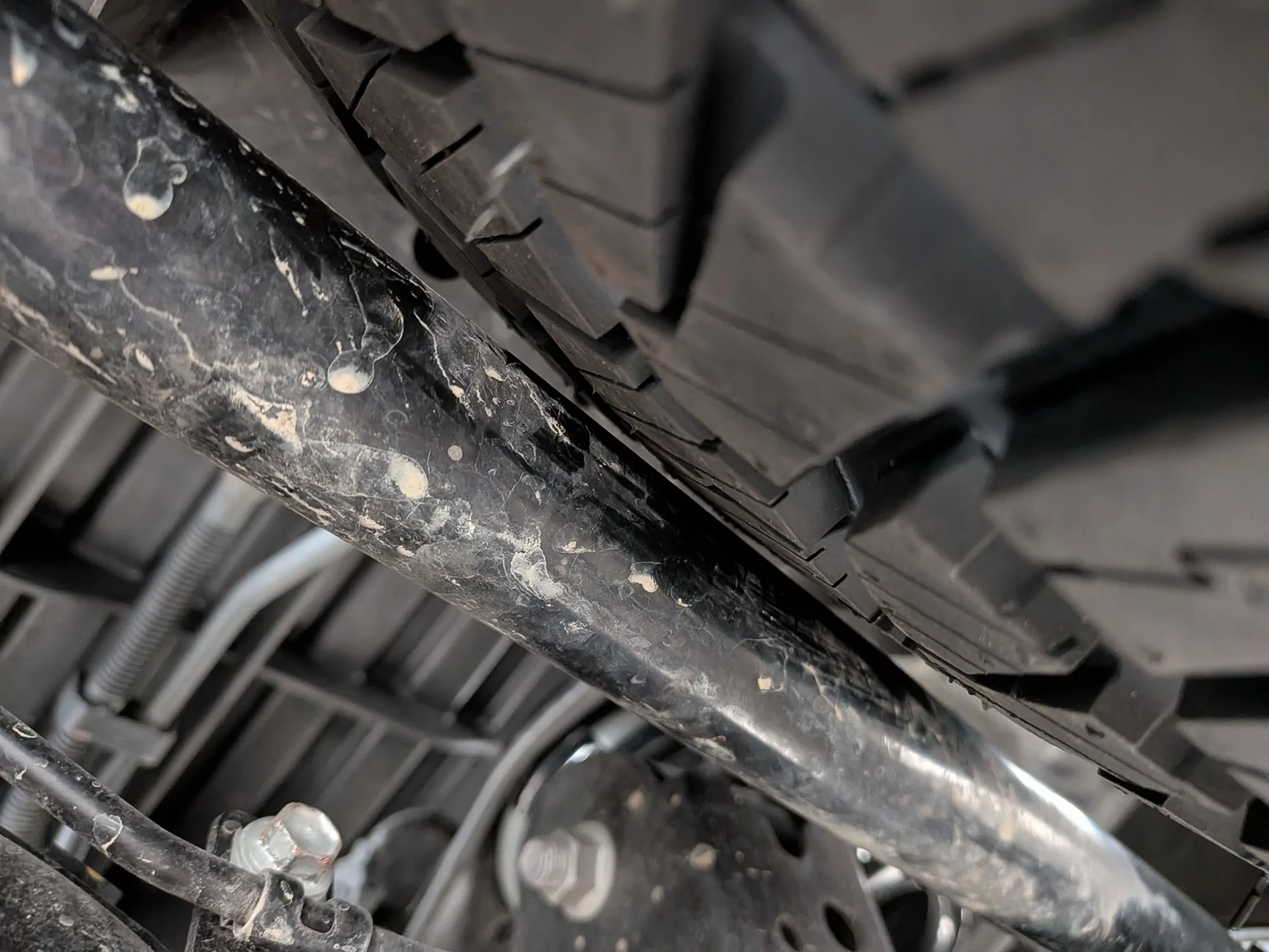

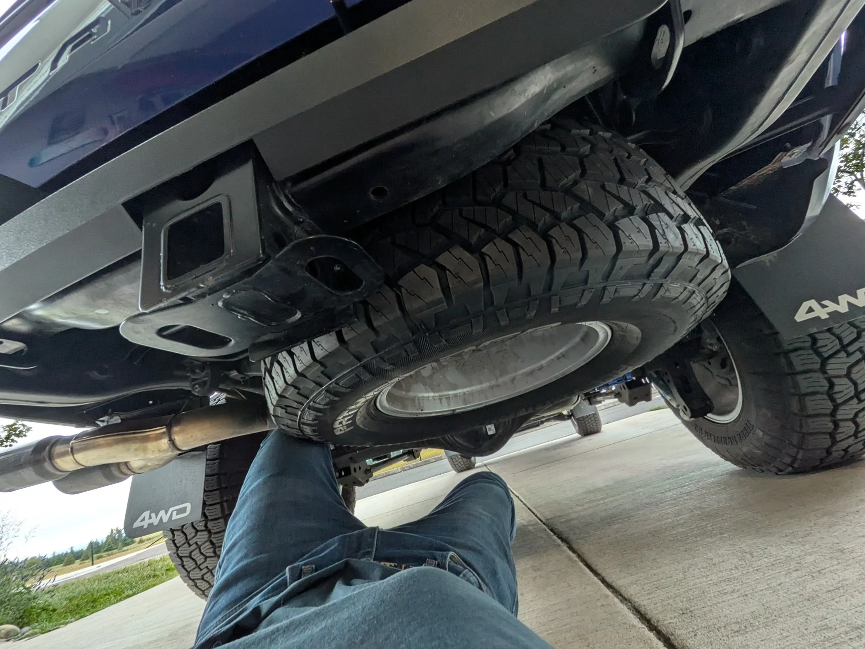

Dude I am amped right now. I really didn't want to spend anymore money 😂
It's super tight, but hey, it works until I get squirrelly in a couple months and buy a bumper.
For anyone who comes across this issue after the relocation bracket: try getting it a turn or two from totally snug, lay on your back, pushing the tire towards the passenger side brackets with your knee and tighten the chain the remainder of the way (or be personable and make some friends to help ya).
