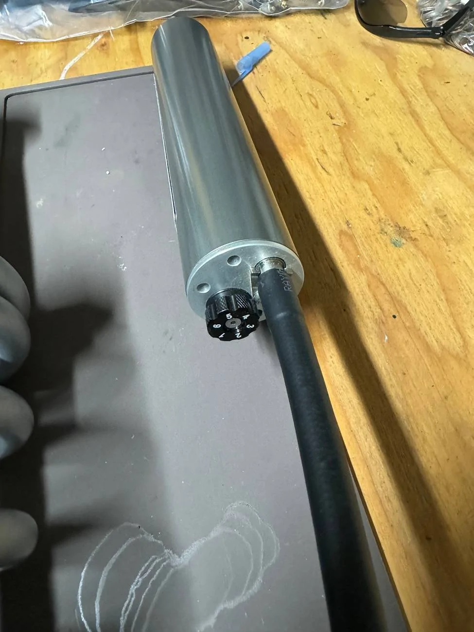

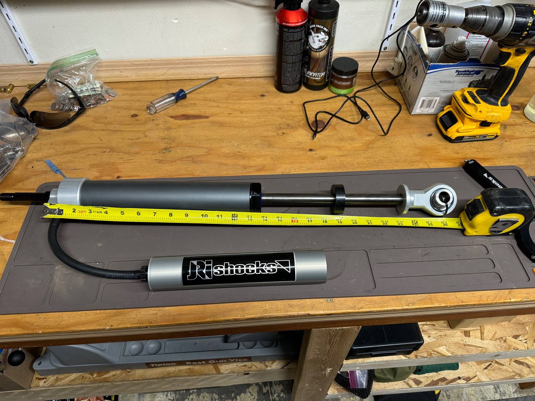

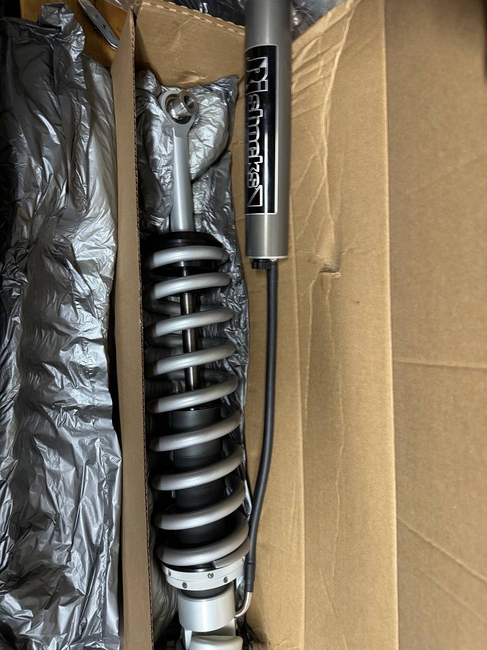

I have a set of JRI shocks. 6 stage adjustable, had them on 1 for a short time but was way to soft for me. 3 is similar to factory ride, 6 gives a very firm almost sport car ride. 1 is definitely plush! Mine are set at 3 in the rear 4 on the front. My biggest concern was how they would hold up to a Montana winter! I installed them around September and made it through the winter problem free. These are tough to beat for the price!
@JRI Shocks is also a forum sponsor
https://freedomoffroadusa.com/jri-1...ont-upper-control-arms-fo-t710fu-jri-700-362/
