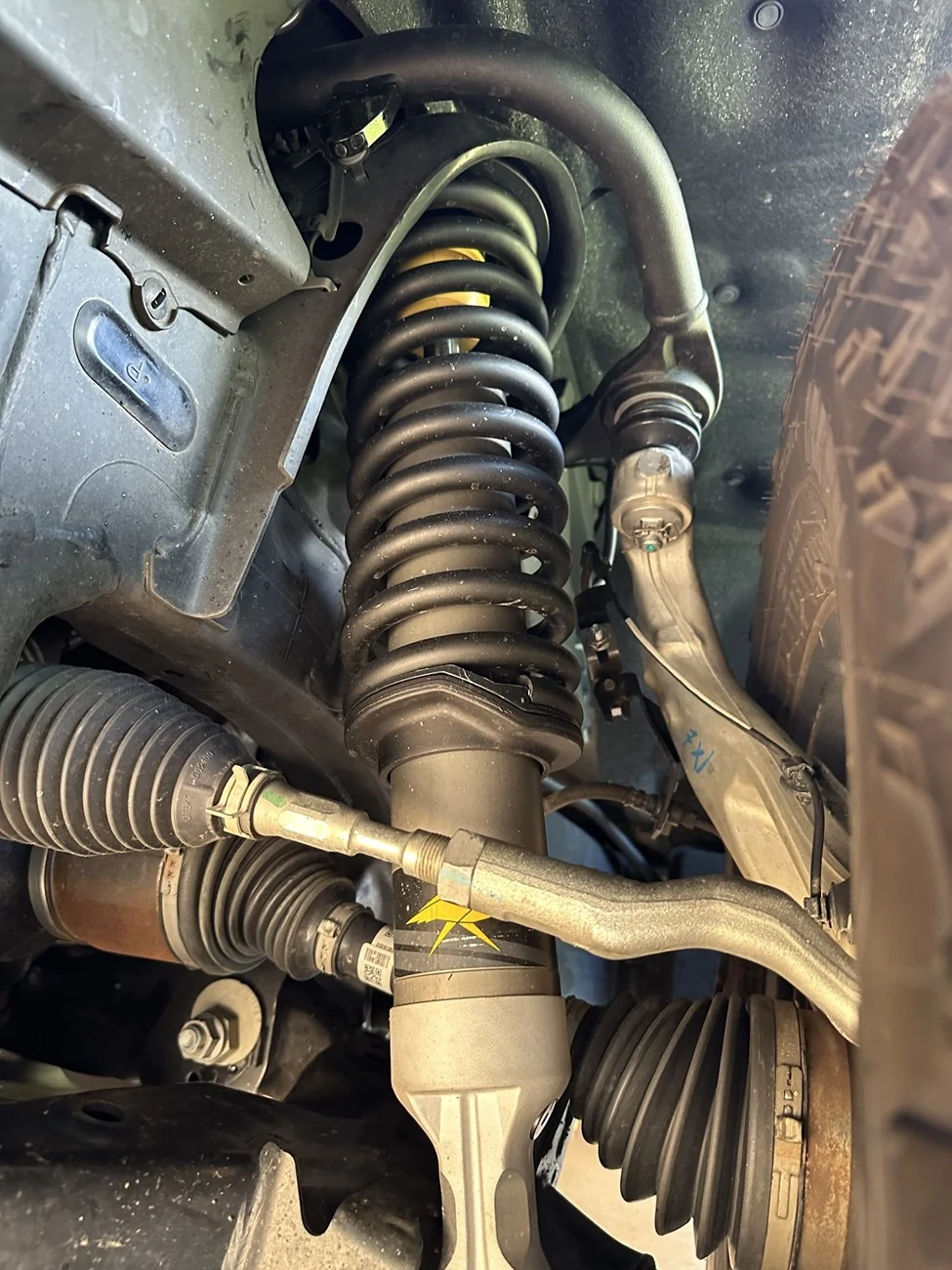

I have the MT64's installed. After a few days of driving, they settled 38.75inches in the front and right at 40inches in the rear. Measured from the ground, center of the hub up to the bottom of the fender trim. I have the clip on the front struts set to the second from the bottom (No Accessory added). Runing 28570r17 tires 31 psi. Ride is frailly comfy. It's a little bit firmer. Not as pillowy as the stock off road suspension was. I no longer get the cluck when going over speed bumps though. I will say that I wish that ARB offered some isolators for the bottom of the rear spring. They seem to make some seating noise sometimes when going down the dirt roads.
What setting are the Circlips set on for the front struts?

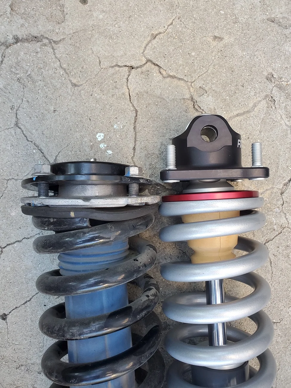

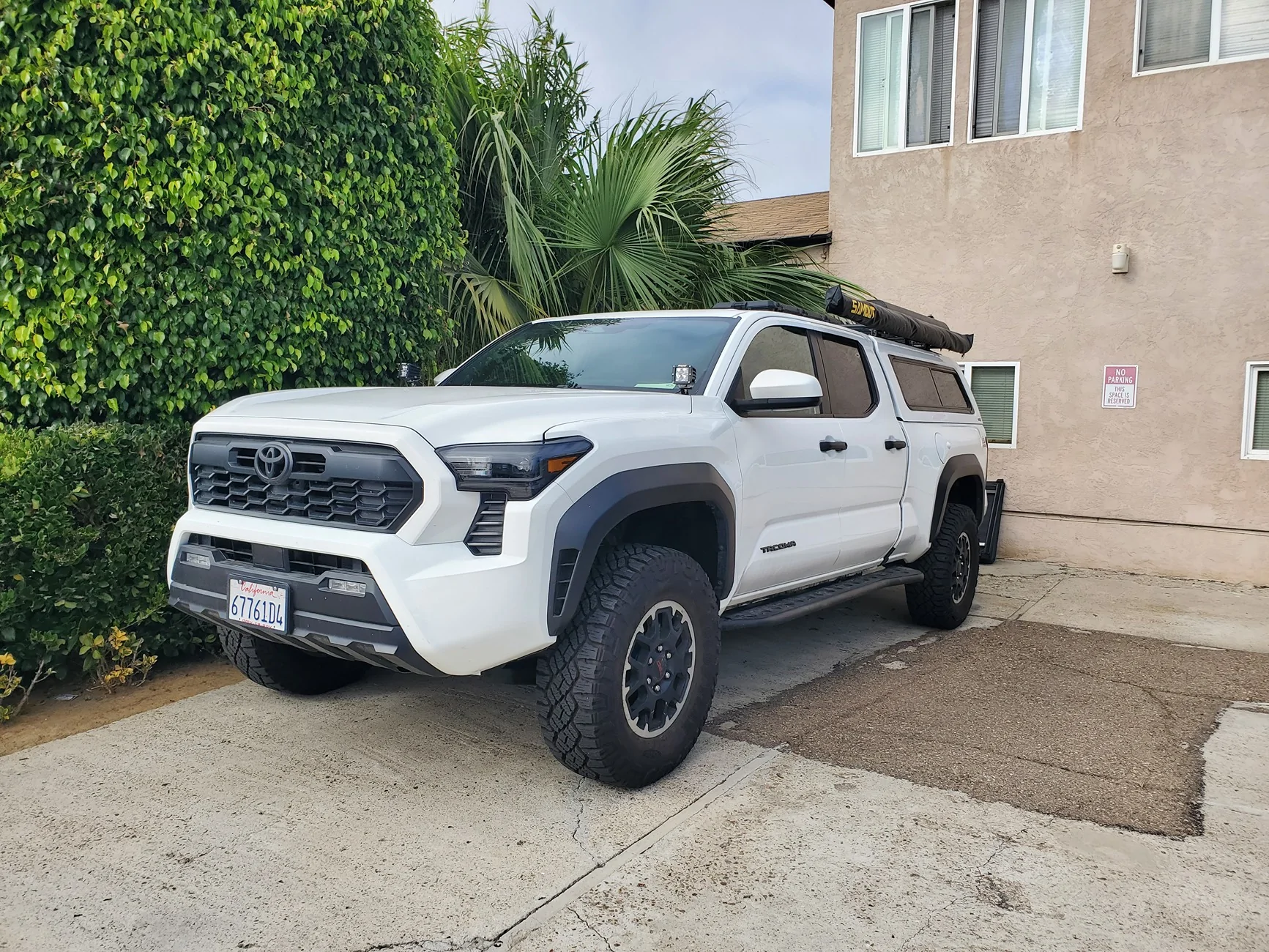

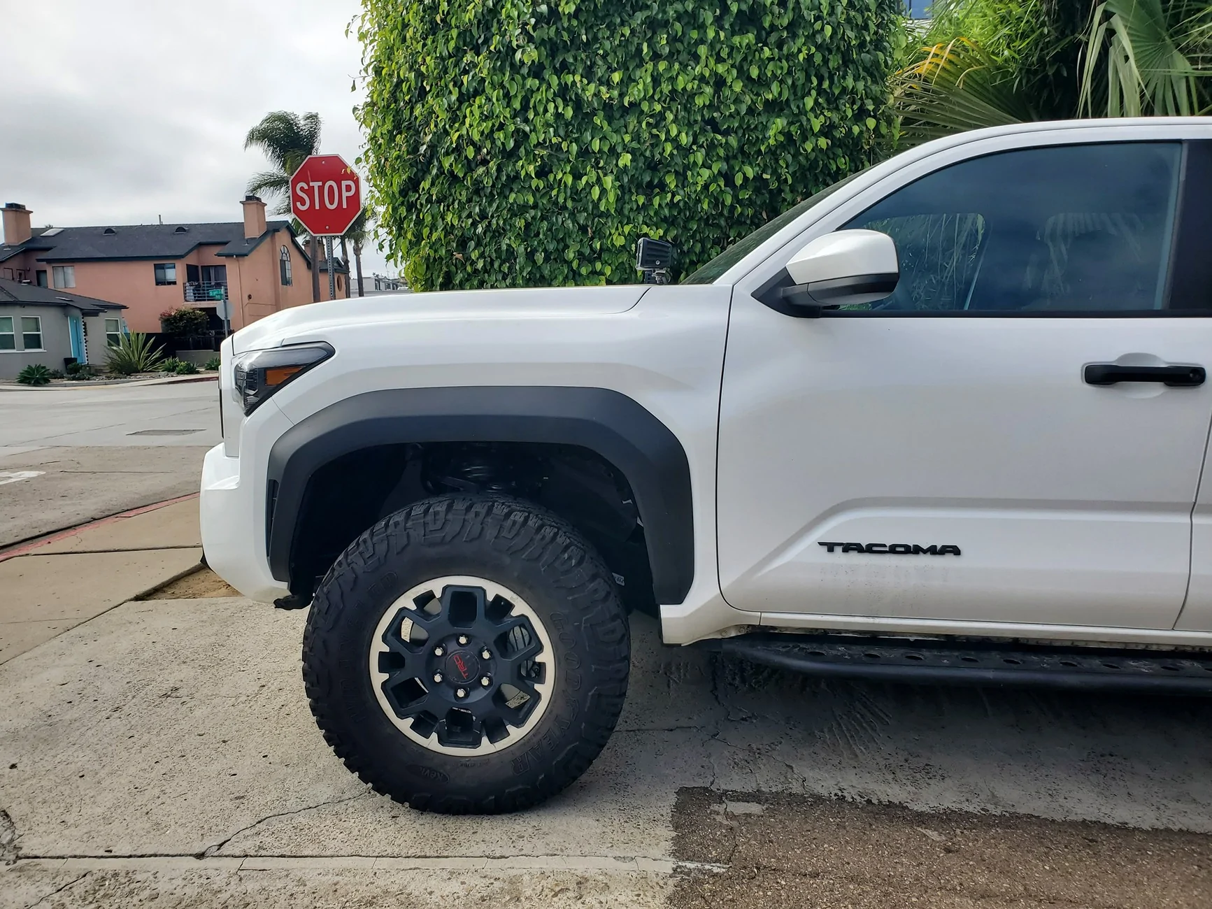

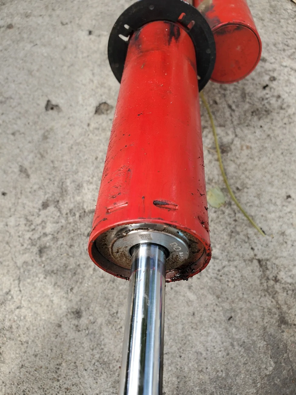

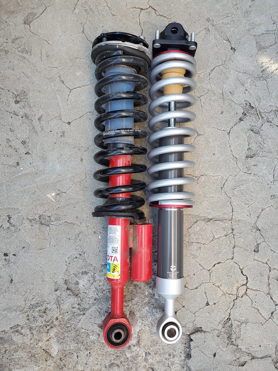

Falcon shocks are in. Off to the alignment shop then a weekend of wheeling. I'll do a full review in a about a month or so once I've used them in different conditions.

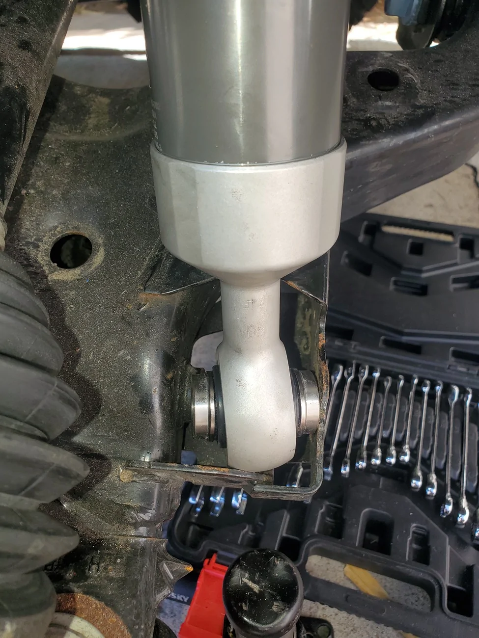

Install would have been pretty straightforward but one of the front shocks was misaligned by a couple degrees. After some back and forth with Falcon (customer service was great), they suggested I bend the lower mount on the truck and twist the lower mount on the shock to force it into place. They said it's very rare, but they have seen it before and requires some elbow grease to get the shock facing the right direction.

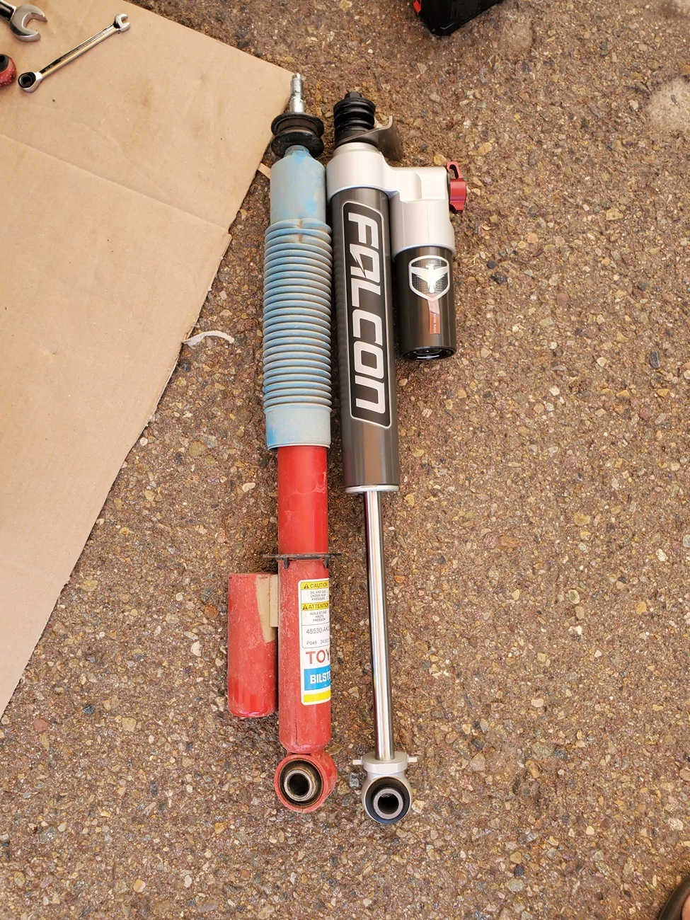

The Falcons are about an inch longer front and rear than the stock Bilsteins. I didn't yet realize where the front strut was going to sit on the upper mount when I took the picture, so it appears shorter in the photo. That's just because the top hat actually sits lower than where I put it in the picture. Falcon says they are 1.2 inches longer front and rear, and that seems to be accurate.
Side note: One of my rear OEM Bilsteins is already leaking oil at 5k miles.
