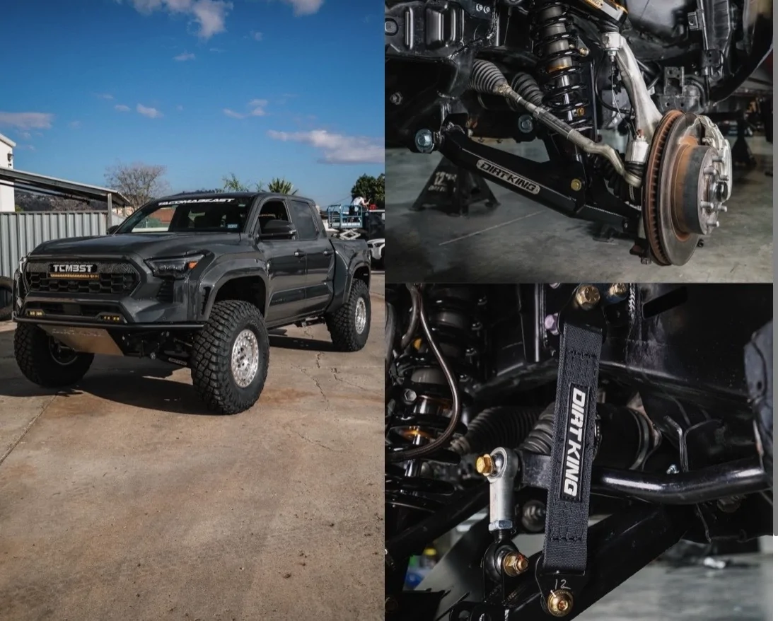

Related: solid overview of shock tuning from TacomaBeast and Dirt King. Not affiliated with either, just an interesting look at how much goes into suspension design and tuning.

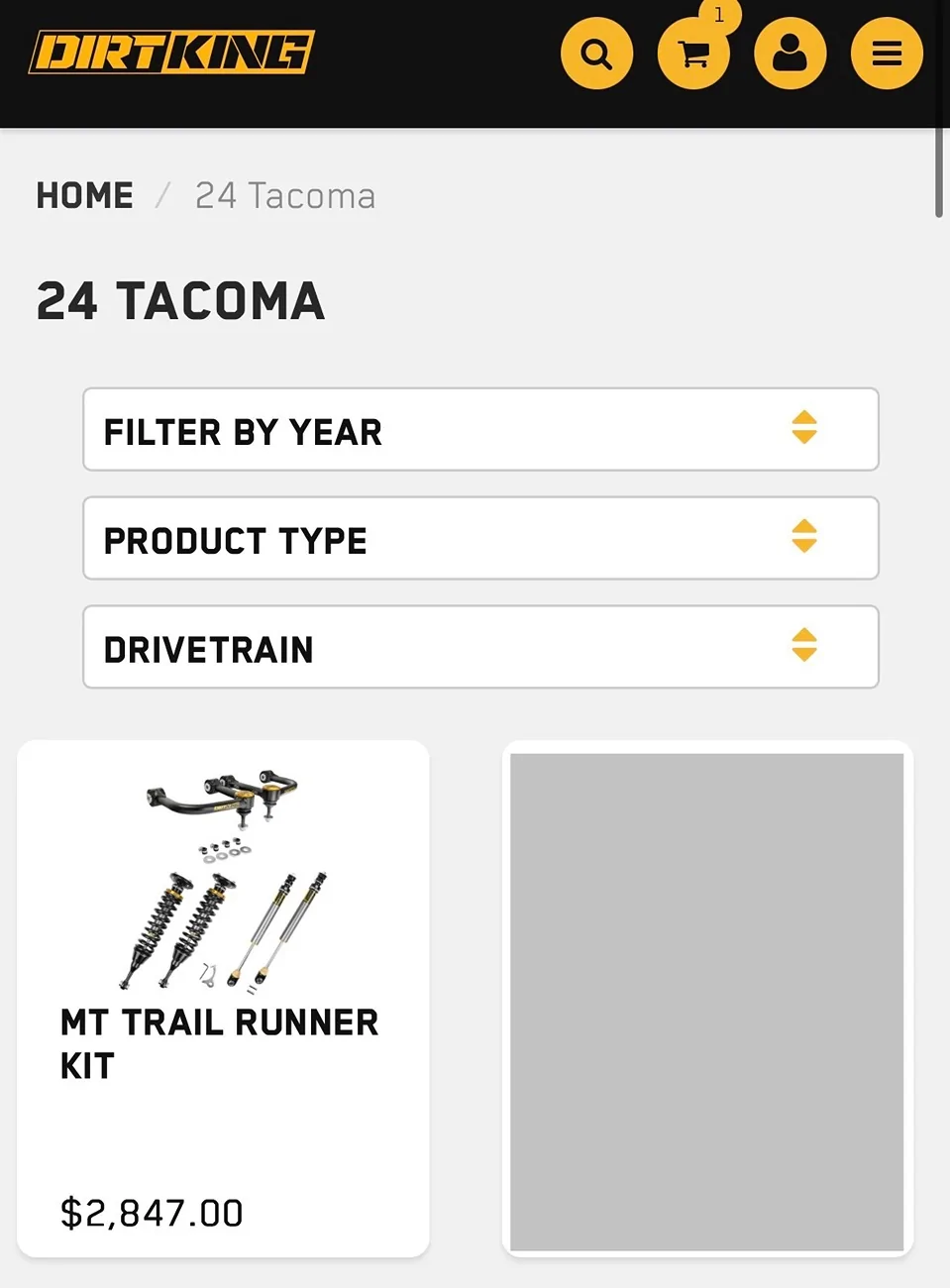

Or any Dirt King kit?
