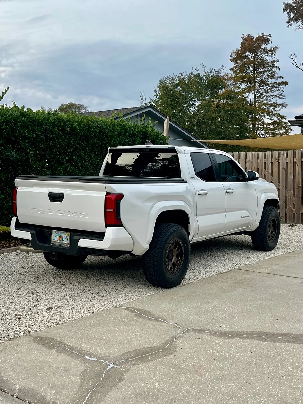

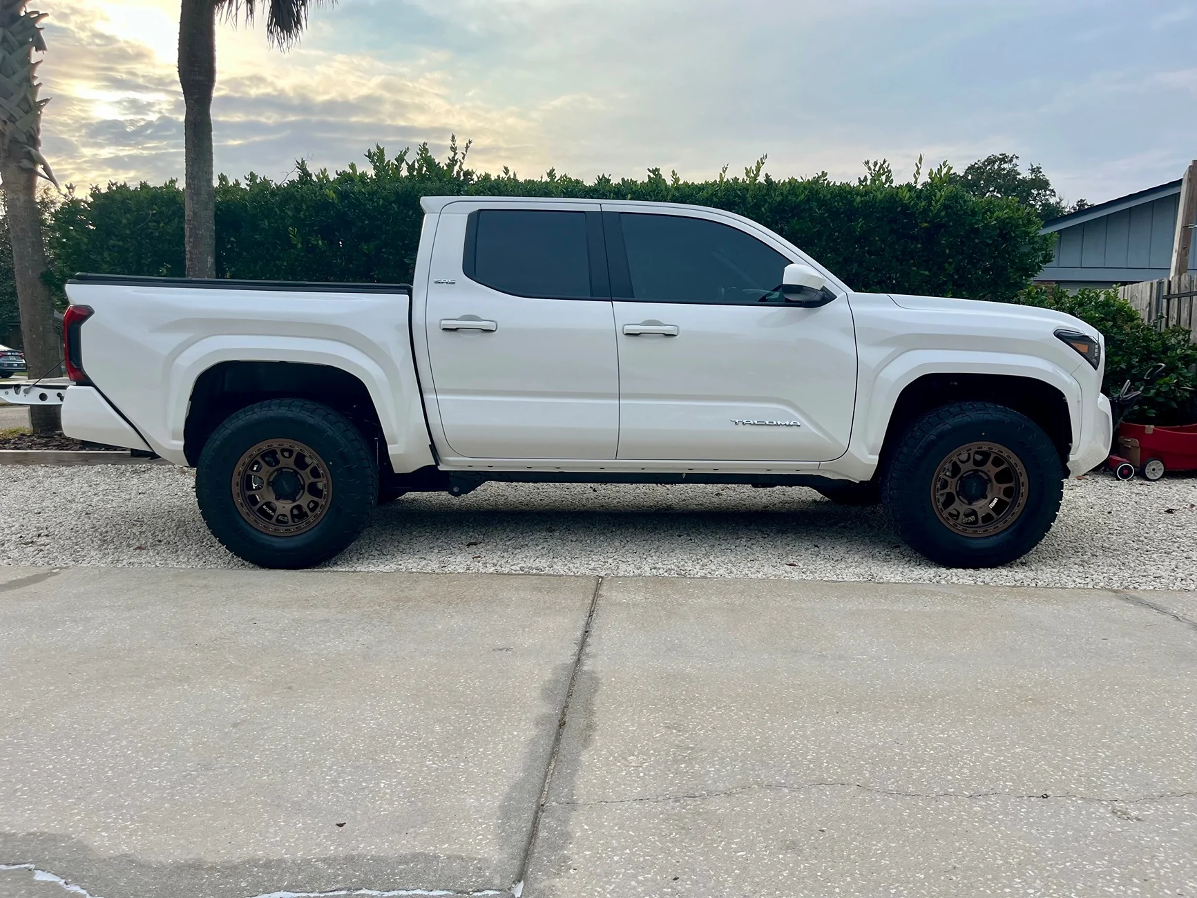

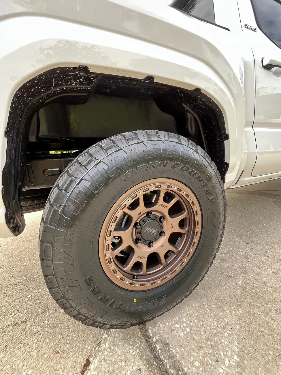

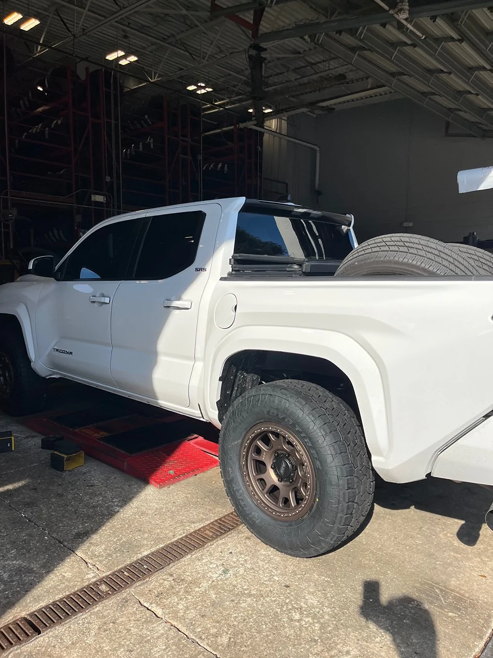

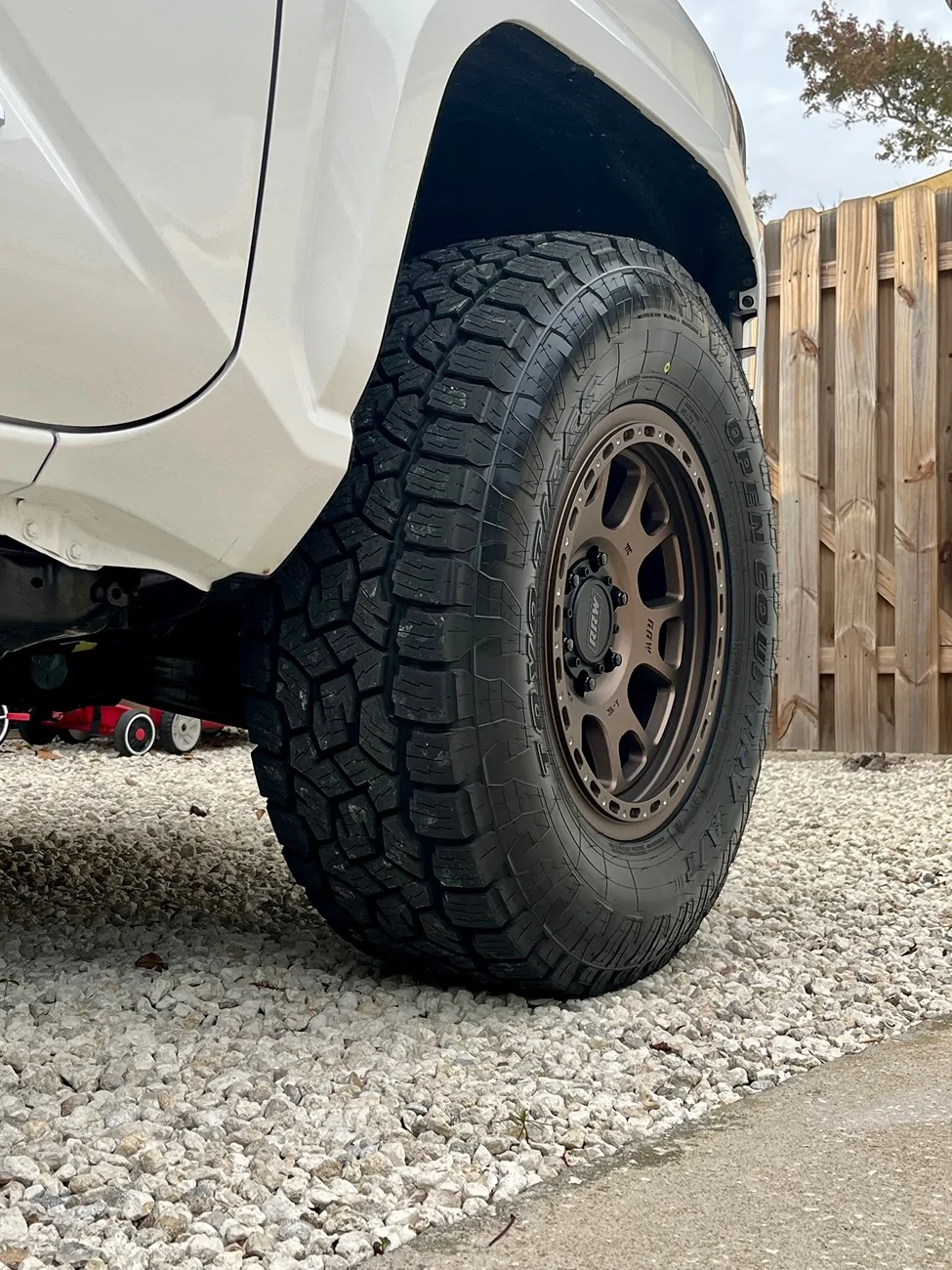

Update for anyone wanting to know:
Ride quality : just as smooth as stock. Maybe a touch stiffer, and a little more hum. Very happy
Performance: Feels a little sluggish but not terrible. I’ve actually noticed the biggest difference in breaking performance. It’s taking me a few days to adjust. Might get the tune next to help pep her back up.
Mileage: *Note, I have a 2 wheel drive that had the 245 Toyo HTs*. Big hit here so far. Down from 22.6 average to 16.5 currently. I reset it when I got the new tire, so hoping this continues to creep up. Was hoping for a couple mile loss, not 6. Would be really happy to see it get back in to the 20s. Happy I went with the Toyos

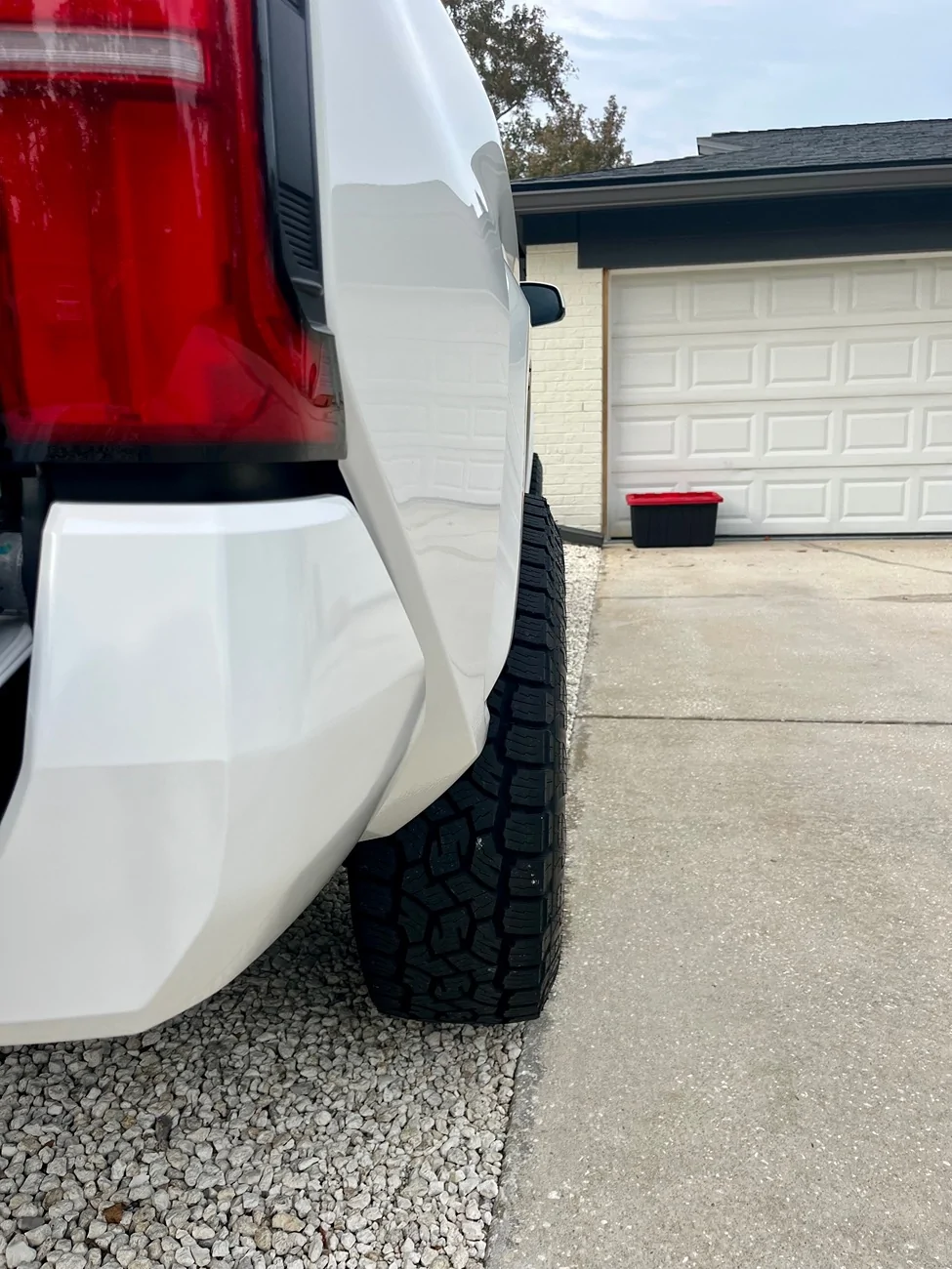

That seems off, especially since going with the AT3's, which are fairly light. Reset the MPG and let the computer calibrate. It should only be like 1-2MPG at most. I'm a big fan of the AT3's for the reasons listed. Very light tires with a great ride and handle snow fairly well. Are the RRW's +25mm offset? Seems like they have more poke than other pics on SR5's I have seen.

Are you factoring in the 7.2% error in your odometer?
If not, that 16.5mpg is actually 17.7mpg.

I just reset it after my OTT tune so we will shall see. Still hanging around 17.5. Kinda can’t keep my foot out of the pedal though haha.
Rims are +18, so a little more poke then all the +25s you see. Just a touch
interesting. I didn’t know that. I’m going to do some real calculations with actual gallons put in vs miles driven.
Use a GPS app to confirm your actual miles travelled, and compare it to your odometer/trip meter. The odometer and speedometer are not linked on these trucks so each one will have different margins of error.
But from what I've seen, the tire diameter difference is usually damn close to the actual difference.

That seems about right. I average like 19ish with 80% city driving and stock tires. That means you probably only dropped 1-2mpg which is on par with what most people state. Not bad honestly.
