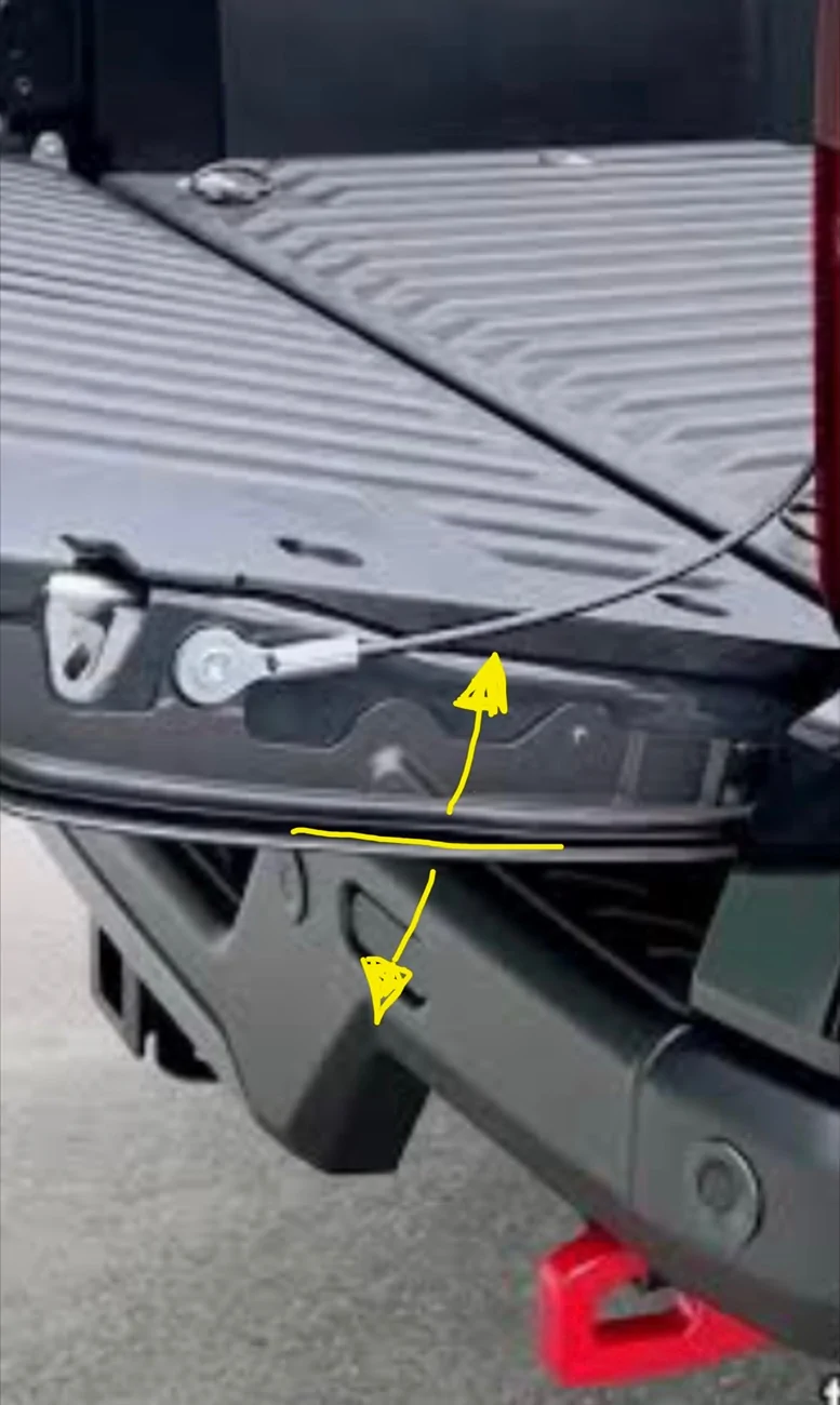

I had this problem when I got my truck.
Try prying away the plastic trim from the metal where it’s marked on the picture below.
I guess that plastic trim is the sensor that detects if the door is closed or if there is obstruction. I had to work mine a couple times, it’s worked fine since.

Thanks for the info, I did get it to work and I did play with the plastic trim and other stuff so I don’t really know what made it work.
