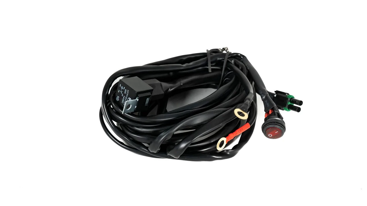

Hey, total wiring noob here. Is wiring for the AUX switches really that simple? My Baja's came with the full wiring harness (Relay, switch, light connections). The videos I have watched lead me to believe I can cut the wiring harness and only leave the light connections with the +- cables. Do these then splice into one connection and connect to the pigtail? I'll add a picture of the harness that came with them. Any feedback/input/tips is greatly appreciated!

You have to make sure that your bajas don’t exceed your aux amperage to determine this. If the amperage draw of both lights is greater than the max amperage of the aux channel you want to use, then you’ll need to install the harness like it comes, retaining the relay but lose the rocker switch and wire the switch leads to the aux output of the truck.

Both lights combined draw 4.4 AMPs so I'm thinking of using the 10 AMP to leave the 5 for a hitch light and the 15 for anything else I want to add. Thanks for the info!

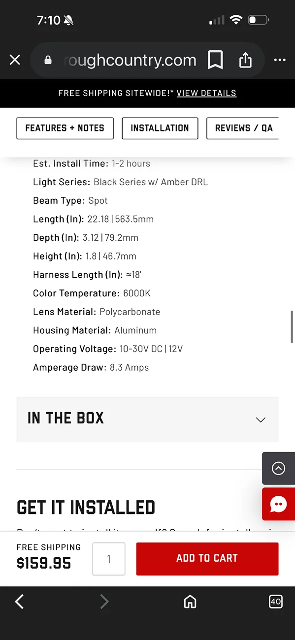

Timely post. I’m in the middle of the grill swap to a Trailhunter grill from Rave Offroad and using a RC 20” light bar. The specs say that it draws 8.3amps, so my plan is to cut the harness and wire it directly to the 10a aux button.

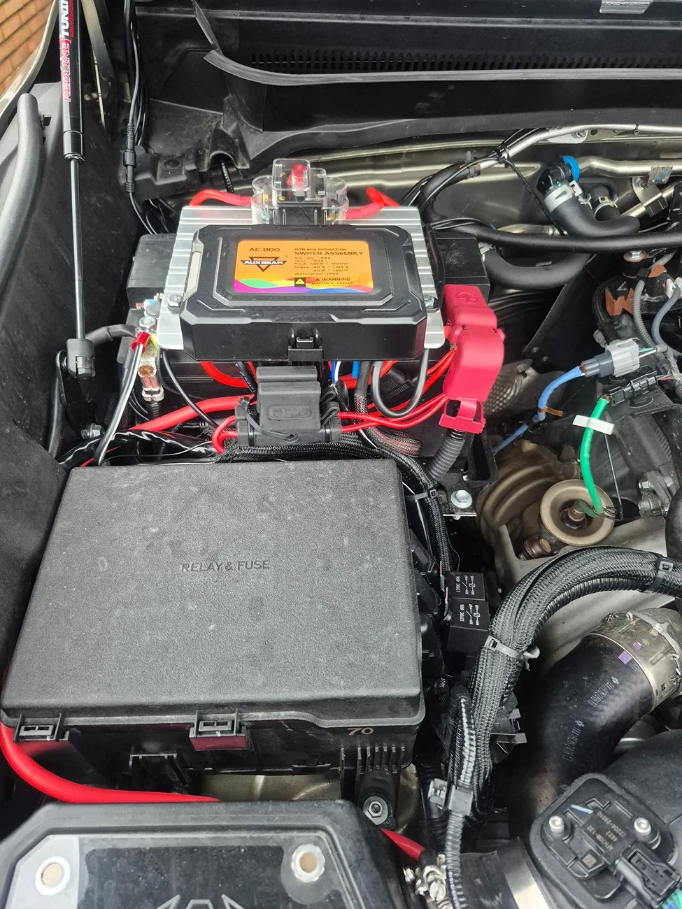

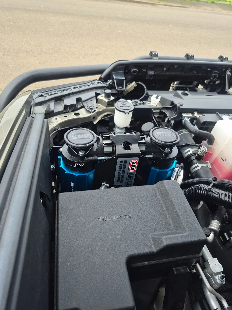

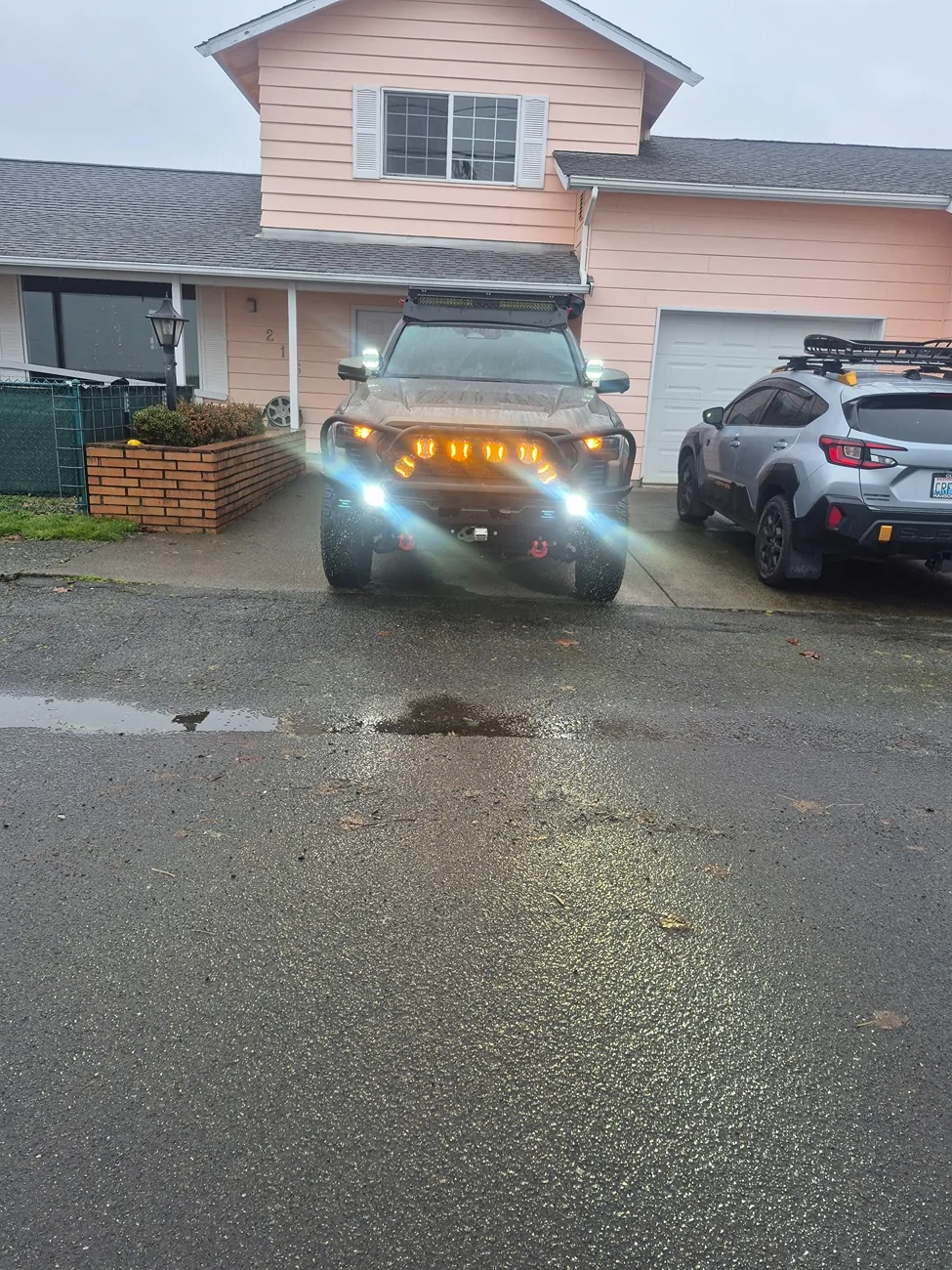

Another great way to wire in accessories is to use a distribution box, like the Auxbeam distribution box that I used. It allows you to wire in your accessories and you end up with a single panel in your truck, so you don't have a bunch of switches.
I have all my lights, air compressor and winch, all run through the distribution box
2024 Tacoma Installing Baja Designs Squadrons - Wiring Harness - Aux Switches 20260101_084506
