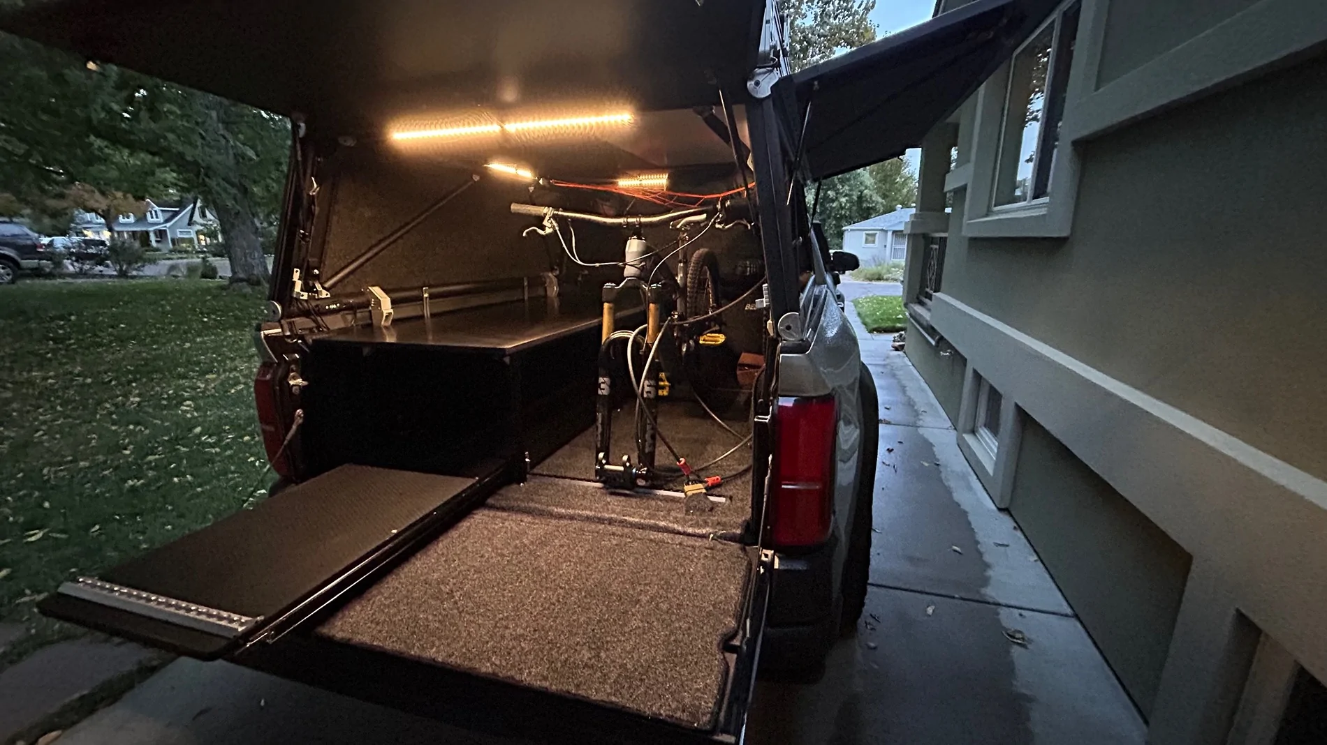

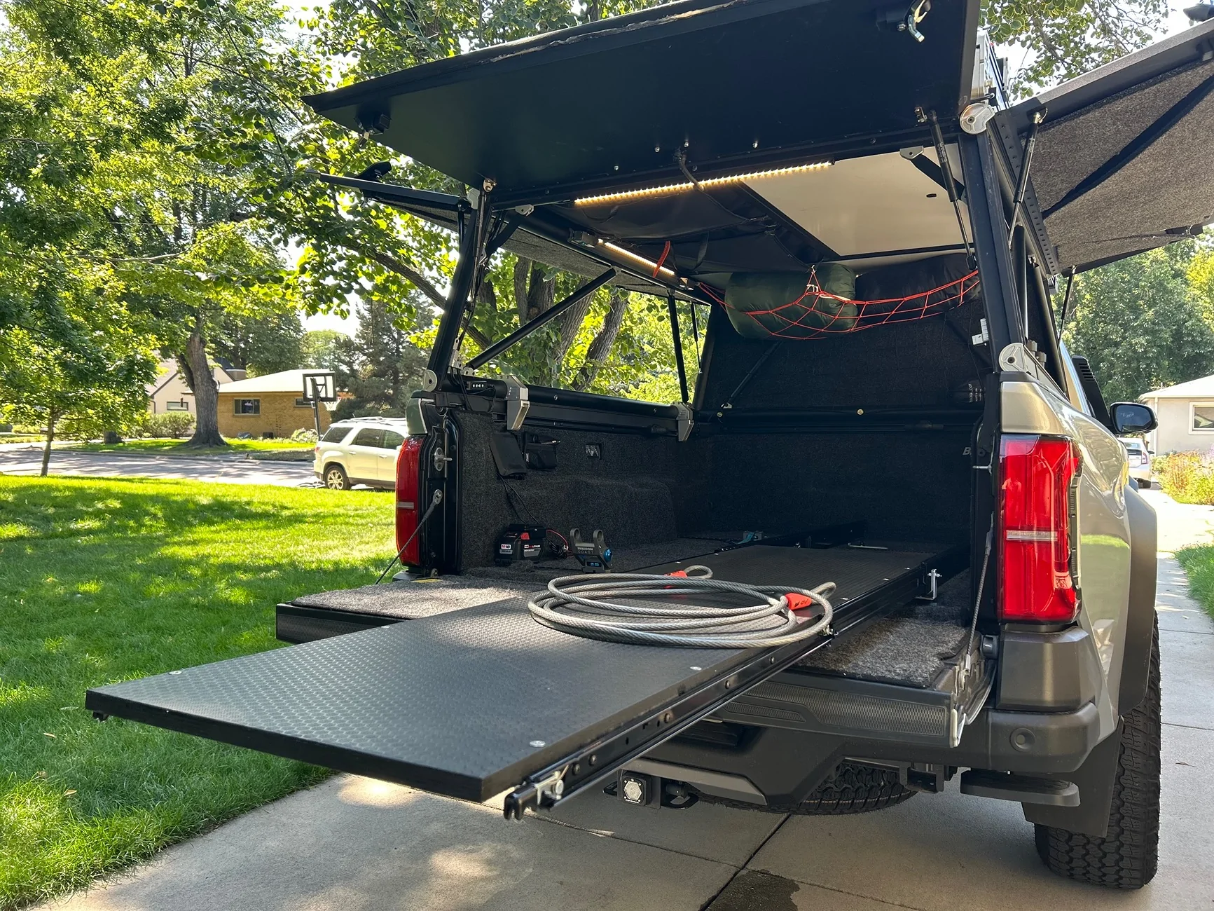

For wiring I dialed in ChatGPT as an electrical guide and it completely aced instructions for splicing in my trailer harness to my 3rd brake light in my GFC, guided a split switch off that GFC aux 1 interior lights to my Baja Designs trailer hitch pod light, it solved all my OE pigtail kit questions. I never phoned a friend, never called a shop or threw in the towel.
Kit is now dialed, I’m no electrician..FWIW
