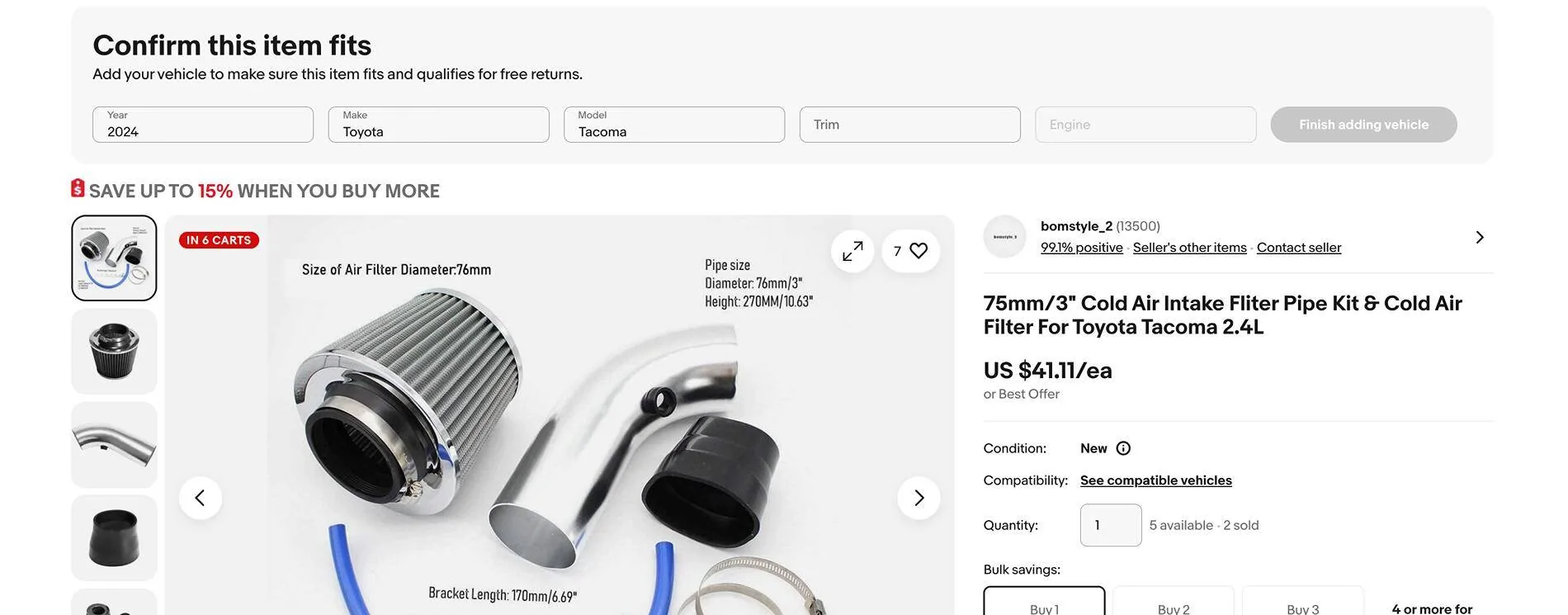

intake for 42 usd?

the other ones from like AFE power,burger motors, s&b or even the k&n look quite a bit similar

The air filter is the only thing stopping dirt, dust, and the outside world from visiting the inside of your engine, one of the most complex and important parts of your vehicle. If it is one thing not to cheap out on it is powertrain components. In fact, not sure I even like cold air intakes; I am waiting on a snorkel / high air intake to be released because for me protection trumps any marginal performance gain or any induction noise gained.

you bought the same one! what about the sensor connector ?

That's not for a 4th Gen Tacoma, it's for a 1st Gen with a 2rz engine.

That doesn't have an air dam and hood gasket to block off engine heat. That is not a cold air intake. It also does not have a fitting for a MAF and I have no idea why there is a hose connection on the pipe. I'd avoid this if I were you.
