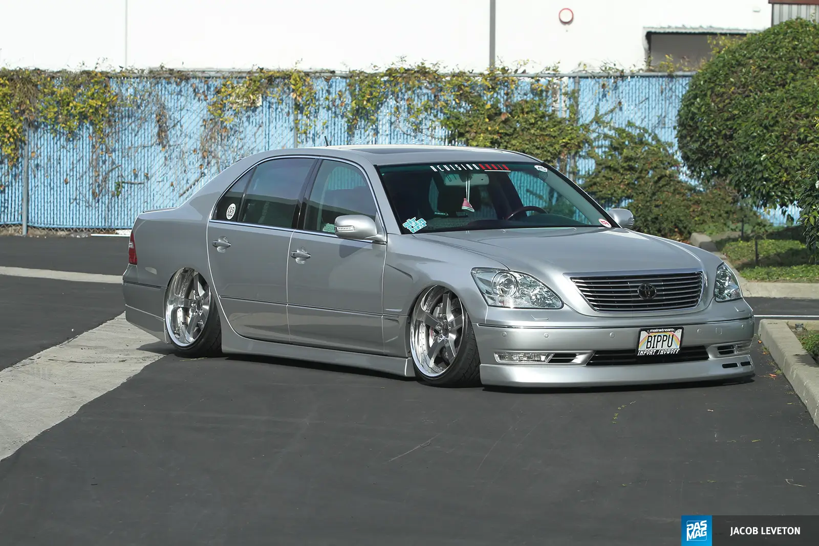

car less than 3500 pounds most of the time, occasionally 4k or less assuming its an ls430 ls460 which i buy alot of. trailer weight is 1222 IB, trailer gvwr is 7k
