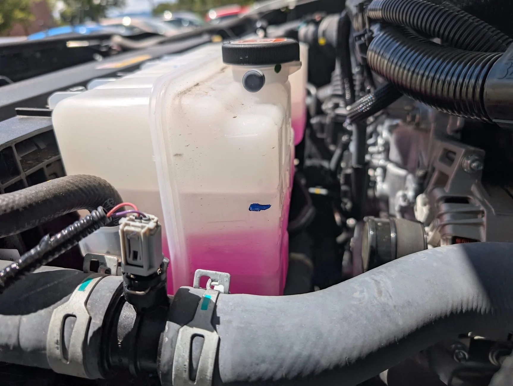

Also, could it be that the air coming out also contains vaporized coolant or something which would be why over time it would get low? Again, I'm no scientist or know crap about any of this, just some common sense thoughts.
This I’m not sure about either, though it does seem plausible on the odor part. I found a photo of someone’s degas tank from Google and took a closer look. Same design as my Frontier had - the “radiator cap” is pressurized and anything it lets past it would go right out the little hose nipple. In this case that is the black breather cap just under the pressure cap.
So maybe the odor is “normal.” As for the level becoming low, I don’t think it ever actually vents coolant itself, so I would assume the level going low over time is either a pinhole leak somewhere or the engine using a bit of it in time.
That's a great shot - illustrates it perfectly. Thanks again. Hope it's all normal and not the start of something....

@BLtheP that's good to know, but on the other hand to say it's been like this for a long time I don't think is the case. My 2016 5th gen 4Runner and several Lexus' (2013 and 2014) in my driveway both have the open to atmosphere vented expansion tank. I'm confident on that as I've topped them off after coolant flush burping.
However, you're right in that I'm looking at my 25 Tacoma right now since you had me curious, and it's designed the same way as my older cars but now they've just moved the pressure valve into the expansion tank cap so everything is pressurized normally. There's a rubber cover just under the tank fill cap with a slot on the bottom presumably for any overpressure release when the air or coolant might go past it, so it's no longer vented to atmosphere. I'd be curious to know if anyone is seeing any residual coolant coming from the plastic cap or tank areas or if it's just an air burping situation where some residual air was trapped from the factory in the system.
