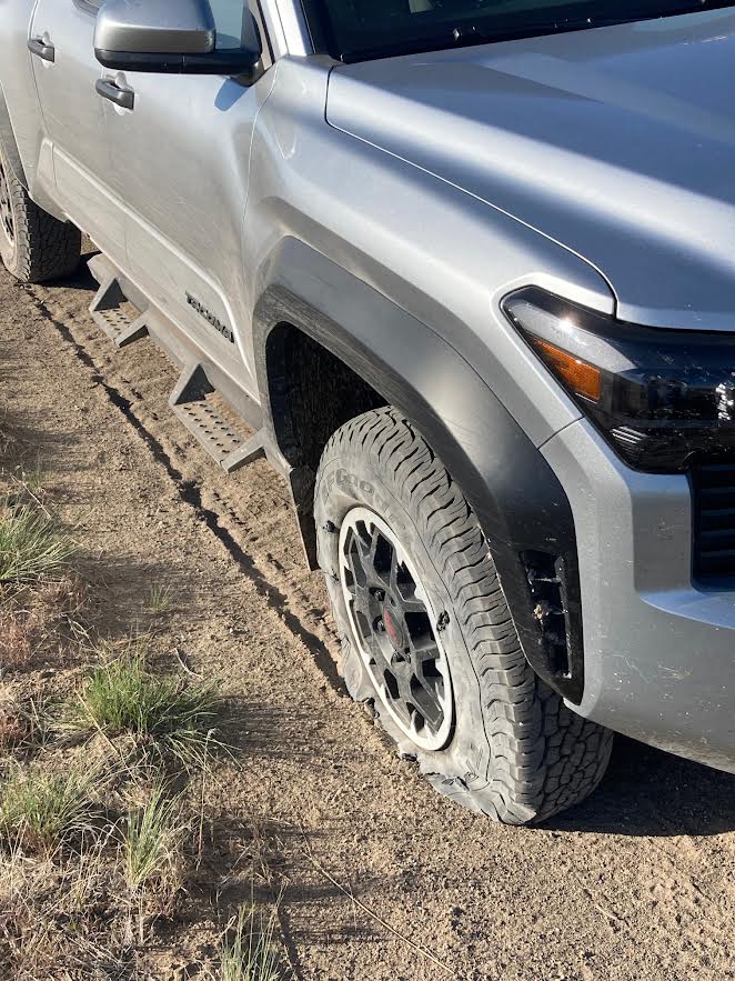

I ran C rated ko2s for 50k miles. The only flat I ever got was a nail straight through bottom. I beat them to shit. Got E rated duractrac RTs for my 4th gen because they don't come in a C and blew a 6 inch gash through the sidewall on my second trip. I've heard Es are supposed to be stronger. idk shit about tire construction, but that's not my experience. My next set will be a load C because I don't think it's worth the extra weight and harsh ride.

Duratrac are known for having very weak sidewalls, regardless of load rating. You found that out the hard way, sadly.
