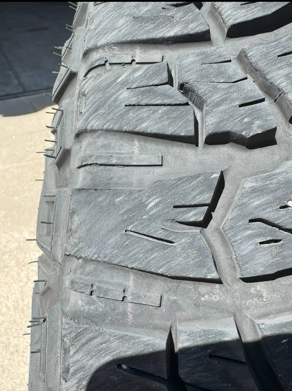

I had the exact same thing start happening to me after installing the Wescott lift collar on the front. I had it done at a reputable off-road shop but I think they used the wrong specs on the alignment. Sadly the shop is trying to blame it on the tires, which are Goodyear Territory MTs. Taking it to dealer this week. Too late for these tires.
Yup. I think a lot of shops are still using old last gen specs for alignments. I did stop by Discount Tires yesterday to get their opinion and they were firmly in the "get it aligned again" camp.

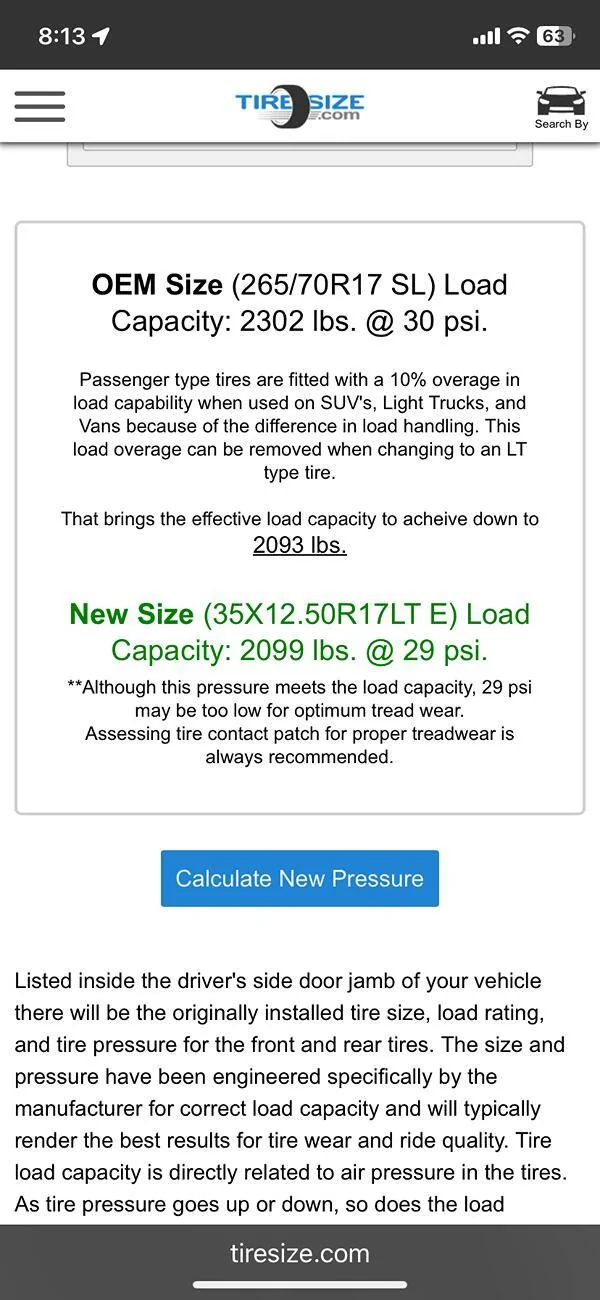

Mine was the same way at 36 psi. Stiff. I went down to 32psi for a better ride. I went to https://tiresize.com/pressure-calculator/ to calculate for a 35” tire from stock size. For future tire replacement. That website says to only run 29 psi. ??? For a 35” tire. Seems low
Required tire pressure to maintain load capacity goes down as tire size goes up. I went from the stock SR alloys to the TRD wheels and thus decreased my PSI from 35 to 30 cold which is exactly what both that website and the door sticker on the TRD OR say for the 265/70/17
I would believe it, 29 psi is a lot for a big tire like that 35

Learning all the time. I didn’t know. So would you run 29psi or something different for the 35s?
I’m going to get new ones soon because the BFGs are driving me crazy with the noise.
Try the chalk test at 29psi, then go from there. I've had tires be noisy from overinflation, especially over bumps or freeway expansion joints (you get the kinda booming balloon noise), decent chance lowering the psi will work.
The volume of air inside the tire is larger so the required pressure to maintain the contact patch shape for the same weight is lower. If I ran the TRD OR wheels at the SR door pressure of 35 I'd be pretty miserable ?

And don't worry too much about how the sidewall looks, radials always bulge unless you've got a stretched or low profile sidewall setup.
