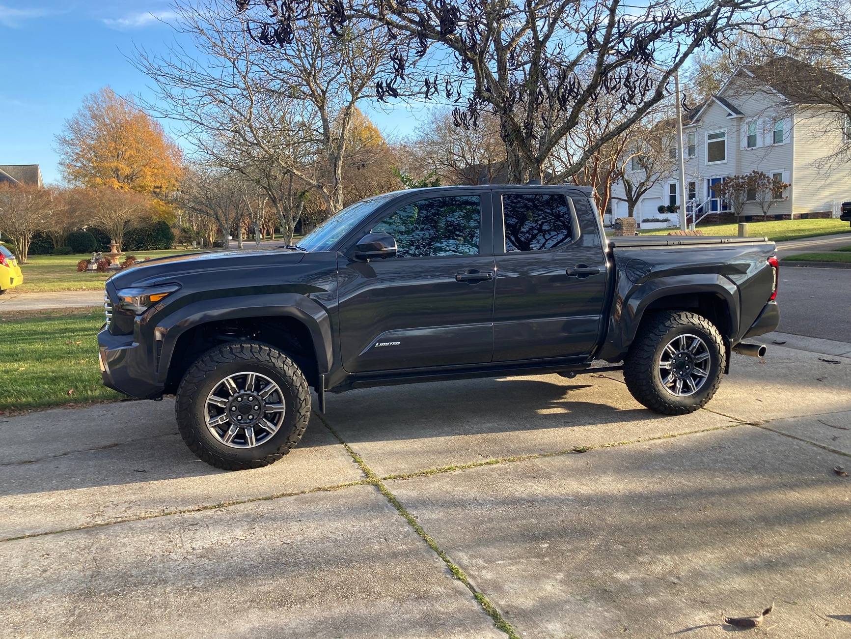

I also have a 2024 Limited. I added a Rough Country 1.5” front leveling kit, 275/70/18 bfg AT’s (32.7”) and custom wheels I had machined to fit. I have a Peak 2.5” waiting to be installed. The tires don’t rub at all with my current setup. The lift is just for a little more height.
2024 Tacoma Loading... IMG_3420
