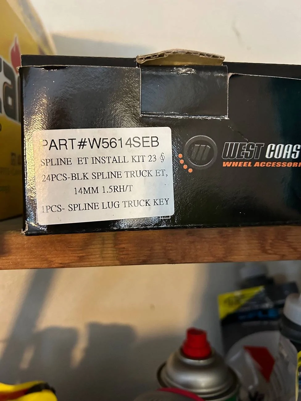

Bump. Looking to order tonight and hoping someone can point me in the right direction

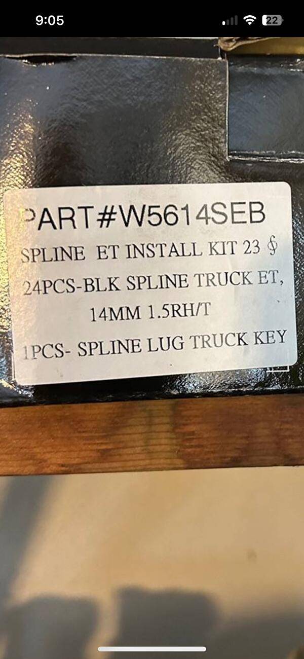

I have method 703 wheels on my truck and ordered the lugs through them. This is what they provided. They provide 11 thread contact.
Can’t help with TPMS as I used the OEM from the truck.

Can you elaborate?
The tacoma technically requires Extended thread or ET Lug nuts. These are extended thread but the wrong kind. These are just longer lug nuts. The tacoma requires lug nuts that have a thread that extend inside of the wheel because of how little thread engagement there is.

From initial thread engagement the subject lug nuts provide 11 full rotations of thread contact before seating in the wheel. The profile is the same as your example.

I’m seeing ET referenced all over the subject lug nuts provide packaging:
2024 Tacoma Loading... IMG_7201

I see it says ET, but google searching that part number shows a lug that is not the normal extended thread.
