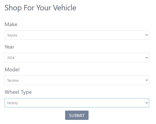

If you do end up buying a set of Advanced Wheel Locks (https://advancedlocks.com/shop)
They'd ask you to fill out a form so they can match you with the right set of locks for your truck. But their website isn't up-to-date (so to speak) so if you have a 2025 model, the "Tacoma" isn't listed as one of the options. Which means you'd have to choose the 2024 model in order to select "Tacoma".
2024 Tacoma Loading... ScreenHunter 34

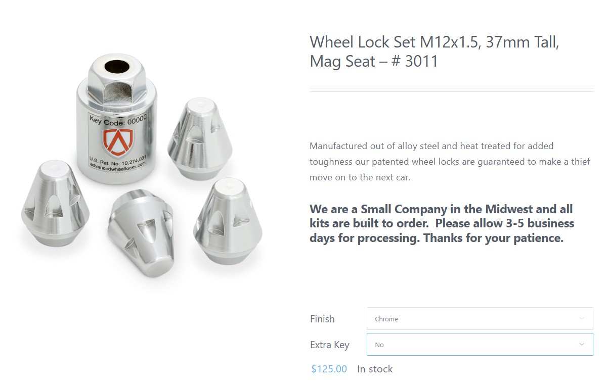

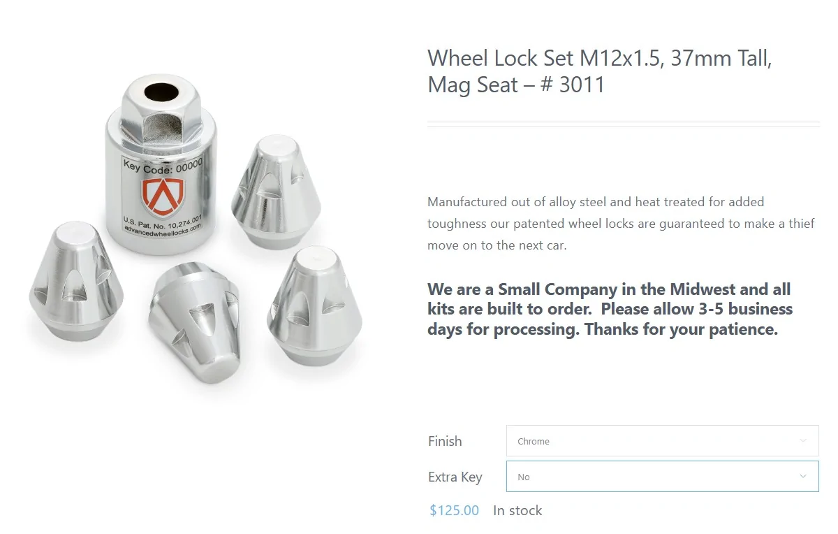

Once that's done, it would take you to this page.
2024 Tacoma Loading... ScreenHunter 35
If you end up getting a set of M12X1.5, 37mm Tall, Mag Seat #3011 (as shown above) it WILL NOT FIT your truck. Even though their computer says it will. I bought a set of these back in June and when I took them to Discount Tire to install them. They would not fit b/c it's too SMALL.
Luckily their customer service was awesome and they were able to take these back (with prepaid shipping) and send me the right set of Advanced Wheel Locks in black (to match my PRO). NOTE: 4G Tacoma takes M14x1.5. @Andrace
It's been two months, I thought they'd get their site fixed by now...guess not.
