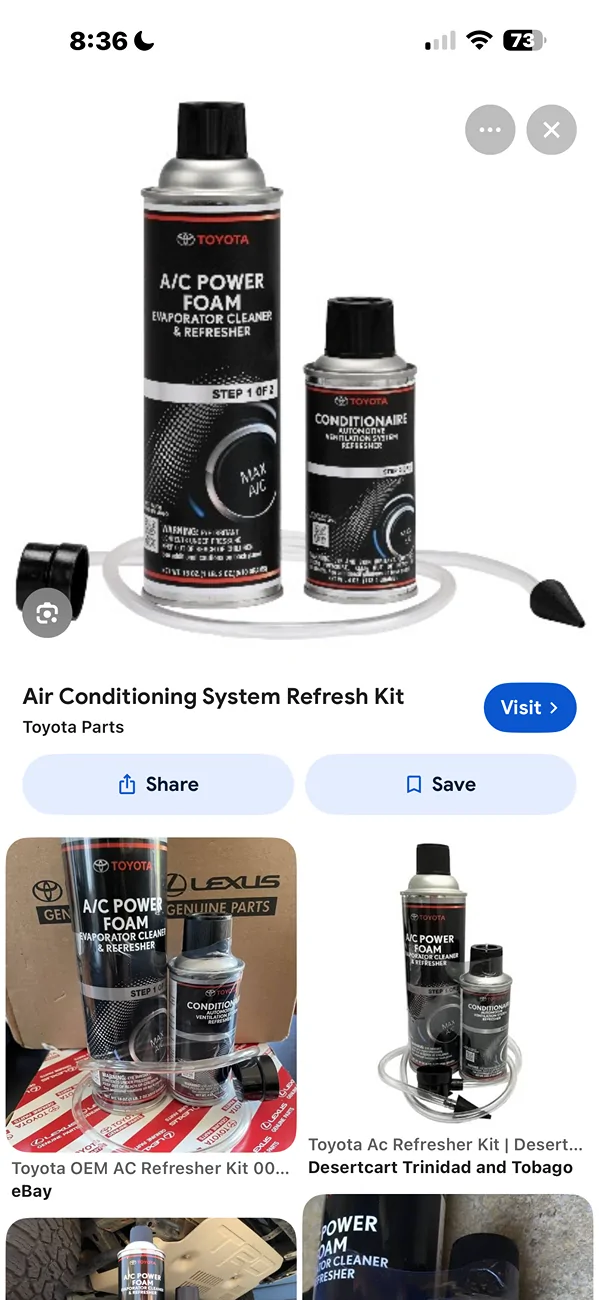

Car Care Nut (YouTube) Highly Recommends this kit. Air Conditioning System Refresh Kit

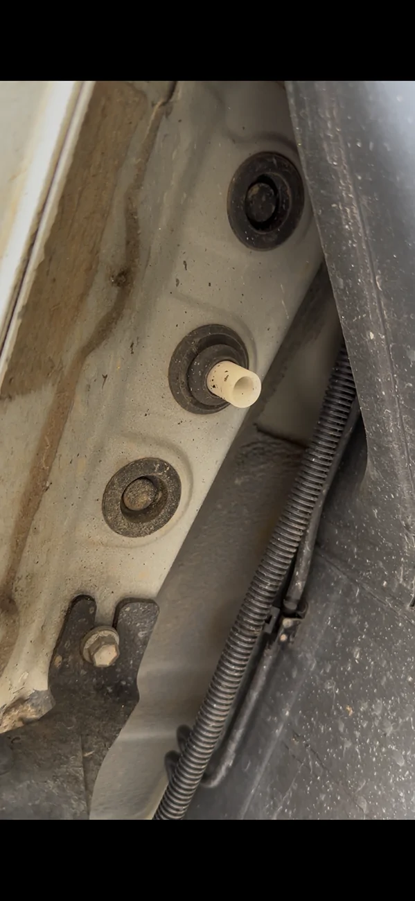

Nice. I had seen that video in the past but wasn't sure if that little tube was the same one in the 4th gen. Looks like that's not a 4th gen but i'm thinking that little tube is in a similar location.
