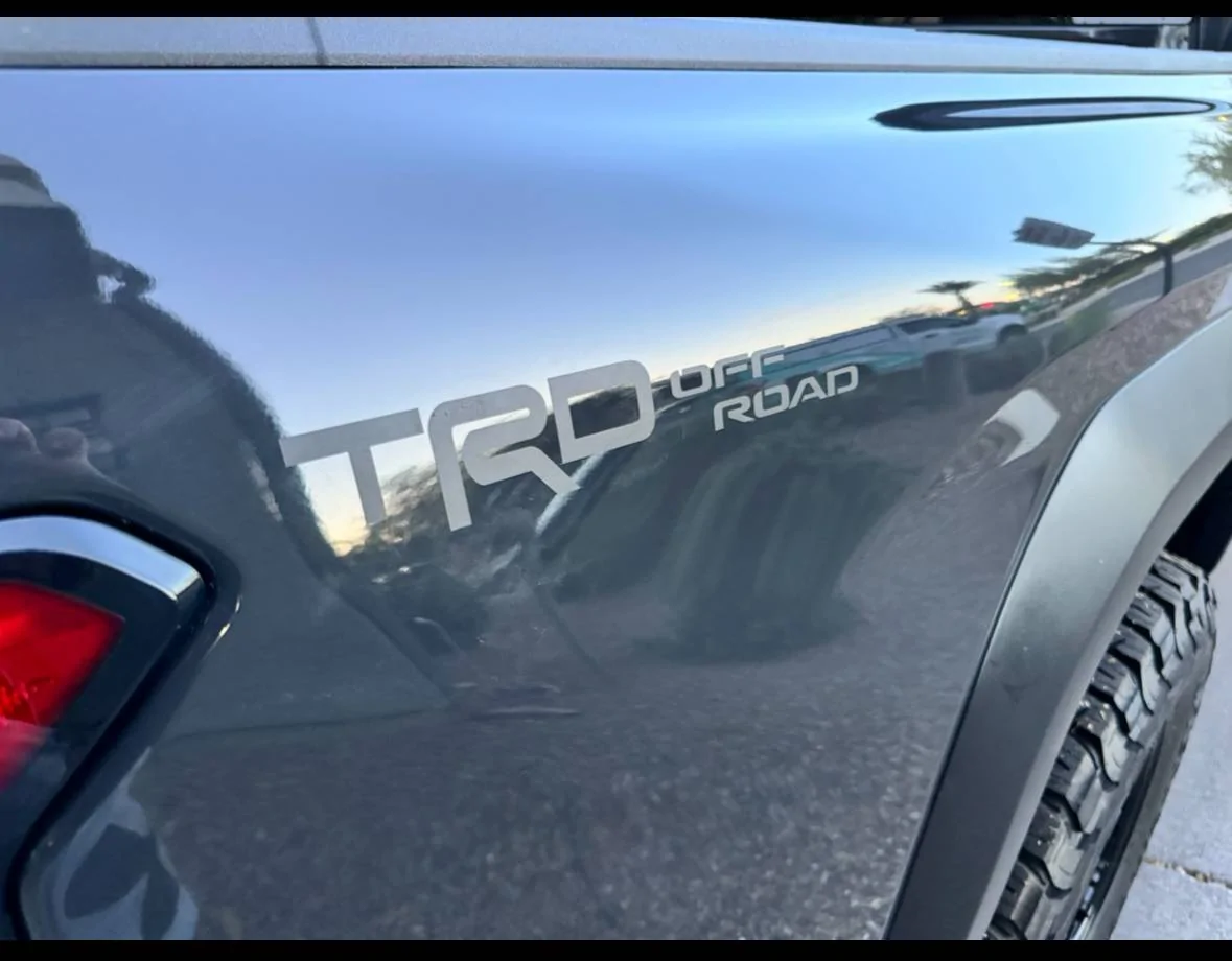

Can't decide if I want to delete the OR stickers or not. Leaning toward delete.
Same, I've been trying to make up my mind if I want to get rid of them or not... I just don't like stickers on my car and here in the AZ desert the sun just wrecks stickers/decals.

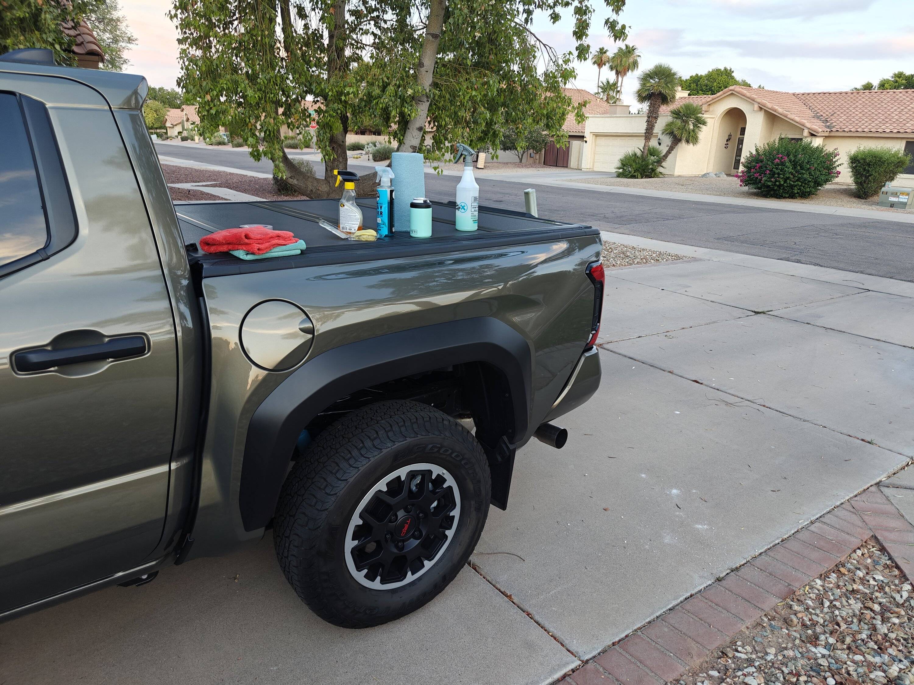

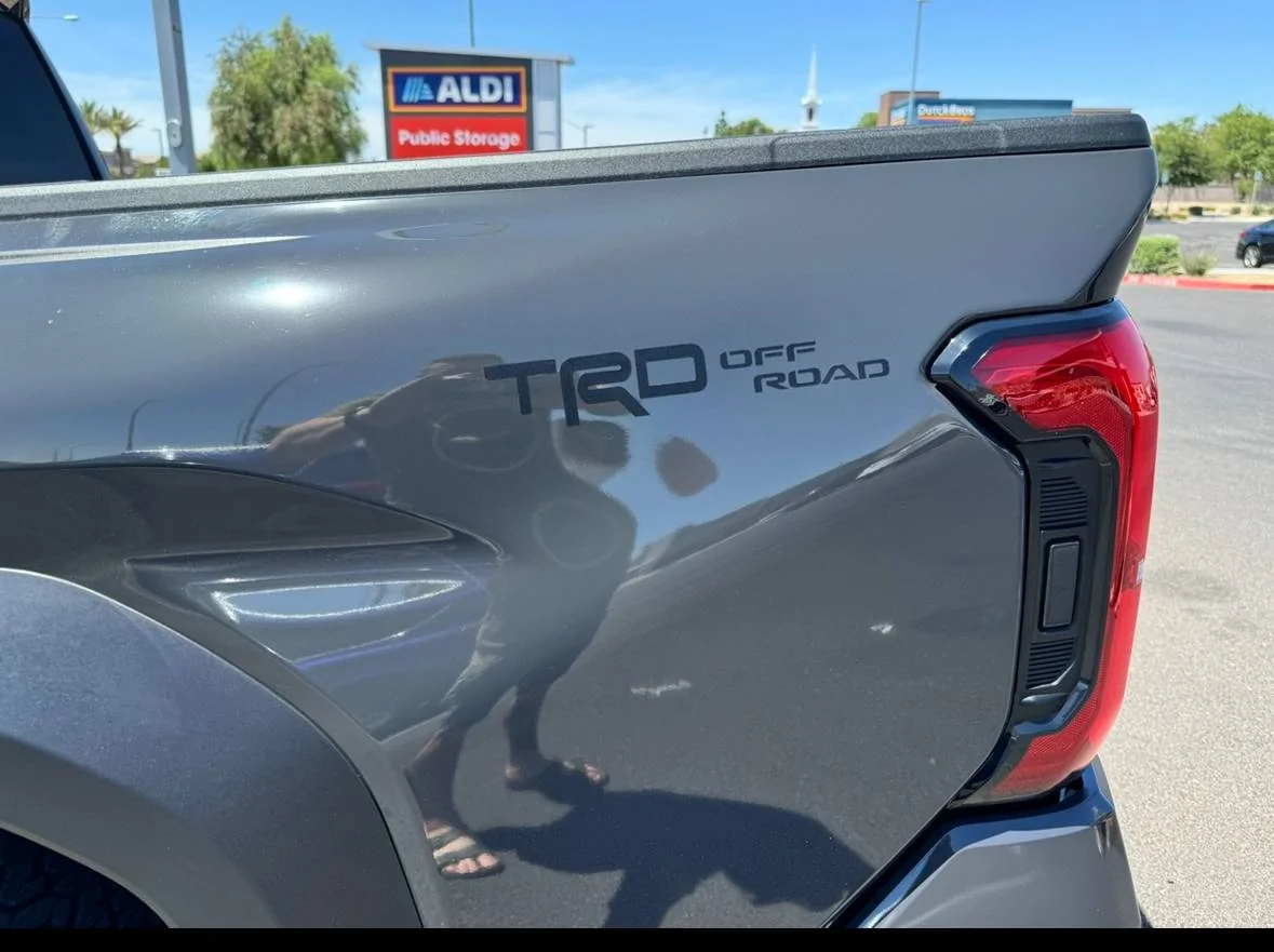

So I have successfully removed one of them (driver side) and it took about 2 hours of work. I live in Phoenix, and left it in the sun for about 30 minutes to allow the panel to get really hot before I started. I continually used goo gone on the decal and used nothing but my fingernails to get it off. the majority of the decal came off in two parts, the first layer came off mostly in one piece while the underlying layer had to be scraped off every step of the way. Once I got the majority of it, I then had to refresh the goo gone, then cleaned off, then used clay bar, then more goo gone and another clay bar... There are some scratches from my nails if you're really looking, once I get the other side removed I'll polish both sides. I plan to get a rubber razor for the other side as both of my thumbs are quite sore from just the one side and the whole purpose of using my nails was to avoid scratching the clear coat.
