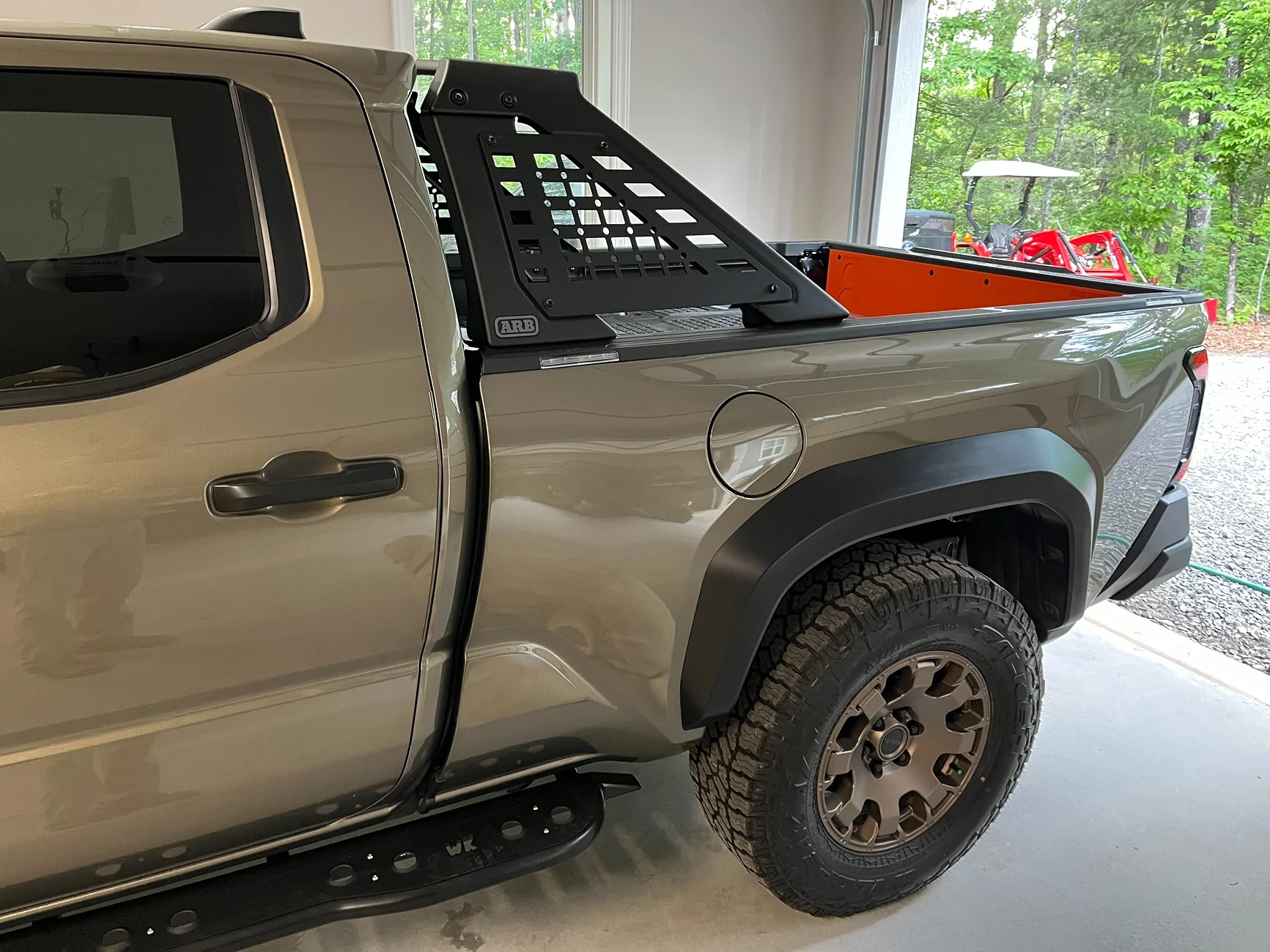

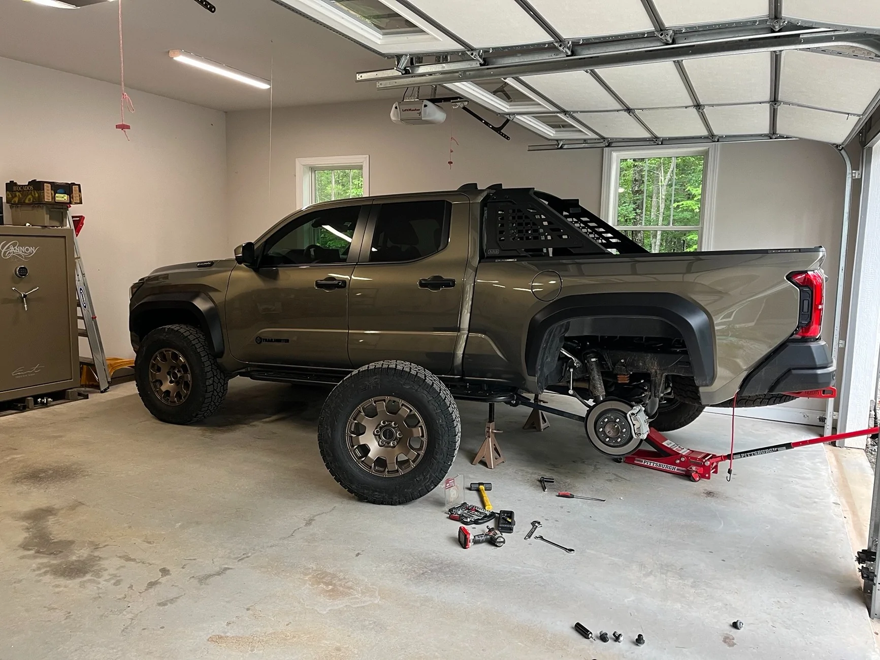

I tried an unconventional route. My 25 TH had lost some rear height after adding White Knuckle Sliders and a Decked system in the bed with constant load items inside. I installed a pair of rear coil springs from a new Toyota Tundra Crew Cab 4x4 Limited that my friend had just removed. The idea being that the Tundra had a little bit more weight and payload capacity. The springs fit perfect, gave me two inches of lift and less squirm and roll in the rear. For me it's been great.
Did you replace your rear shocks with BP51's like @rchrds did ? Or did you just stretch out the OEM shocks ?

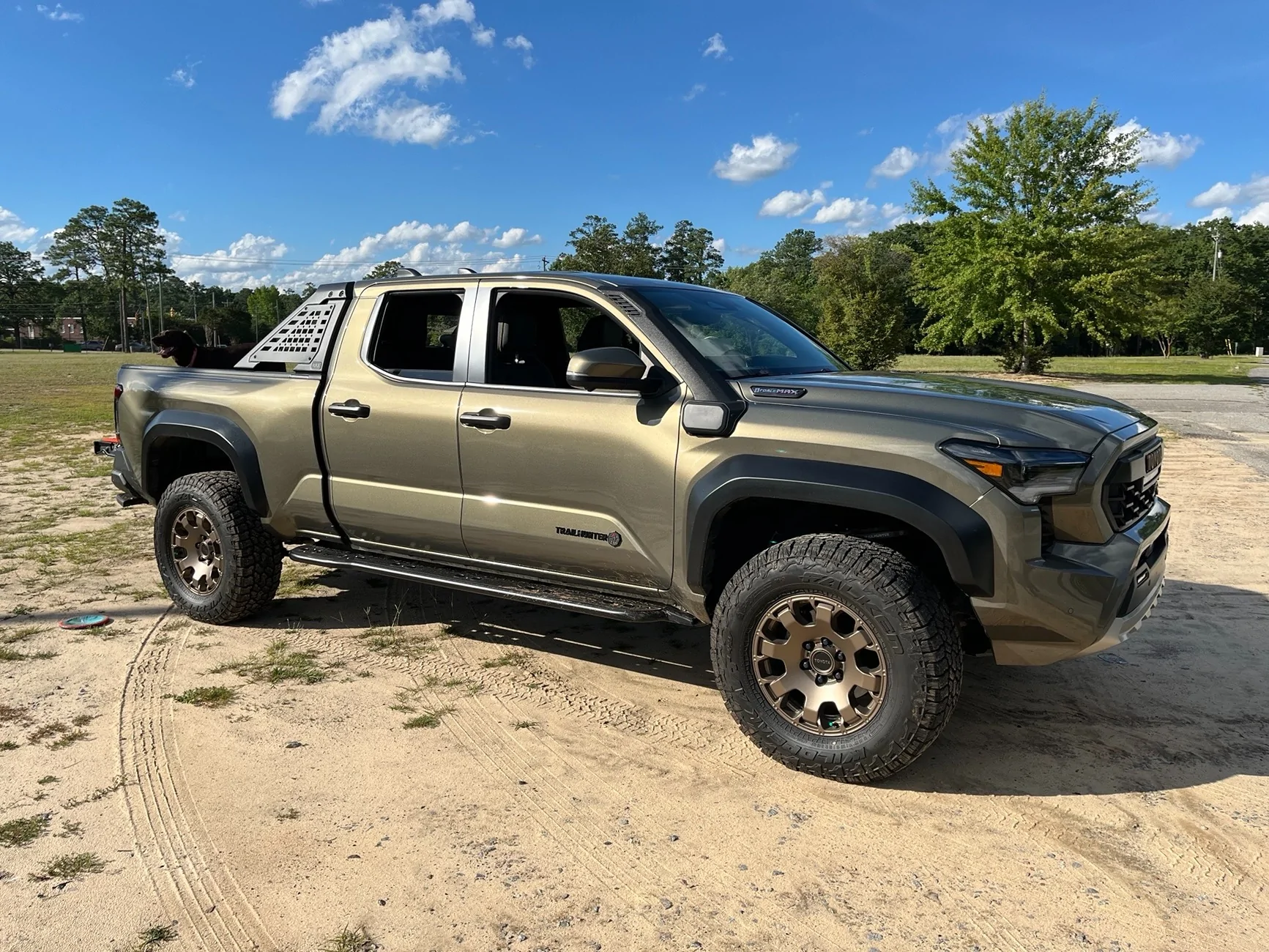

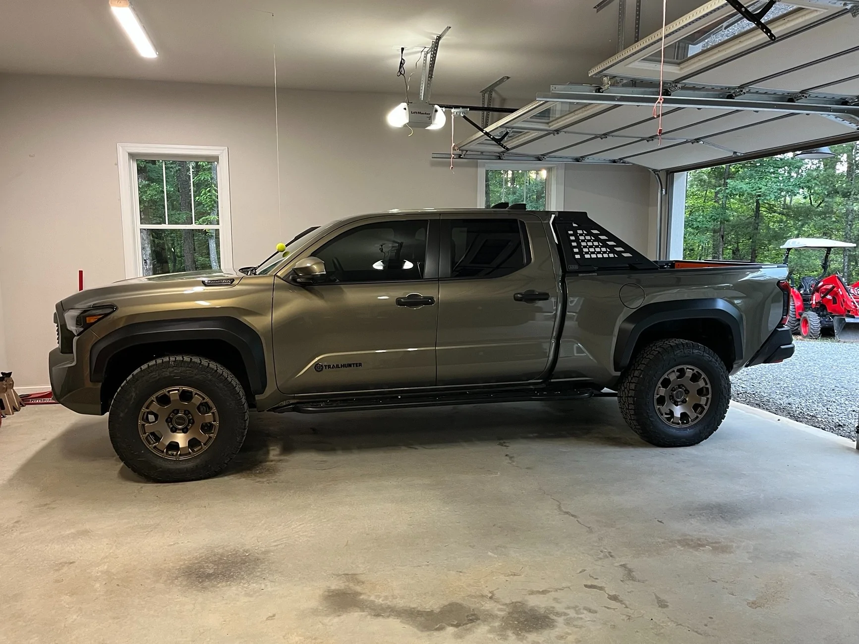

I know the angle is different but this picture below in my garage is of the rear suspension sag on my TH before the Tundra spring upgrade. In my post above you can see much more gap in the rear wheel well.
The pic below in the sand is how it rides today.
How much weight is that?
I kept the stock shocks. They have adequate travel for the new coils.
6 foot decked system weighs 206 lbs. I probably have over 100 lbs. of gear in the drawer and the sliders weigh more than stock. Let's say 350-400 lbs. static increase.

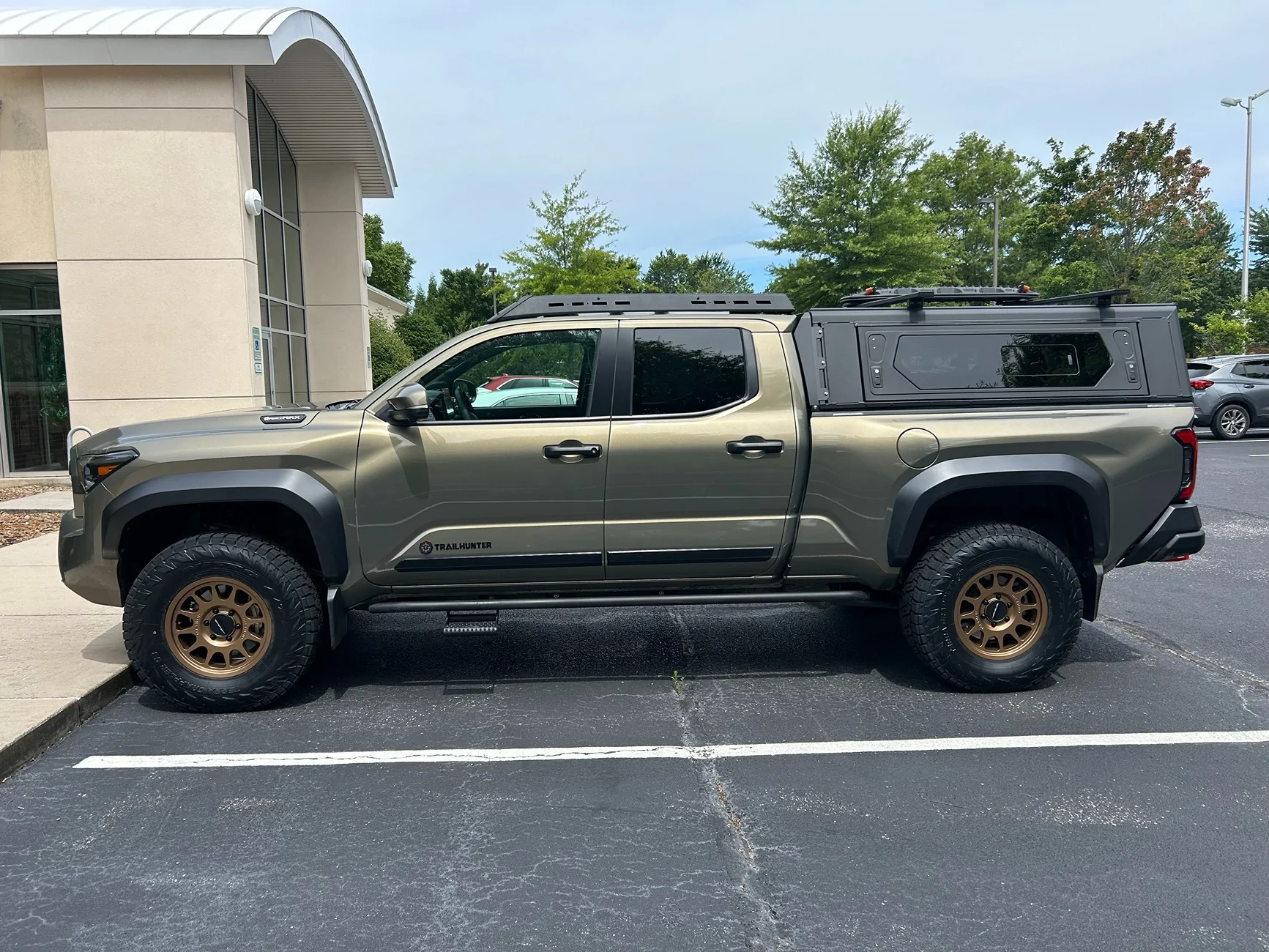

My Trailhunter LB sagged at least 1 1/4" of new in the rear after loaded with gear for vacation. This was enough that I think I bottomed out a time or two on the Canyonlands White Rim trail. I installed Dobinsons 822s in the front and 821v in the rear. That resulted in a center of hub to fender height of 24-24.5" in the front and roughly 25.75" in the rear with about 300 lbs in the rear.
The picture below was take with the OEM wheels and tires in the back as well for a total weight of 400-500 lbs. These springs have only seen 1000 miles and none of it fully loaded for cross country travel so they may settle further.
So your standard load is +300lb? How would you say the day-to-day ride has changed with that setup?

I estimate that it is close to 300 lb over stock with the Alucab canopy, Maxtrax, Hi Lift jack, bed molle panels, 3 gal Rotopax, OEM bed mat, Mountain Hatch tailgate table, and some recovery gear, etc. that resides in the back. I never measured the rear height when the truck was new but I did measure a short bed on the dealer lot at 24". At that point I was down to 22.75" or less.
I can't say that I saw a big difference in ride quality especially on road after the spring install. It may be a bit stiffer which I expected. My objective was to retain the height when I am fully loaded with gear plus have an additional 5-8 gallons of gas, plus water and cooler near the tailgate.
