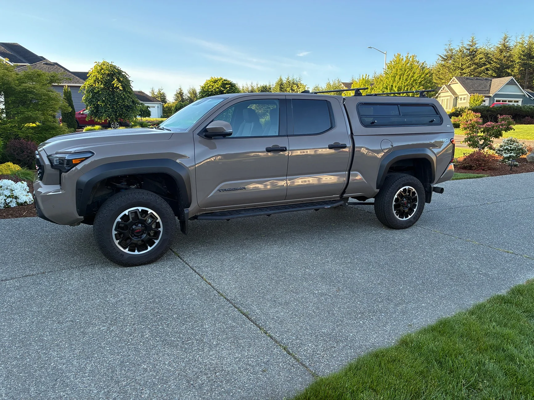

So heres my scenario; i have a trailhunter. I use it as my daily. I have a smartcap and some standard gear in the back that probably adds up to say 280lb permanent load.
This is probably fine, the ride does sometimes feel overly squishy but i honestly dont know if its related or not, but when i go camping and load up the back with cooler, water, wood etc etc if really squats a lot. Ive read a little bit and it seems like what might benefit me is a pair of Dobinsons. In particular, im looking for something that can help with the weight (maybe not entirely solve it, but helps), while not impacting my daily too much, so im thinking of adding Dobinsons C59-819V to the back.
I would like to hear from folks in a similar scenario as mine that did this, if they like the setup or if they would do it differently. Also just general advice around the 819 vs others for my setup, and also whether i need something in the front as well. Its mostly my back that squats obviously, but i see from others a lot of folks also replace the front, and im not actually too sure why tbh.
Thanks guys.

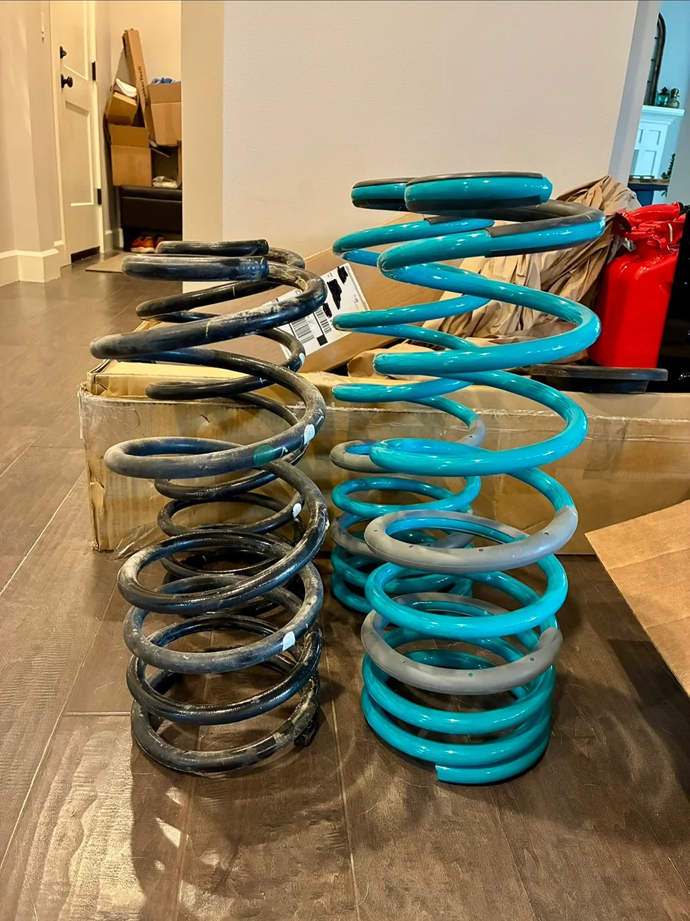

Go for it! I added the 819s to my Off Road and am a fan. Got about 2.5 inches of lift on my truck. I came from full sized trucks and did a 6500 lb tow with a trailer and was basically riding on the bump stops. Not any more with the 819s. Not too difficult an install either as long as you have a little patience with the process.
