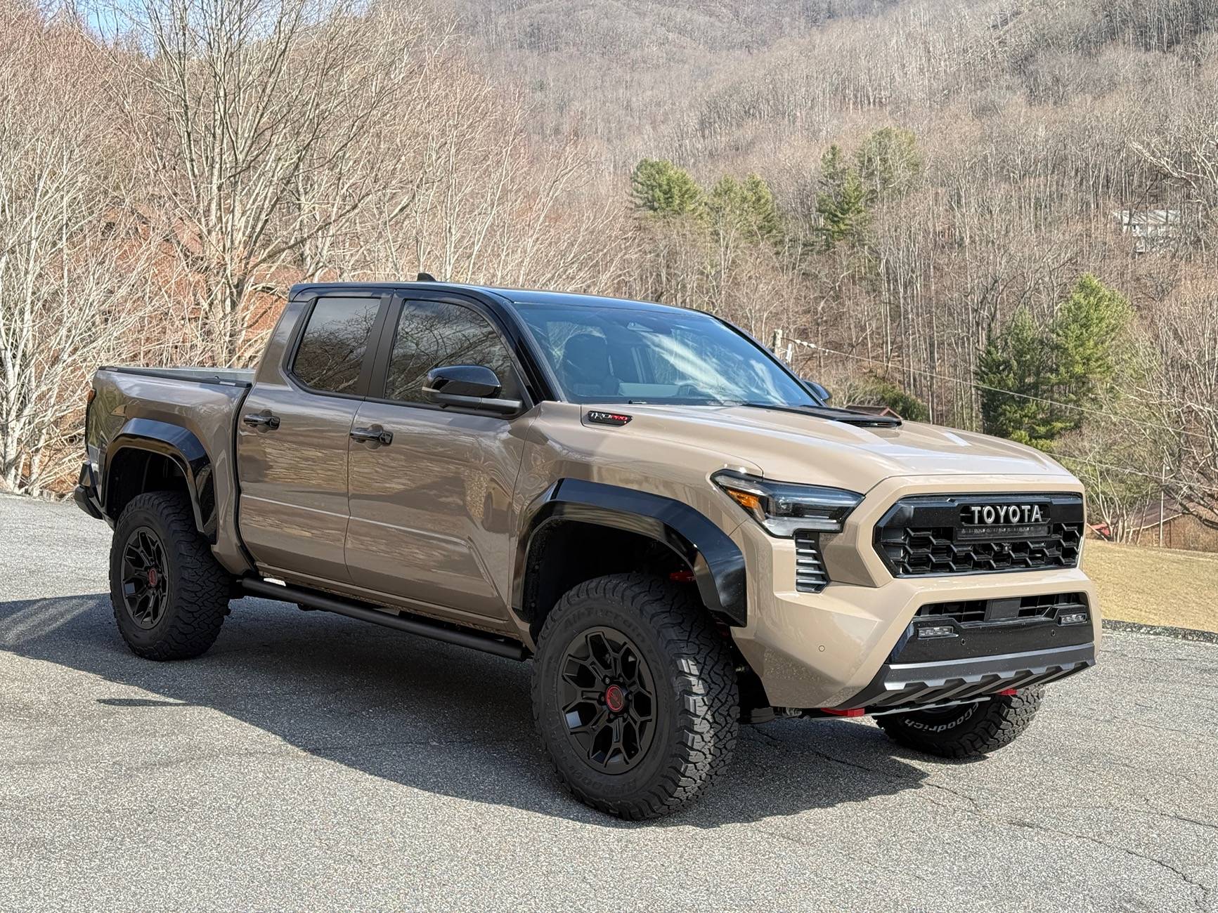

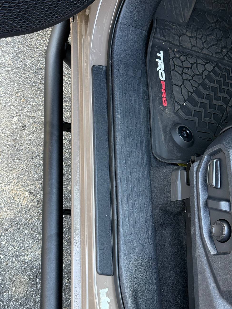

I’d like to follow up on a few things the OP said, as well as thank him for this write up. I picked up a set of these from my dealer today and at that price. These are NOT flimsy aluminum like the sill finisher that came on my TRD Pro or the Predator side steps Toyota is so fond of. These are high quality steel and heavy. The welds and slightly textured finish are outstanding.
installation was super easy and doable by one person. The rear can hang exactly as the OP said, but you do have to prop the front up on something to soften the angle. As would be expected from a Toyota OEM part, everything lined up perfectly. Even removing the sill finishers first, I was able to complete the installation in about an hour. The required hardware came with each rail.
They probably wouldn’t work as step for older people, but if you’re fairly fit and agile, they’re really okay steps. I’m 5’7” with a size 10 shoe. If I put my foot closer to parallel with the rail, they work great as a step for me, and they really help me reduce seat bolster wear as I get in and out.
Toyota makes a decent set of rock sliders that come on the Trailhunter. You can consistently find them online for around $365 each, but shipping is not usually possible. I took a screenshot to my local dealer and got them to price match and was able to pick them up today.

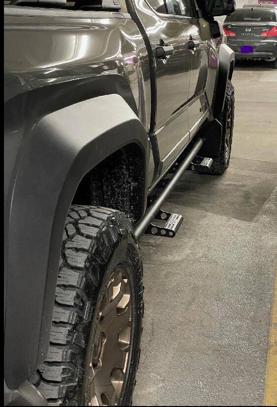

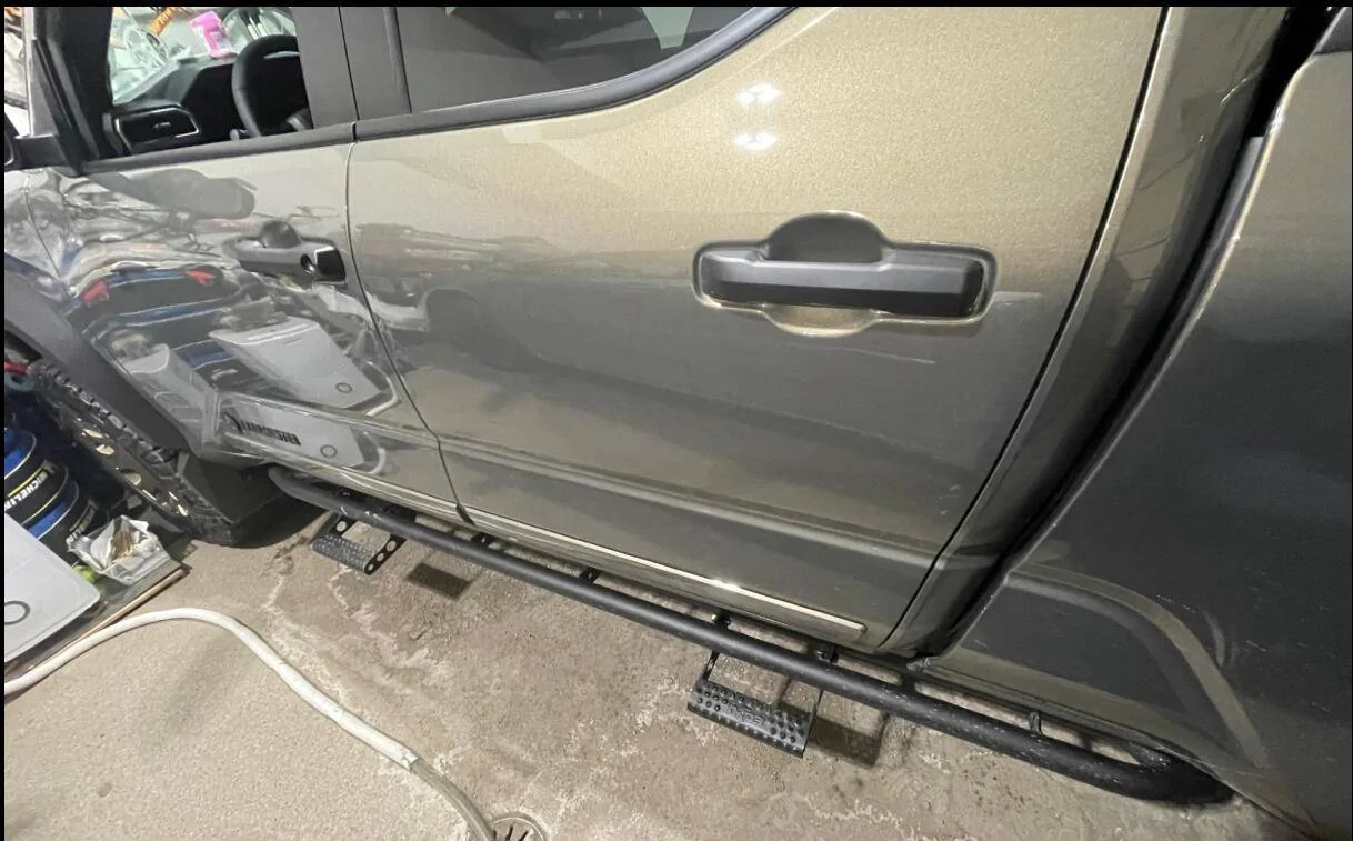

You can always add the N-Fab NFB-JPTS32 bolt-on steps which can be removed in a few minutes if you need the ground clearance. This makes it easy to step in and out plus they block a little bit of what's thrown off the front wheels.

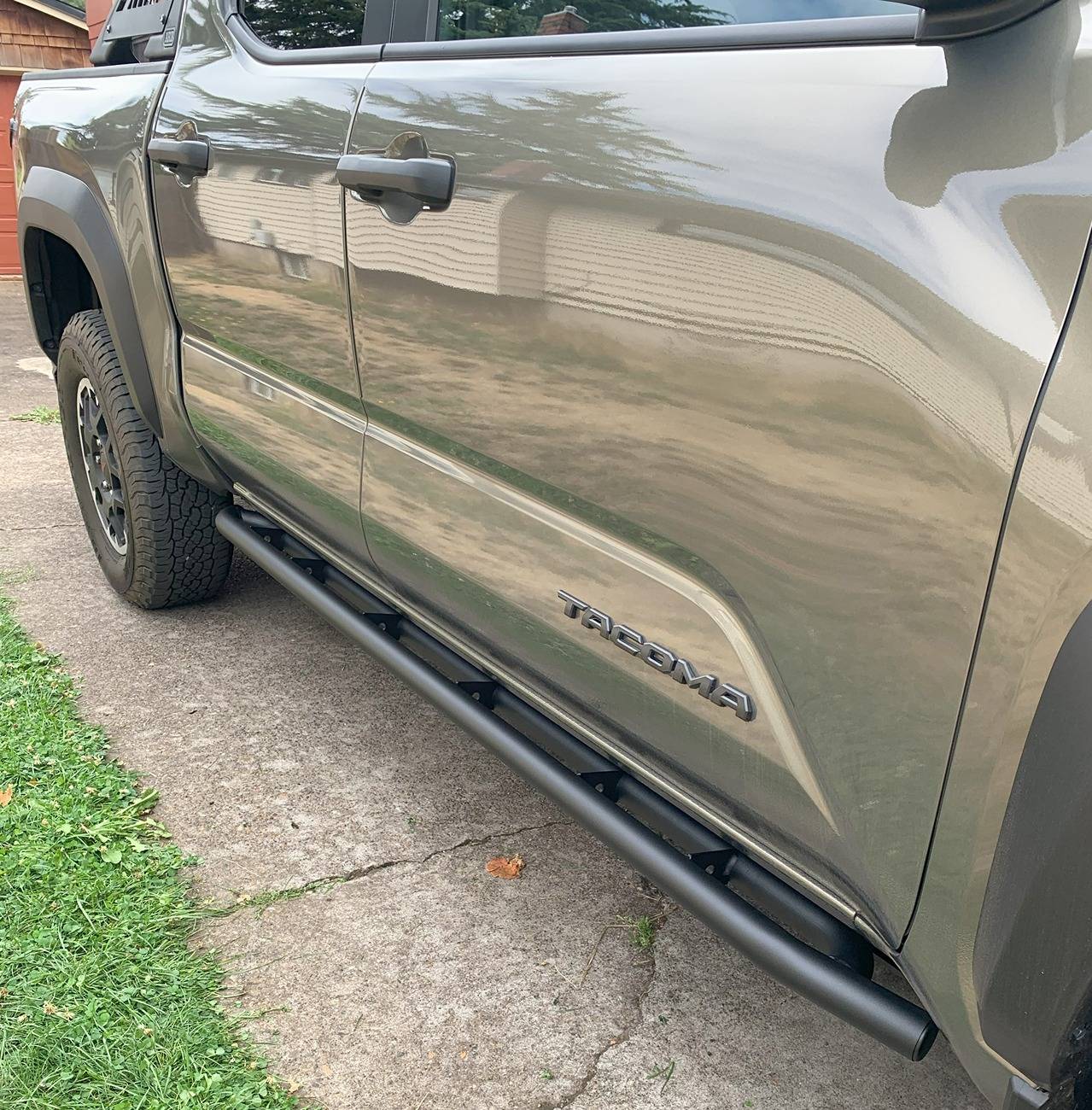

Rock Rails:
PT738-35243 (Right Side - Shortbed)
PT738-35242 (Left Side - Shortbed)
Weight: 56 lbs. each including 11 bolts, and warning card that says not to jack it from the ends of the rails (which are just floating)

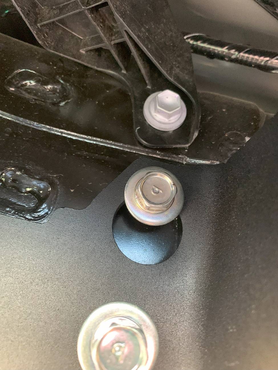

Powder coating seems great and the welds and bends and cuts are all perfect. They've doubled up on the steel on the back of the mounting points. This helps strength but also spaces the rest of the bracket face off the frame by a 1/4" so it won't trap as much water against it.
Installing takes about an hour, and totally doable by one person. One of the back bolts is designed so you can thread the bolt to the frame first them hang the rail on it, while you go to the other end and prop it up with your knee while centering and tightening the front bolt.
Takes several turns of the ratchet, especially the higher of the two bolts. I wrapped some vinyl tape on my ratchet handle so I could "bounce" it off the two sides of the bracket without damaging the coating while spinning on the bolts:
I didn't read the TIS, and not actually sure what the torque values should be but will add it if someone knows in the comments!

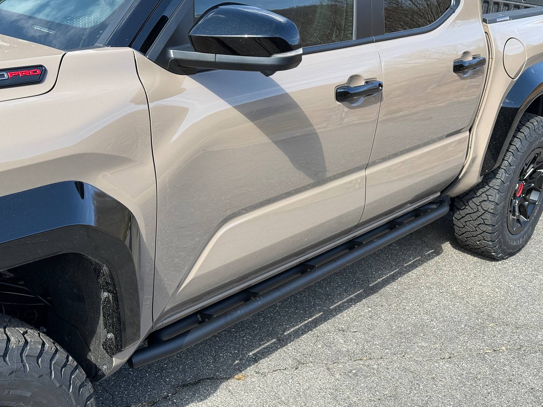

Anyway, perfect OEM fitment, well-designed, and easy to bolt on. Here are the installed pics:

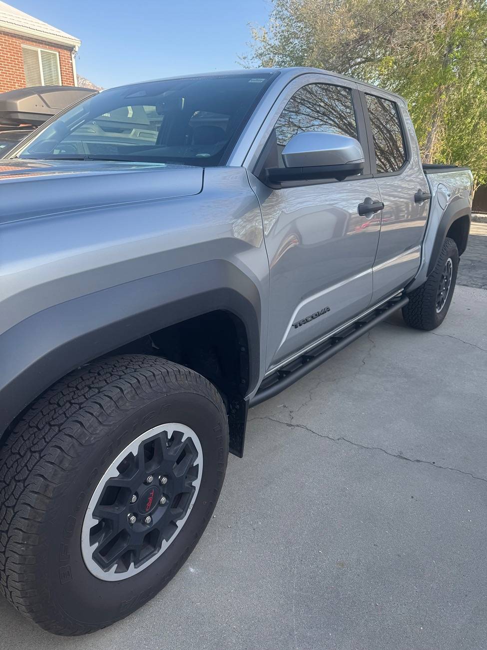

Thanks for the info, new member here and recently installed these. This thread was extremely helpful from verifying part numbers to finding the install guide Toyota fails to include.
I like the low-profile look of the OEM sliders better than most aftermarket options, and can’t wait to put them to the test on trail!
