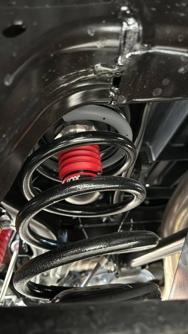

I think that is just the top hat that is ready for the bump? The Fox bump itself looks like mine below. That said, having that blank top hat means you may be able to pull that plastic plug and use that top hat for your airbag. Just run the air line through the hole the bump is supposed to go in.
I want to add the hydraulic bump stops to my TH. I cannot and neither can the Toyota parts department find the part number. If anyone can help that would be so greatly appreciated

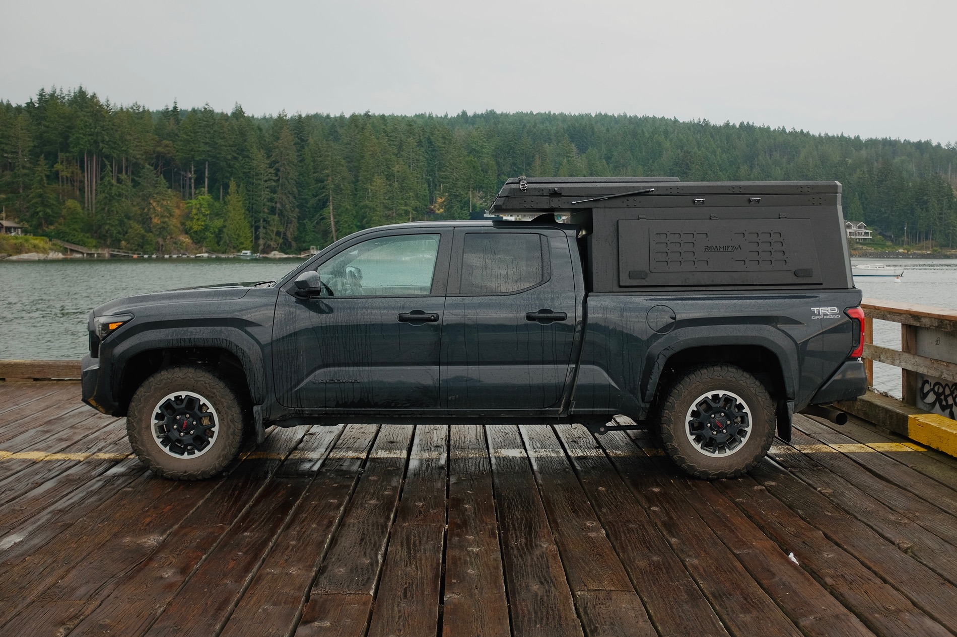

I installed the Westcott designs lift on my Pro this week with the rear spacer. It was pretty level with just my bed slide, fridge, and our rear bumper. Spare tire wasn't under the bed however. This is how it looked with that setup.
With a carrier and a 35" tire hanging off the back however, the rear was low maybe an inch. Was also pretty soft just driving around:

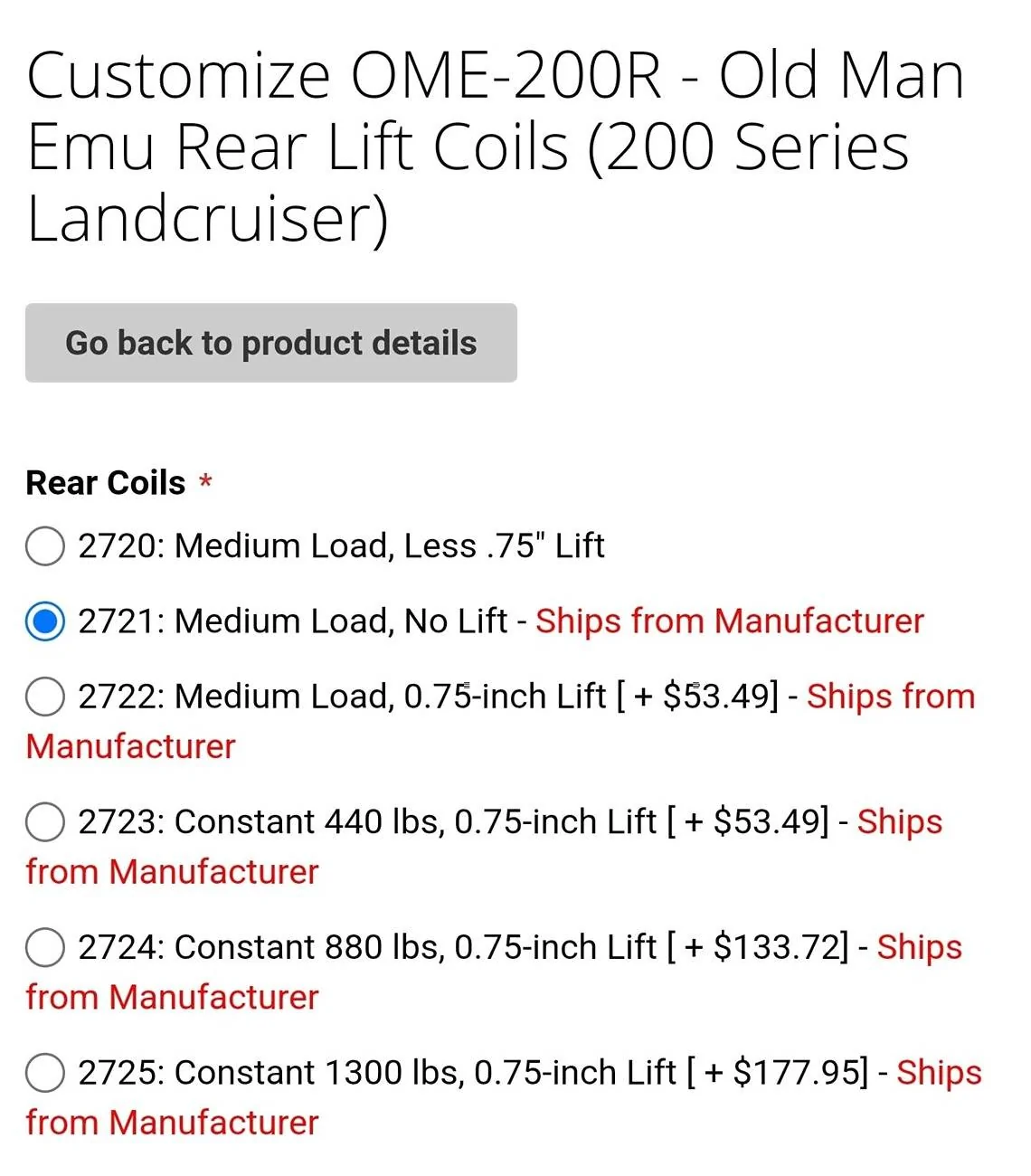

Hope this helps! The best part is that there are 6 options for the 200 Series application, so you should be able to find what you need (data from Toytec.)
I'm curious what the hub to fender measurement is with little to no weight in the box with the 2721's. My goal is get a heavier rear spring without too much lift, which has me considering the 2720's (-0.75"). did you happen to measure it without any weight?
