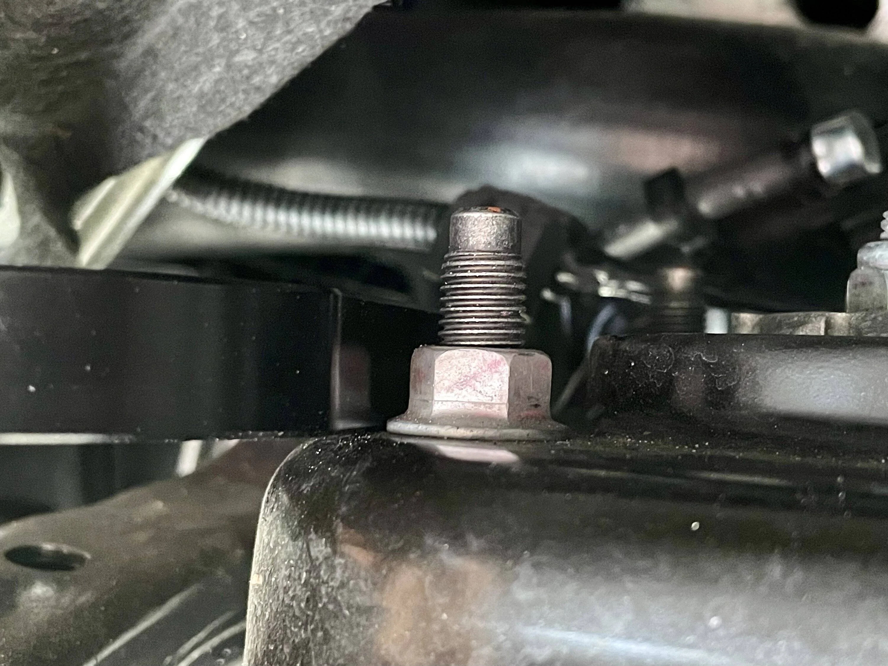

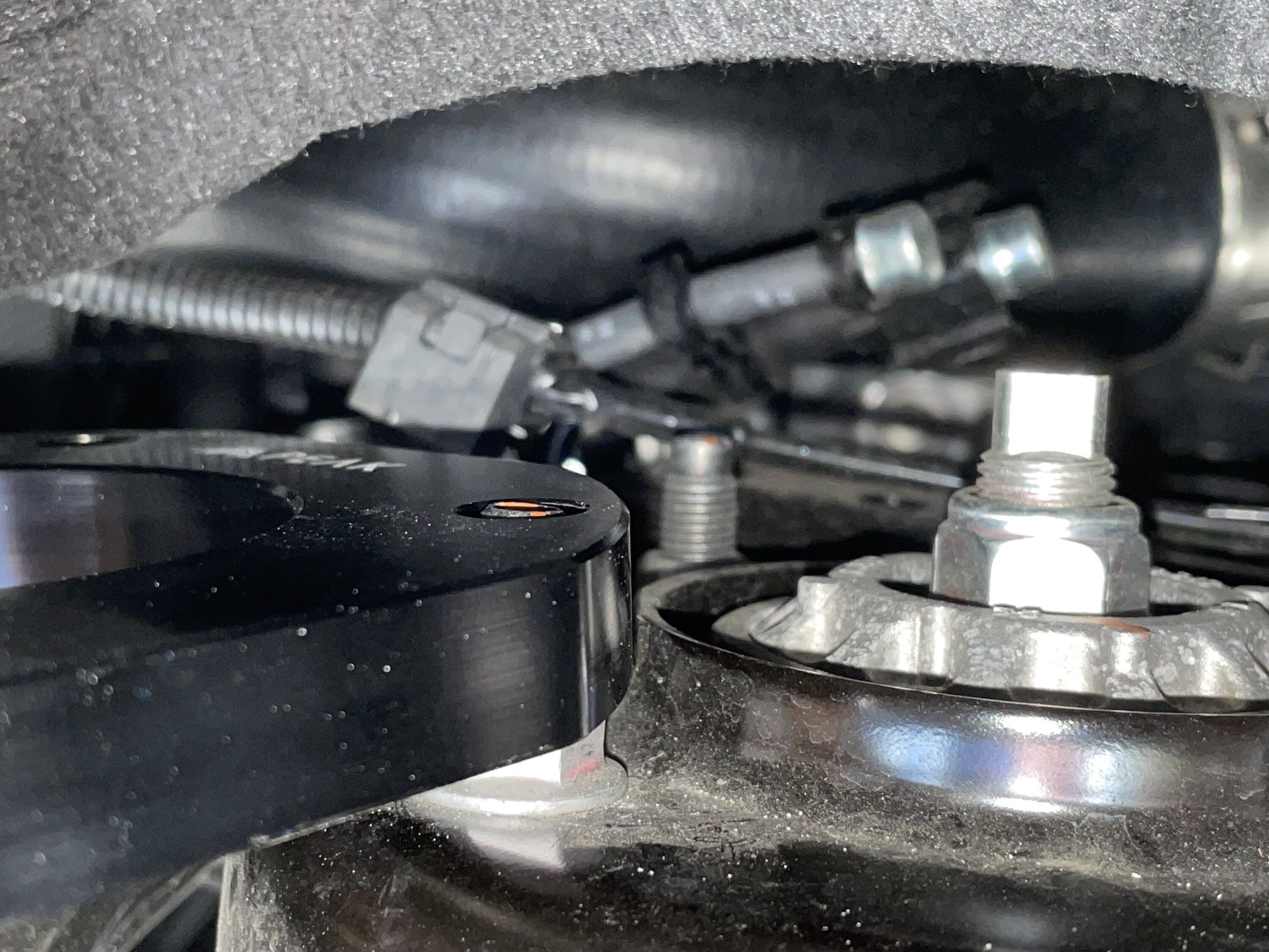

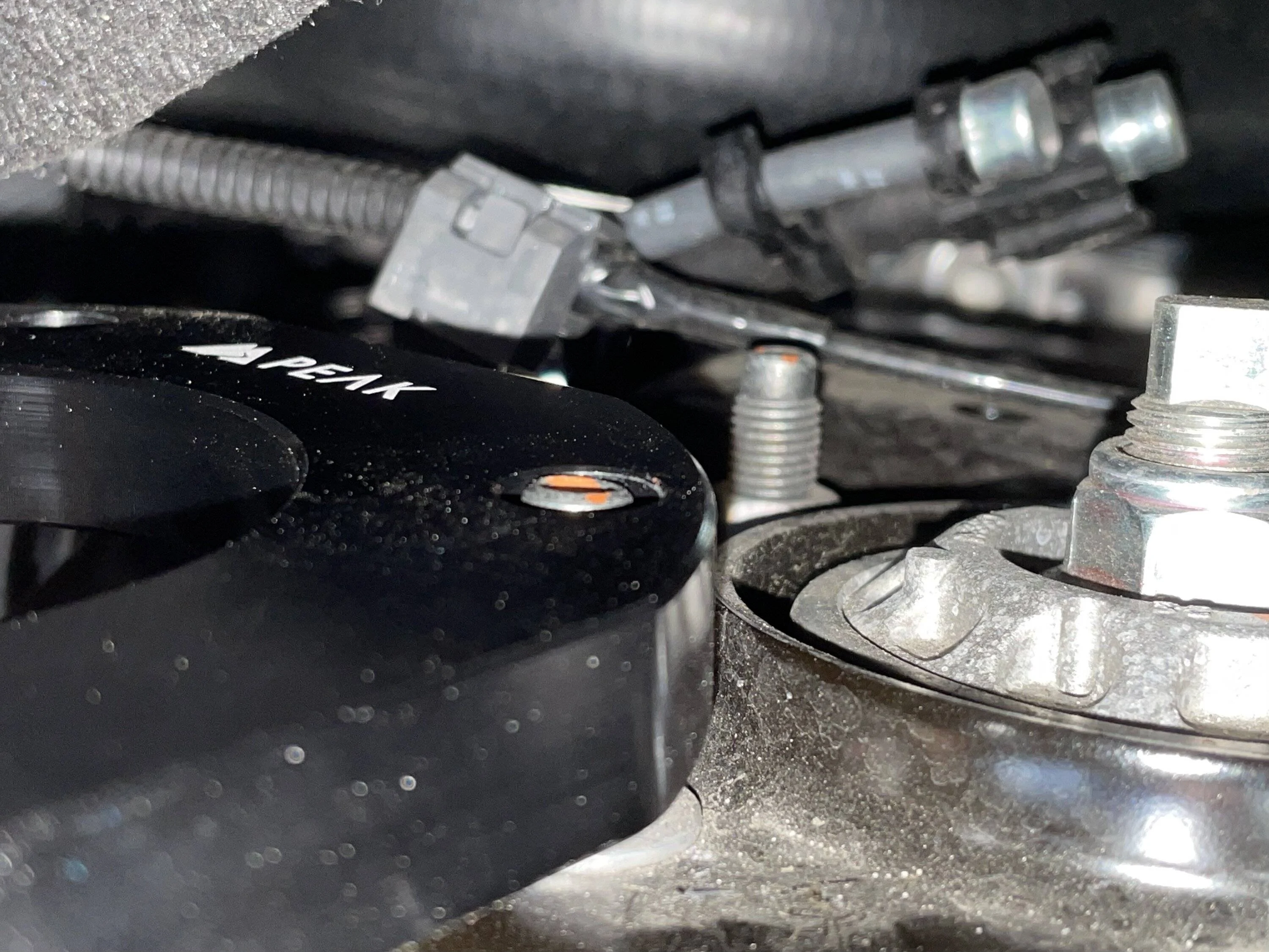

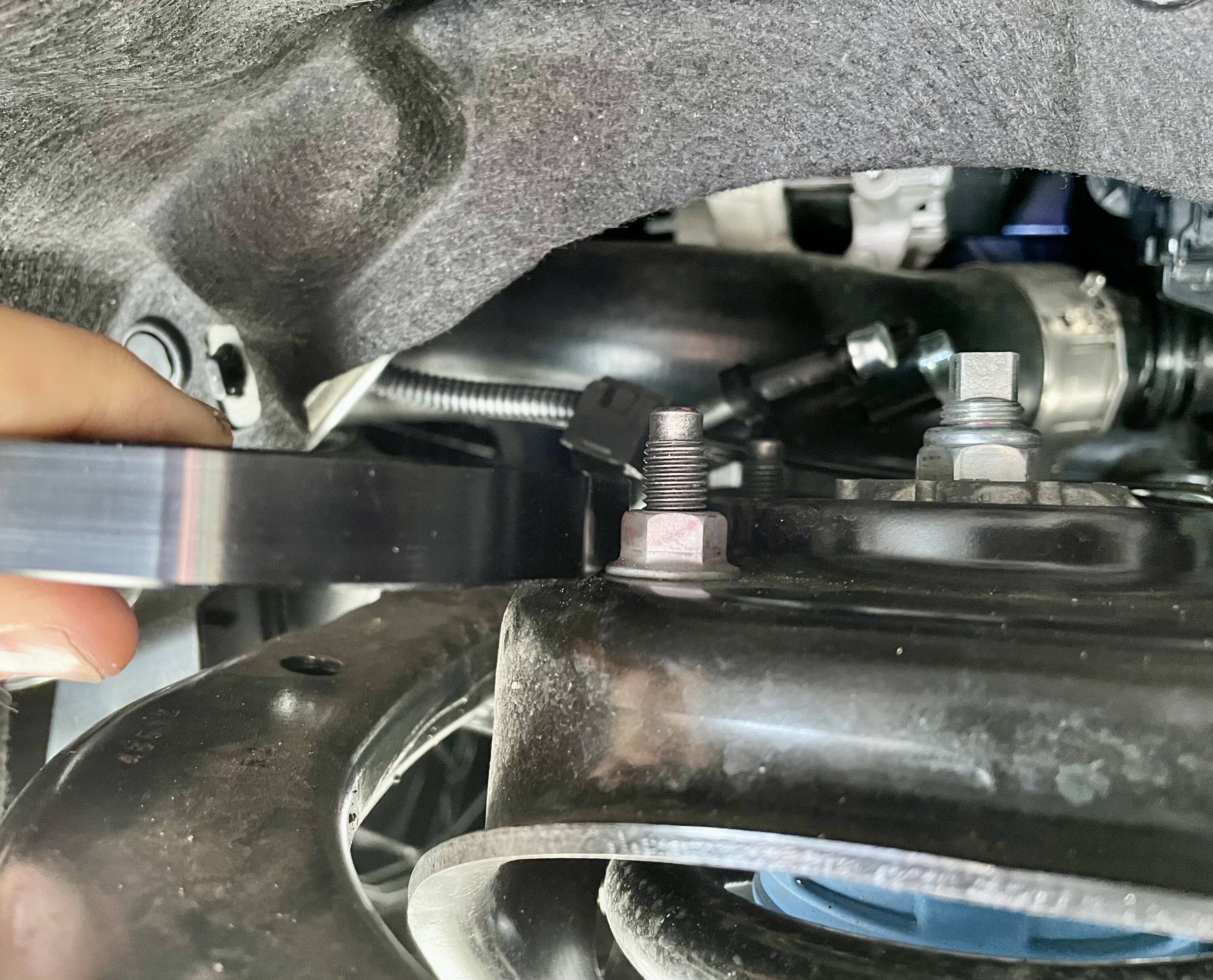

I am a bit on the fence now… the studs protrude out 15 mm from the top of the nut. There is only 10 mm of available thread (the top 5mm is unthreaded). The spacers are 15 mm thick. As a result, you only get about 5 mm of thread engagement versus 10 mm of engagement.
I got an email from Peak saying that they have thousands of miles on this set up with no issues. I’m contemplating whether I should still give it a go. Again, since all the forces are acting up (threads aren’t in tension), I think it should probably be fine.

I am a bit on the fence now… the studs protrude out 15 mm from the top of the strut mount. There is only 10 mm of available thread (the top 5mm is unthreaded). The spacers are 15 mm thick. As a result, you only get about 5 mm of thread engagement versus 10 mm of engagement.
Good pictures....this makes me think twice as well...let us know how it goes if you decide to throw it on.

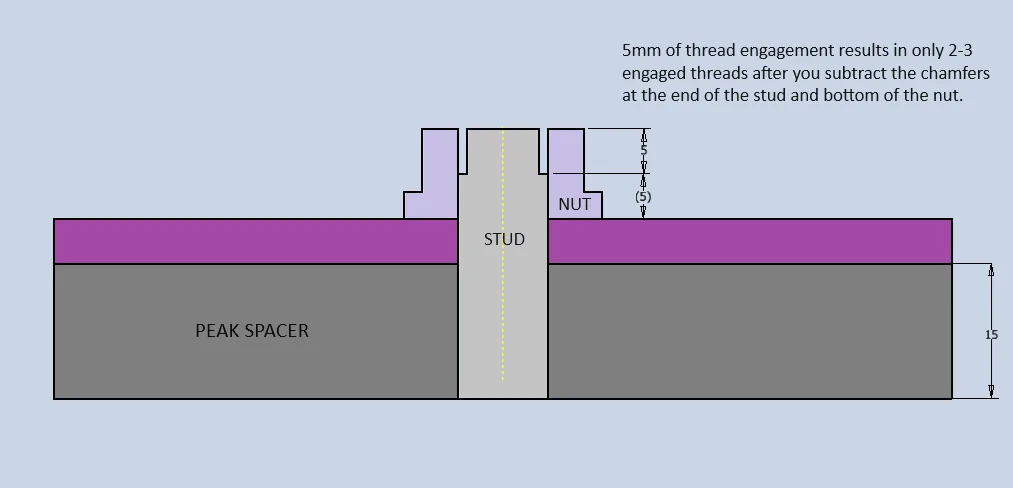

Here is the reason I’m still concerned:
2024 Tacoma Peak Suspension 2 Piece Trail Lift Kit installed on 2024 Tacoma Build (Supersonic Red) IMG_4175
As previously mentioned, the spring force is not putting forces on the studs, so it probably won’t be an issue. It’s more of a risk of stripping if overtorqued.
Nice schematic. Did Peak ever get back to you regarding collar only or did you look into machining down the spacer a bit more?
