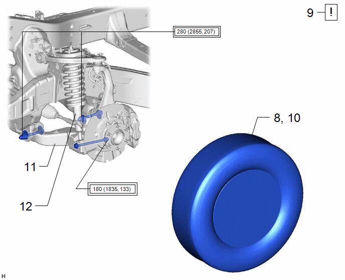

turnermier
Jul 18, 2025
oregon
25 trdor hybrid
Had the exact same issue, alignment bolts were not torqued correctly which caused the metal collar inside the bushing to slip.
Torque both cam nuts to 207 Ft lb or 280Nm
MAKE SURE VEHICLE IS ON THE GROUND OR YOUR LOWER CONTROL ARM BUSHING COULD GET DAMAGED.
Les Schwab had them at 100...
