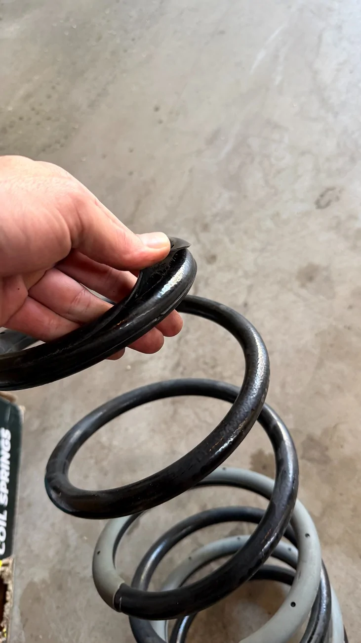

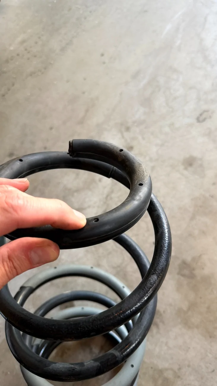

Are these the spring insulators you guys speak of? :wait:
Yes. Remove those from the old springs and install them on the new ones. You could probably use a bit of contact glue to hold them in place but so far mine stayed in place on the new springs for a couple of years w/o any adhesive so I don't think it's critical.

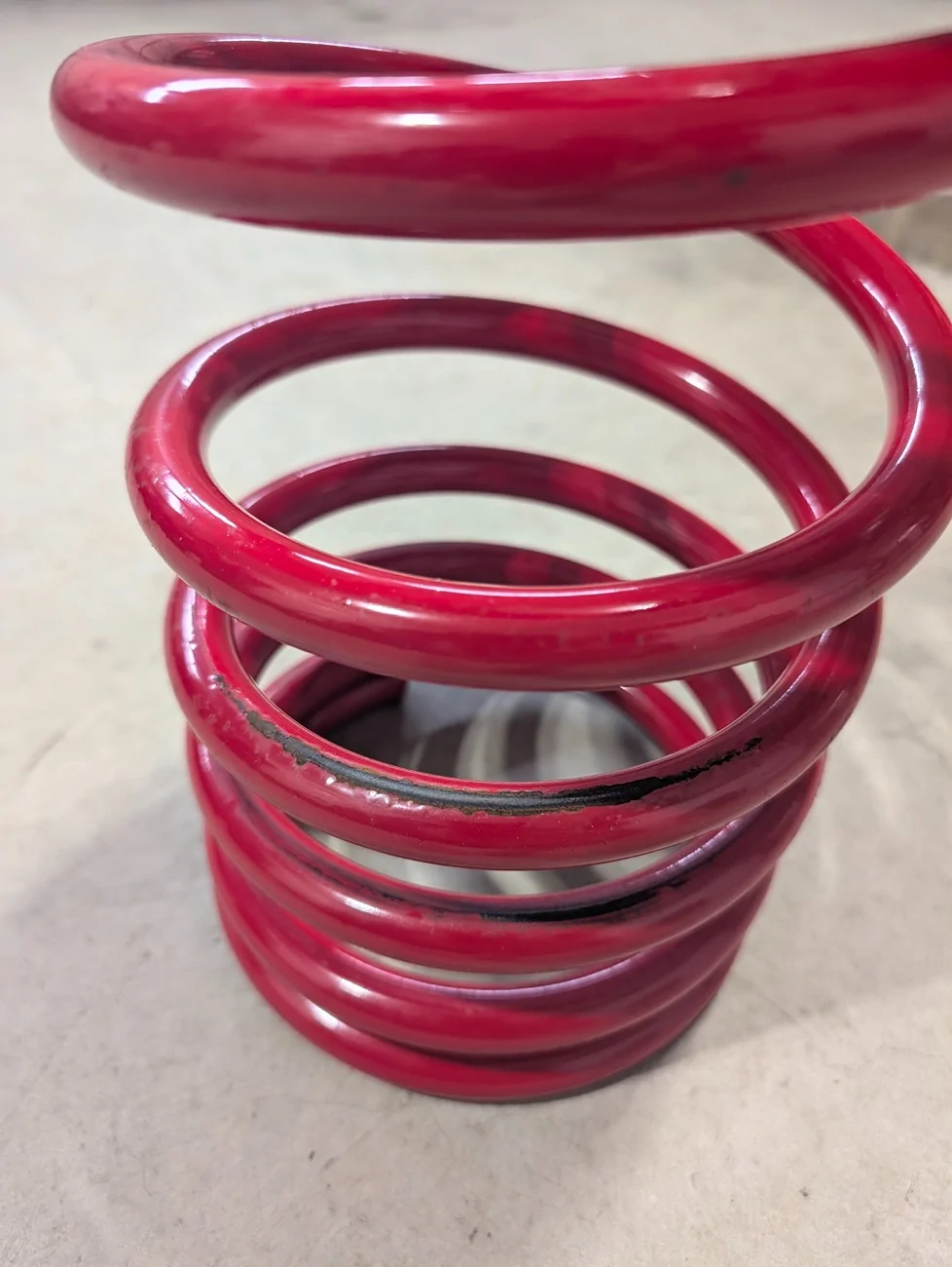

I just replaced my original Dobinson's springs that I've had installed for the past couple of years. I obviously should have went with heavier springs from the get-go (this picture is the 819) but you get the idea. There is wear from where the spring was fully compressed over and over again. Although I never noticed any creaking noises it's fairly obvious this is one spot the insulators may have helped (or the constant overload may have just worn through the insulator....).
