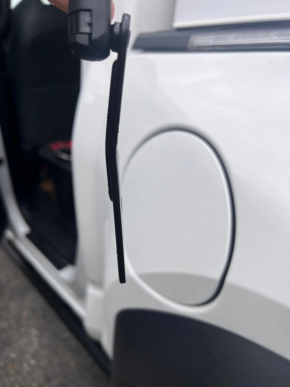

Their website says the bracket just needs to be bent over to clear? Is this not true?
They installed mine and slightly bent the bracket. You don’t even notice it. Think you can see it in my original pic.
It would be a large bend. I might notch mine at some point, but the knuckle of the lower strut attach point is right at the level of the tray. It didn’t come close to fitting when I put mine in. Might depend on what strut you have too.

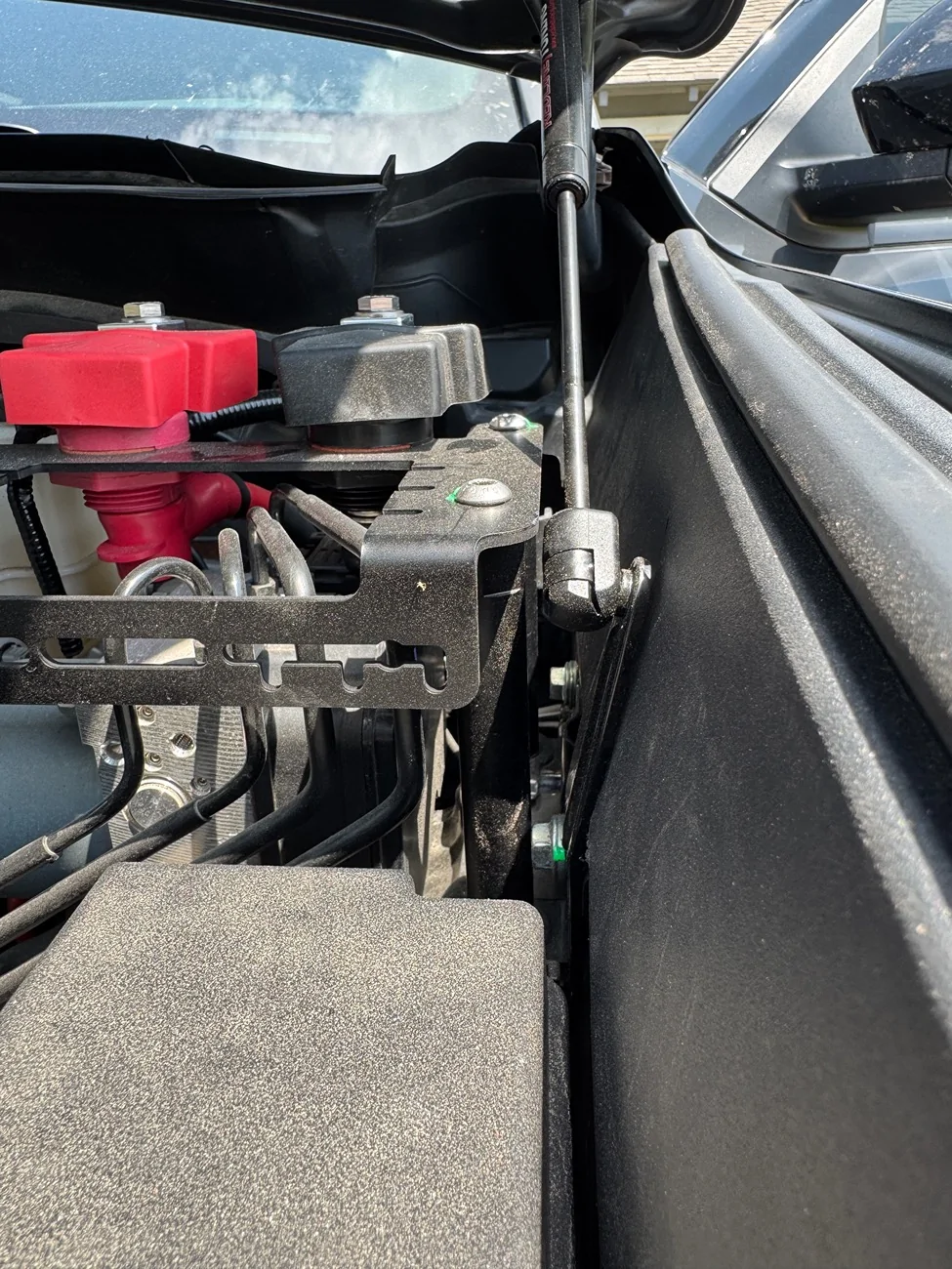

Got mine installed yesterday- and let me say I’m glad I purchased this and didn’t try to figure it out myself. This is one of the few things I’ve bought for this truck that I was really impressed with how it went together. The 3D wire guard for one of the pinch welds is well thought out and definitely something I would have skipped because it would take too long to produce. A note- if you have installed the hood struts, you will have to remove the right side one to fit this kit- the strut doesn’t clear the electrical shelf. Also- go ahead and buy 10 of the Toyota plastic fender screw holders- I either don’t have the tool or the skills to get them out without destroying them, and neither does my dealer based on how many they had in stock.
Do you put the strut back or are you only rocking one strut now? Or, did they bend the bracket to clear?
I just kept the one strut on the opposite side. Looking at OPs set up, it looks different than mine- his knuckle is well under the level of the tray, mine is right at the tray level, so not near as much clearance. Not sure why it is different. I'll pull the strut back out and see if there is a way I can squeeze it in there, but it didn't look like it to me.

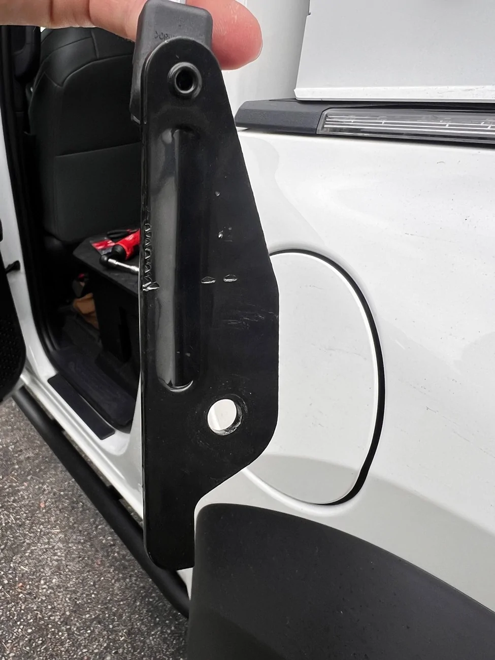

This is how they did mine.
Ok, I was completely dumb when I read your original comment. I thought you meant they bent the SDHQ bracket which didn't make sense to me. I finally figured out what you meant, and bent my forward strut bracket. Pics of the edge view (first bend, this was not far enough) and the front view where you can see where I put it in the vice, and smashed it with a 5 lb sledge.

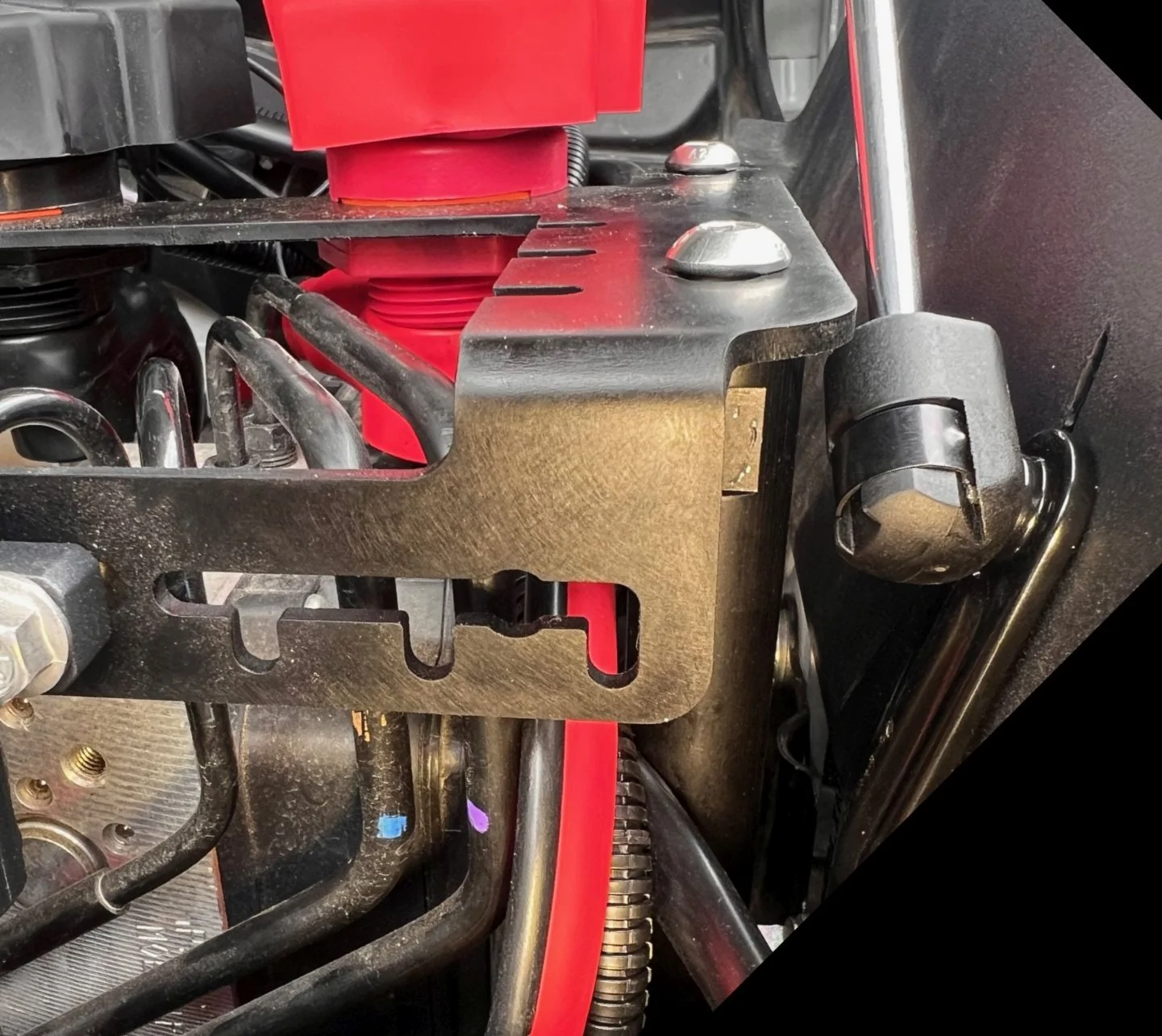

Ultimately, it has to sit right up against the plastic fender liner, or there won't be enough room to mount the front outside SDHQ post (removed here for installation of the strut bracket.)

Here you can see how close the front post is from the hydraulic strut mount with the bracket bent over to match the plastic cover.

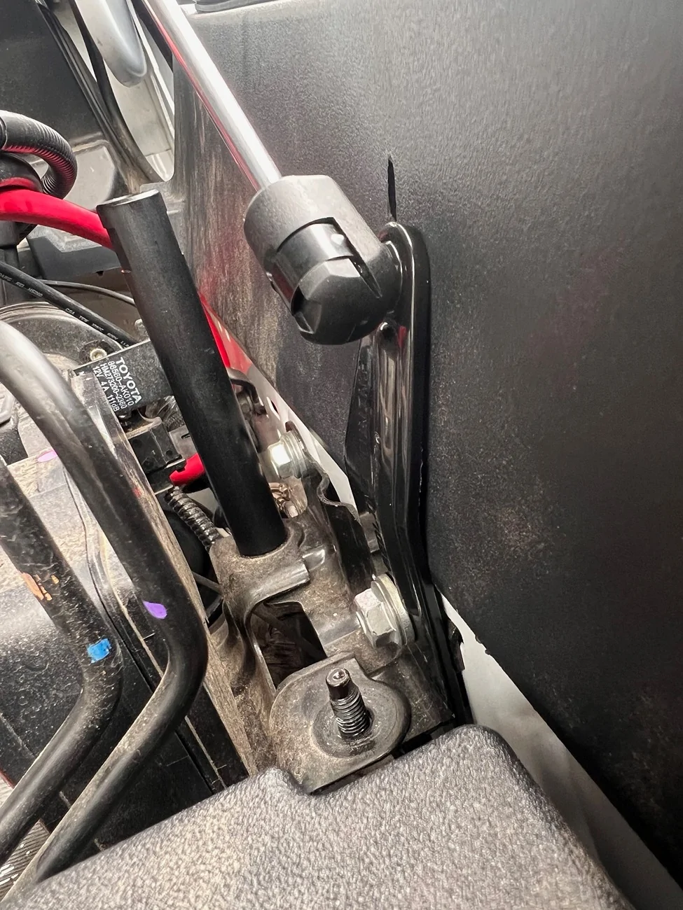

Without the bend, you can't install the front outside post. Unfortunately, that doesn't solve all the problems. This is the maximum bend you can do on the strut bracket, but the body of the strut still contacts the SDHQ mounting plate when you close the hood.
This isn't a show stopper, and I'll leave it like this for now, but I'm going to go back to SDHQ and see if they can adjust their top plate design to add a cut out for the body of the strut, as ultimately, the rubbing of the two during off roading (and maybe even regular driving) is going to wear through the thin body of the strut.
