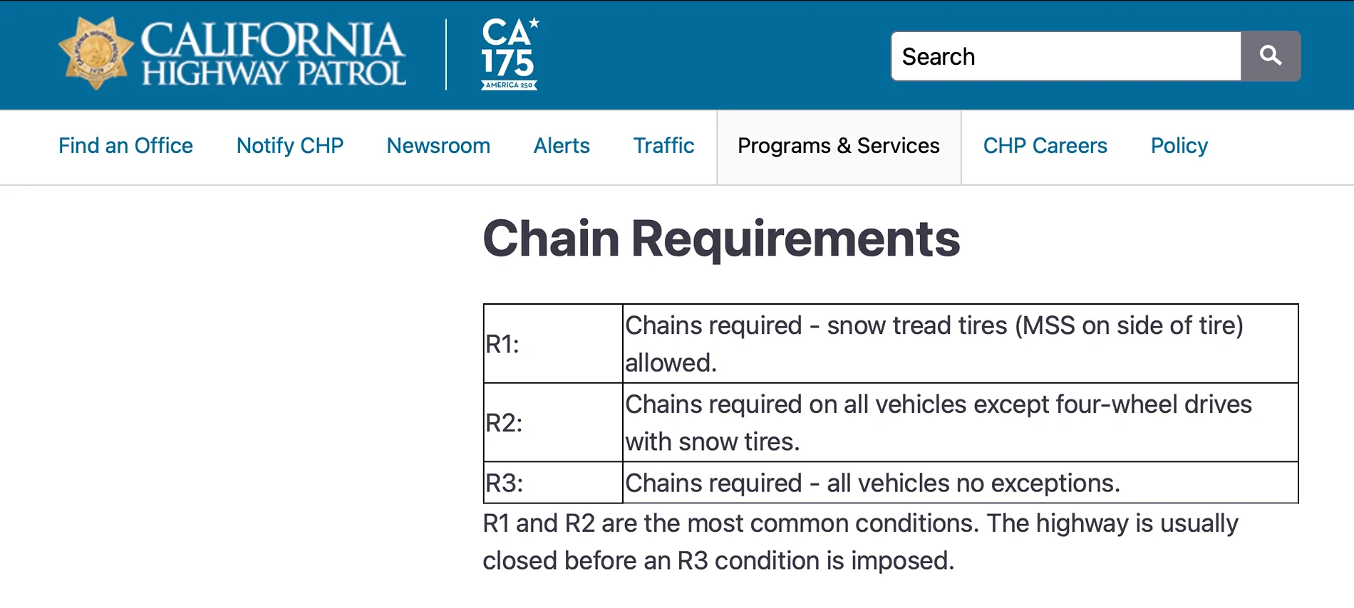

I'm at 6,800 ft in CA and will run studded snow tires all winter. I will also carry chains per Caltrans requirements. With that said, I will offer the following advice.

You can buy cables and they will get you through the Caltrans checkpoints, but they wouldn't last very long with the weight of a Tacoma.

My best recommendation is to check with your Department of Transportation to find out what are the requirements first, before you spend any money on any equipment. Then if chains are required, make sure that you buy the appropriate size for your tires and make sure that you install them and use them appropriately as to not jeopardize your safety or the safety of others and/or damage to your truck. I live in Colorado and when the traction law is in effect, my Toyota Tacoma Trailhunter meet the requirements as it is (AWD or 4x4, M+S tires or winter tires w/snow flake icon and tire tread depth of at least 3/16 inches, if none of those then chains or another approved traction equipment is required).

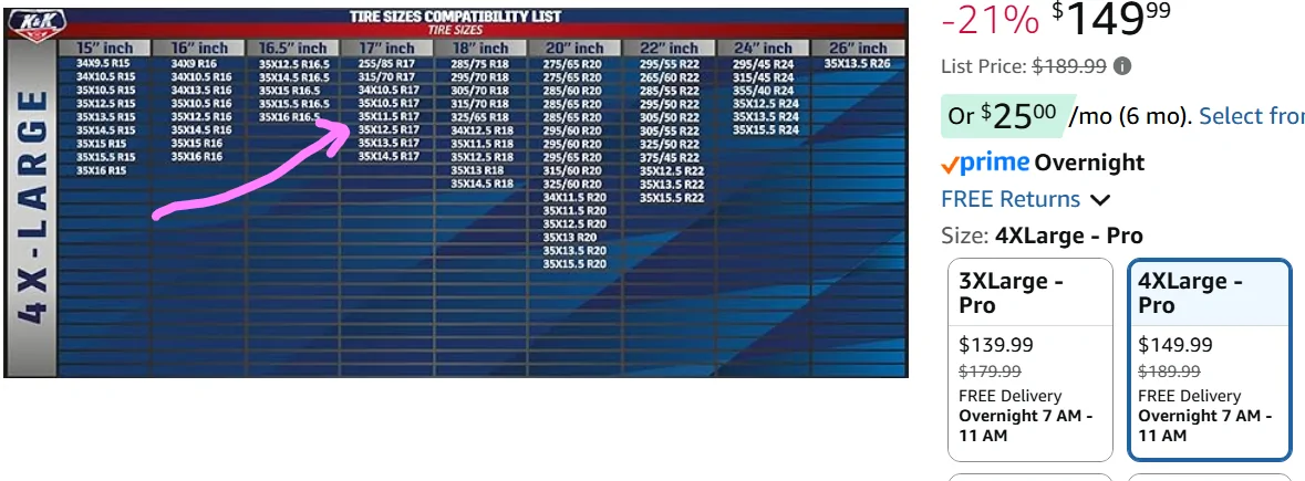

I am wanting to get updated chains for my Trailhunter, use them a couple times a Winter at most since AT/ KO's seem to do really well and I have a lot of experience with them (300,000+ miles).
Now I am running bigger tires, 275/70/18 and wonder what will be easy to get on and off and still clear relatively well with ice build up in the wheel wells in wetter storms. The main reason I ask this is that I just signed up for a trip in Yosemite National Park at the end of February and as a former Cali resident, I know how those storms can be, quite wet that turns super slick with one spin of the tire. Konig XD-16 Pro's look the part but again, wonder about easy on and off and clearance.
