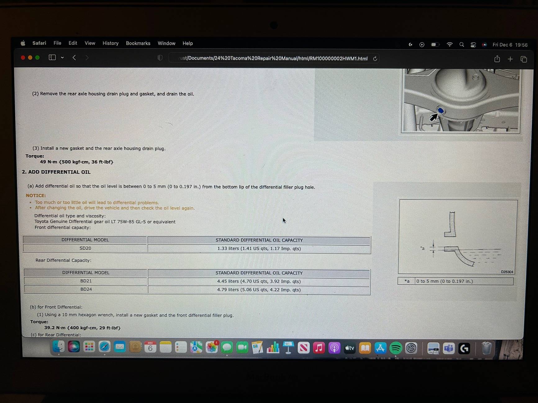

Has anyone changed their Rear Diff fluid yet on SR5's? The manual says 4.8 quarts, and my SR5 took exactly 4 quarts. Very level. I wouldve not cared much if it took 4.5, but not a drop more than 4. Seems like the book is quite off.

Update: I drove it around, then rechecked it. The 4.8 quarts they list must be the total for a 100% dry diff. Id say theres most likely 0.8 puddled in there somewhere. Its full at 4.0

Here you go brother. Straight out of the Toyota service manual. Look at the sticker on your diff or just fill until it trickles out of the fill hole.
2024 Tacoma SR5 rear diff fluid capacity IMG_2307
I hear ya. The manual says 4.8 quarts. 0.8 Quarts is almost a whole quart, and thats alot of difference from 4.0 quarts even. The third and second gen took pretty much exactly as advertised.
I still think 0.8 quarts off is alot, but as i stated after, theyre probably measuring that amount from a bone dry diff. After you drain, im sure theres just some residual puddles here and there taking up the remaining 0.8.

Looking to change the fluid in both front and rear diff's on mine. Thanks for sharing the photo from the service manual.
