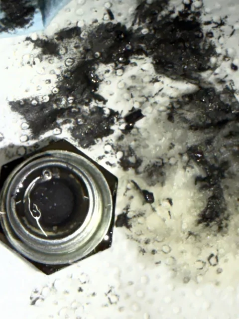

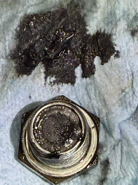

GSPHerder
Rudy
Feb 13, 2026
222
185
New Mexico
2026 Tacoma TRD PRO
I did mine at 1200, the rear diff had lots of metal shards and fine particulates. The front was pretty nasty also.
