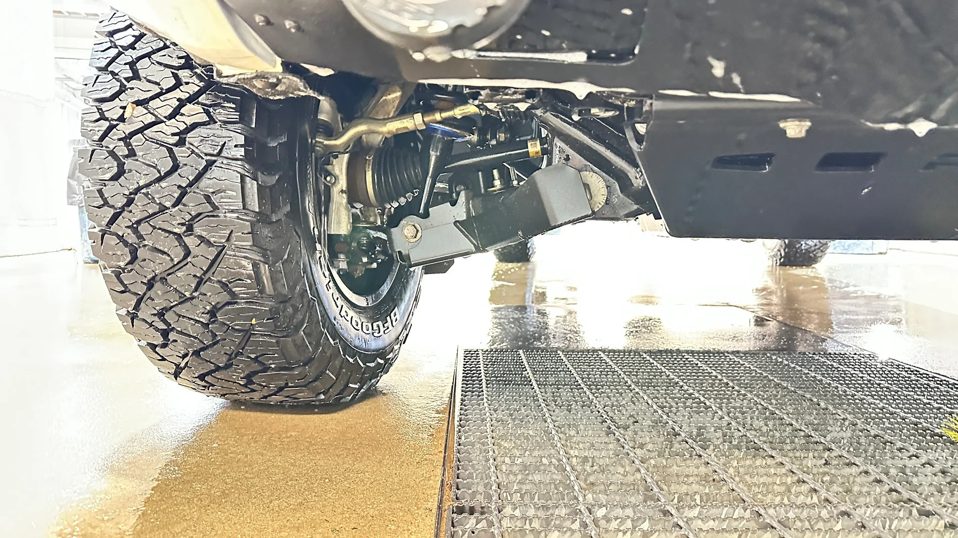

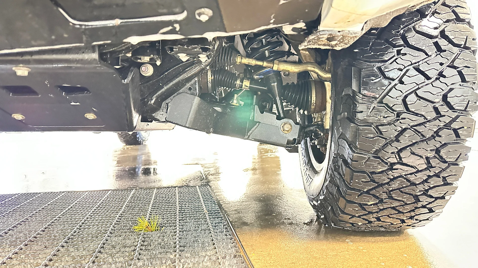

I recently installed Peak’s 2.0 Aluminum Explorer Kit and Core's 4x4 Rear Suspension Kit on my 2024 TRD Off Road Tacoma, which raised the truck by 2 inches. Visually, the CV joint angle seems unchanged, so I’m unsure if I should install a Differential Drop Kit to prevent additional stress on the CV joints. Some recommend it after lifting beyond OEM specs, while others only suggest it for lifts over 4-5 inches. Any experience-based advice would be appreciated.

Posting a few shots of your CV angles/boots would be helpful...

The angles don't look horrid. The bellows of the boots (especially the inner boot) look like they are making contact, so while angle themselves may not result in binding, premature boot wear may be in your future.
For what it's worth I'd dial the lift down before I did a diff drop.
