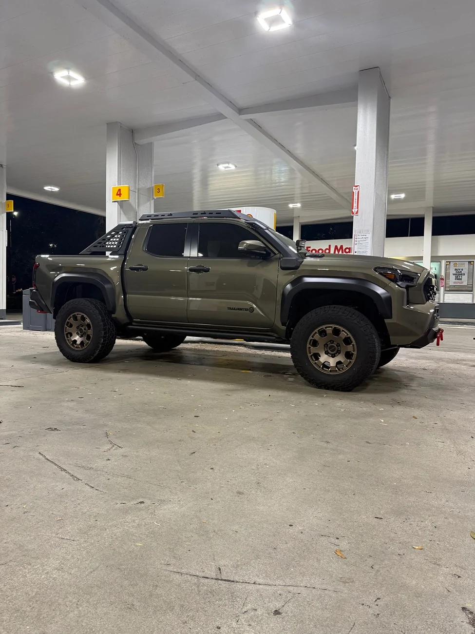

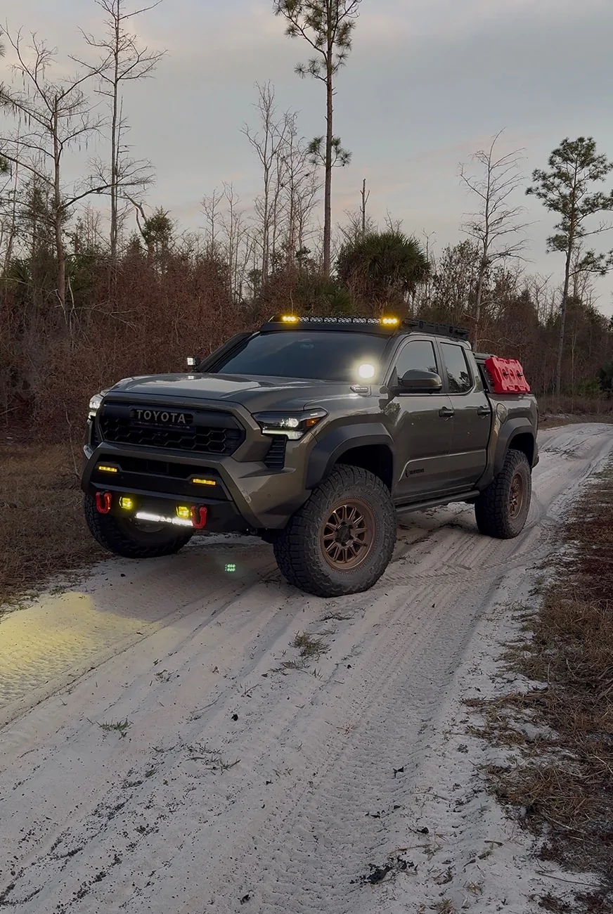

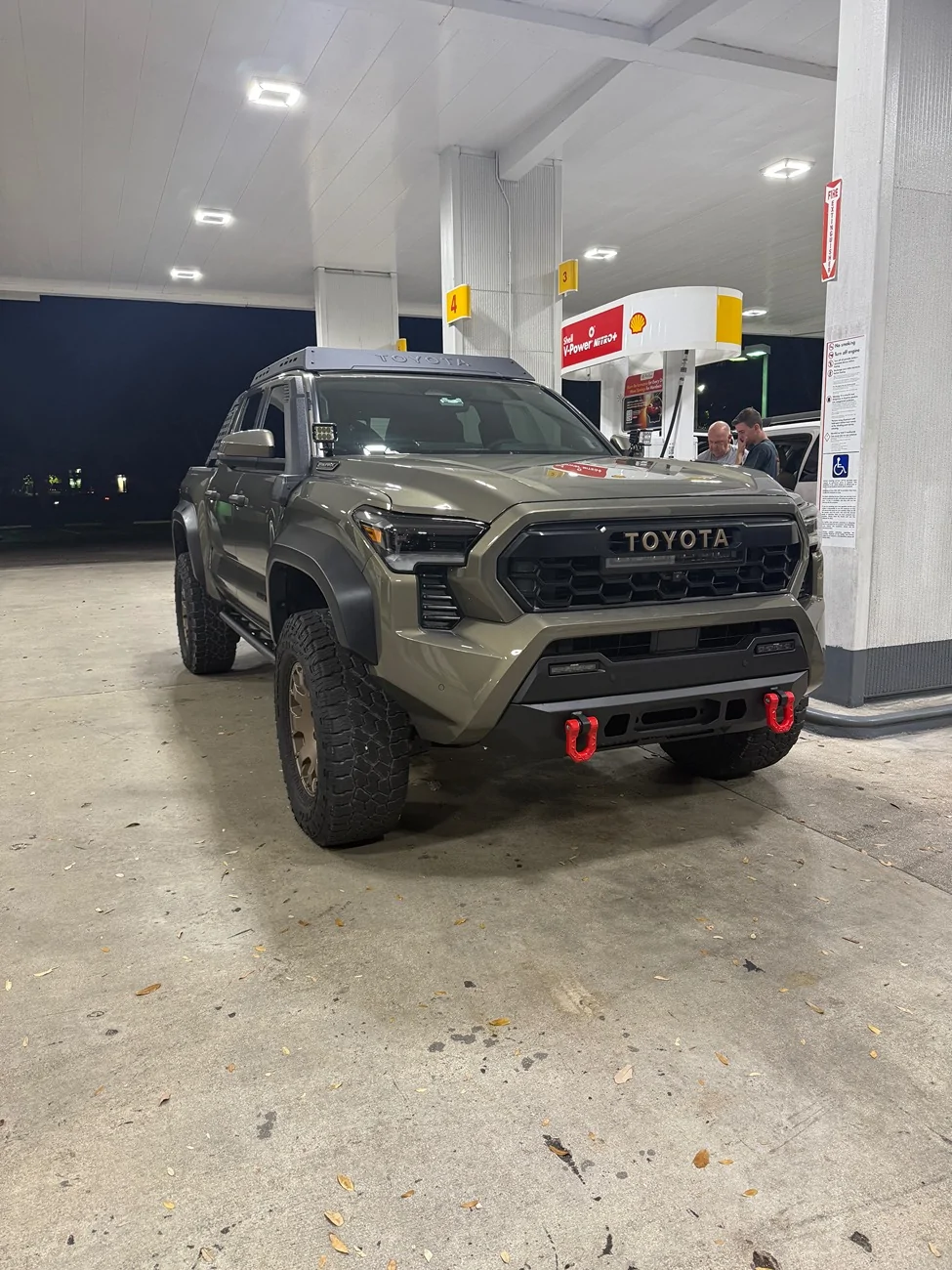

Installed new Dobinsons springs today on my Trailhunter.
Went with 817s in the front and 820s in the rear, gained about an inch front and back.
Questions:
Should I consider stronger sway bar links or extended sway bar links to correct sway bar geometry?
I have the electronic sway bar disconnect. Should I consider a diff drop? I read some funky feedback from the icon diff drop

So now that they had a chance to settle about 4k miles. Everything is still feeling super good.
Total lift is about an extra inch front and rear from center of the hub to the fender over stock TH. Carrying about 200lbs in the bed.
Rebound feel good and no extra bounce on pavement or off road (Florida is mostly mud, sand, and water) no rock crawling tested yet
