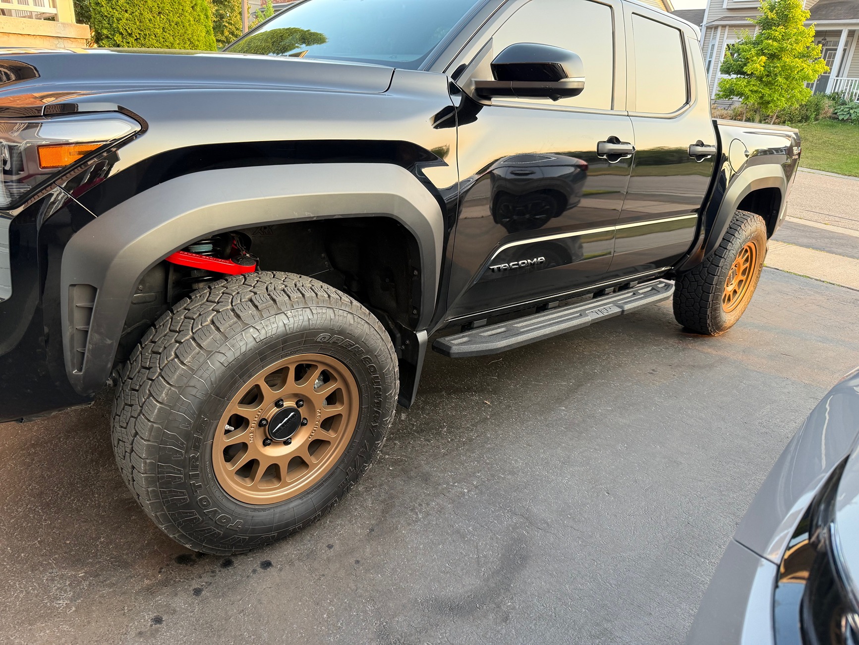

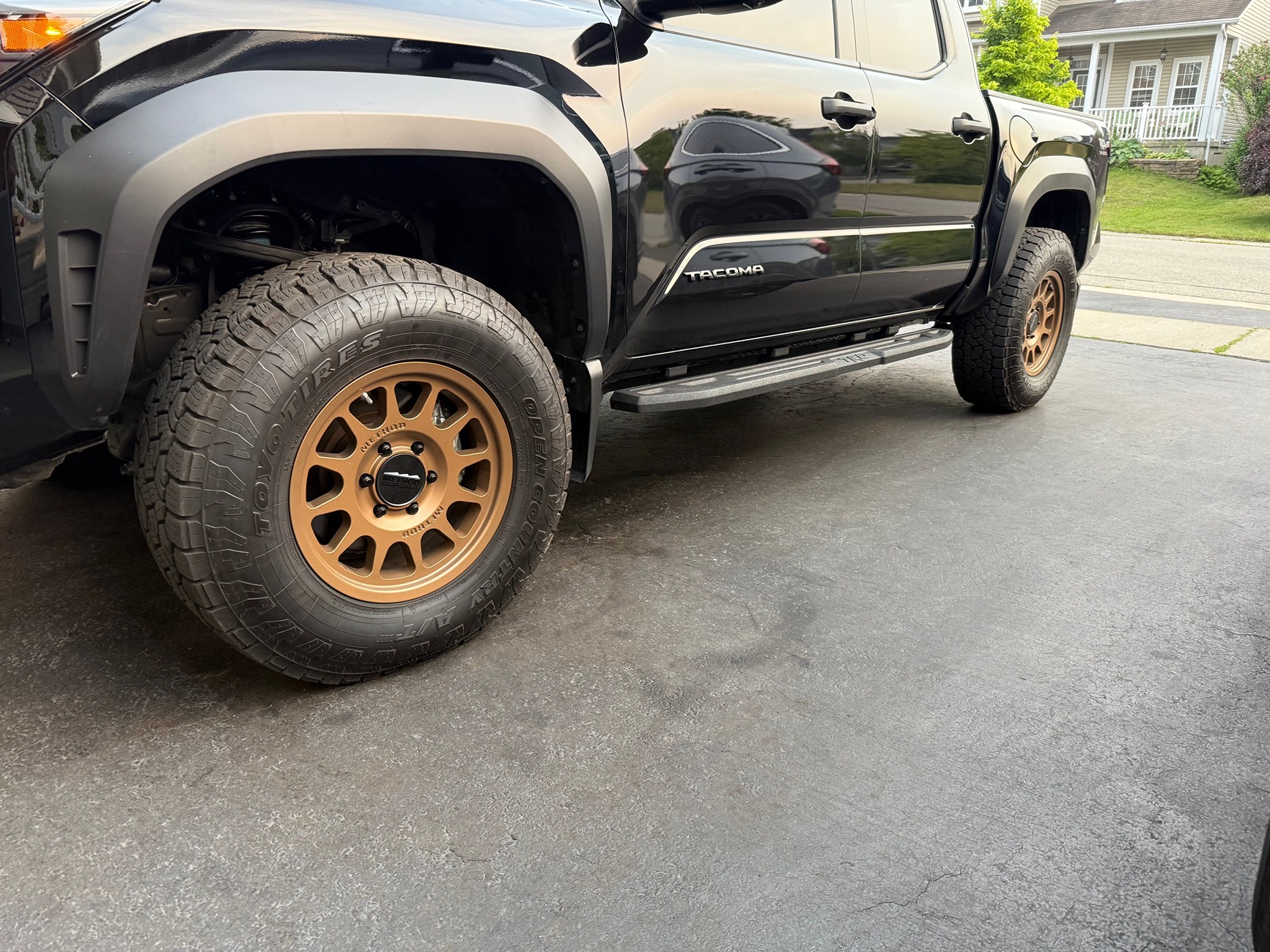

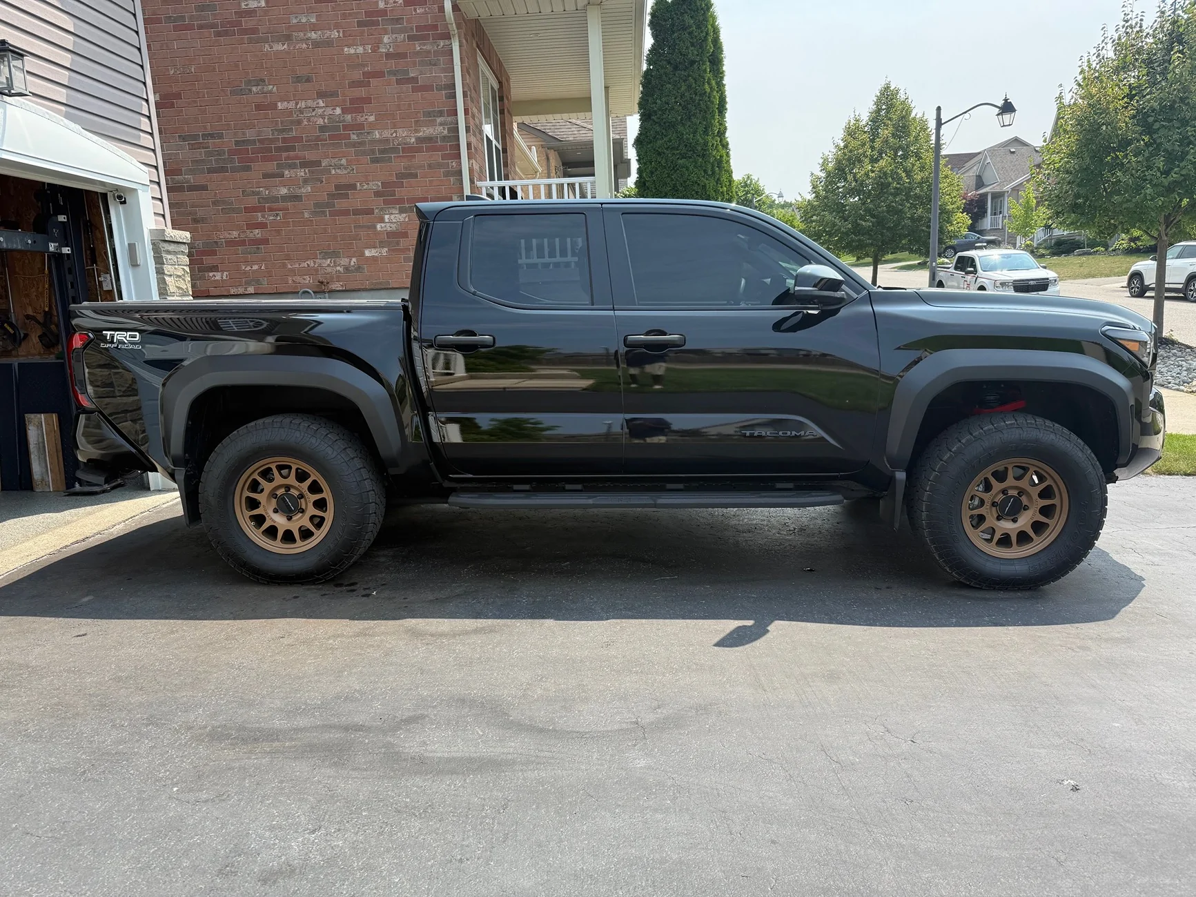

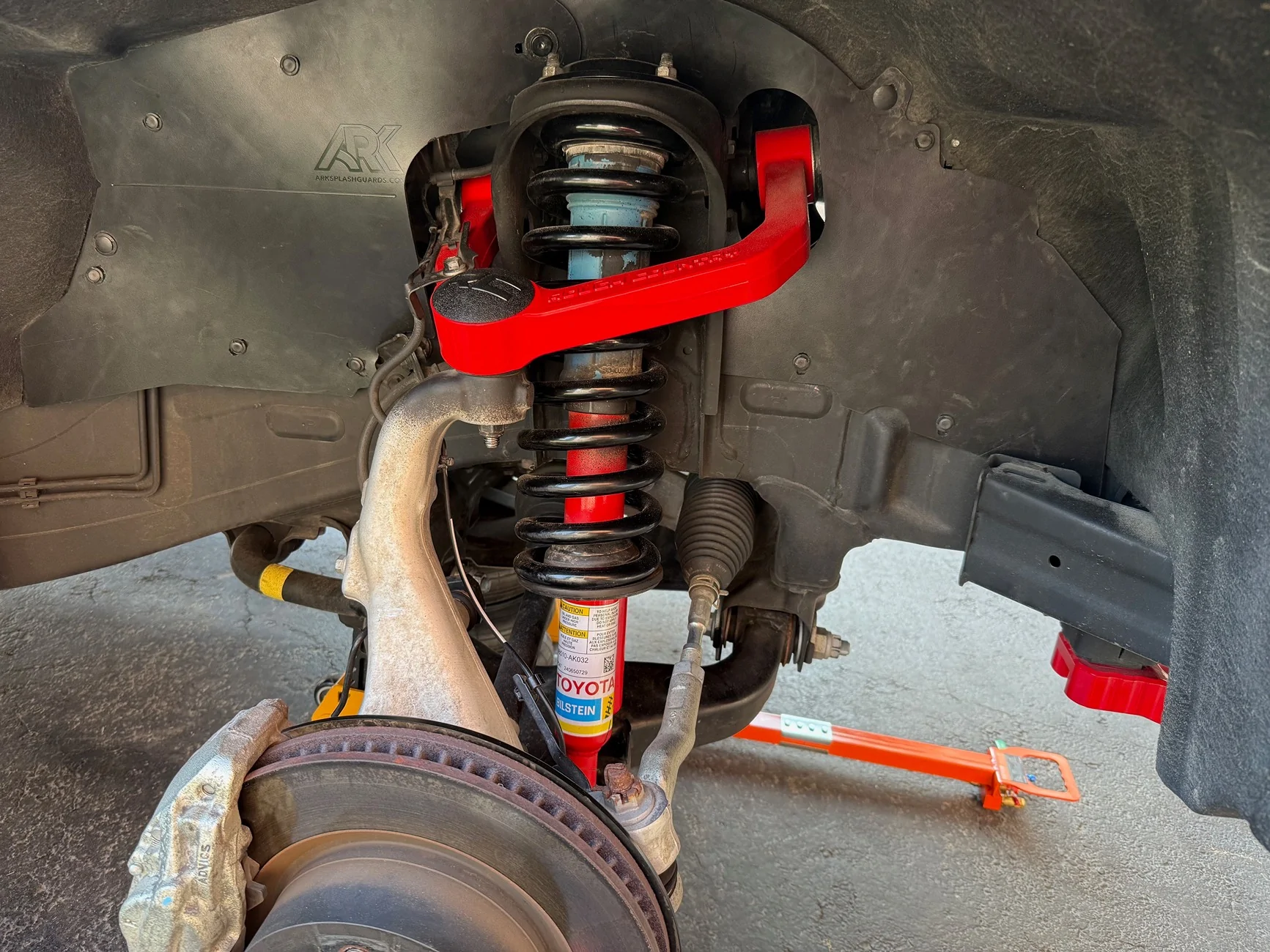

Just installed mine today. Also installed a set of OE Rough Country upper control arms. Install was fairly straight forward. Currently sitting about two inches higher. Hoping it settles. Taking it in for an alignment tomorrow.
Sitting higher in the front now by about an inch.

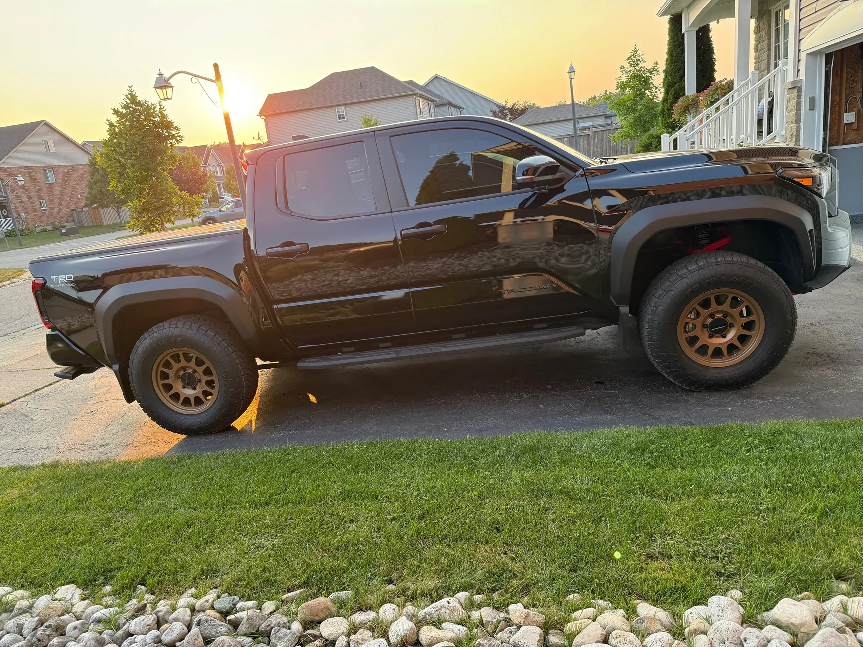

Follow-up from my front spring install completed yesterday. Took it out for a little drive today and they have settled a bit. Dropped about a half inch from yesterday. Just barely sitting higher than the rear at this point. Happy that it did settle before I take it to the alignment shop this afternoon.

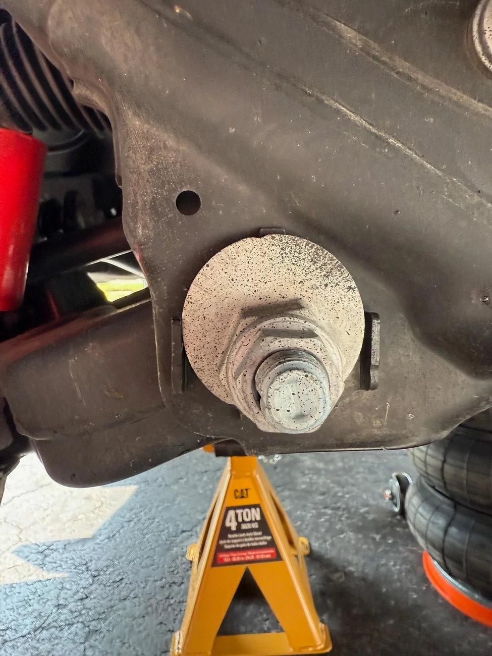

How off was your alignment after the springs install?
GoodMoodley
Apr 22, 2025
Ontario Canada
2024 TRD Off Road Premium, 2023 CRV Hybrid Touring, 2015 228i xDrive, 2012 135i

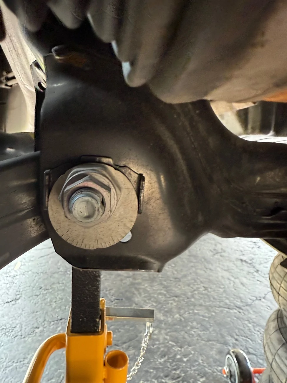

When I installed the springs I made sure I marked off the camber adjusters on lower control arms and maintained their position when buttoning everything back up. Toe settings were fine as I did not touch the steering end links. The lift added noticeable positive camber however. Vehicle drove fine overall in order to get it to the shop. An alignment is definitely needed if that's what you were wondering. Left truck at shop overnight and will pick it up tomorrow. Will post the alignment sheet if I remember.

Yes I am trying to see if they get in line or upper control arms with adjustment will be needed?
GoodMoodley
Apr 22, 2025
Ontario Canada
Should line up with no issue. There is plenty of adjustment available. My stock setting was pretty much in the center.

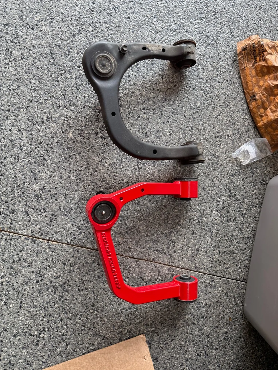

I've noticed some people have left the stock control arms and you went aftermarket... Was there a particular reason you upgraded?... Truck looks great... These springs seem to lift the front end pretty good
GoodMoodley
Apr 22, 2025
Ontario Canada
No reason other than pricing was good and I think they look cool. I have red lettering on the tailgate and red tow hooks.

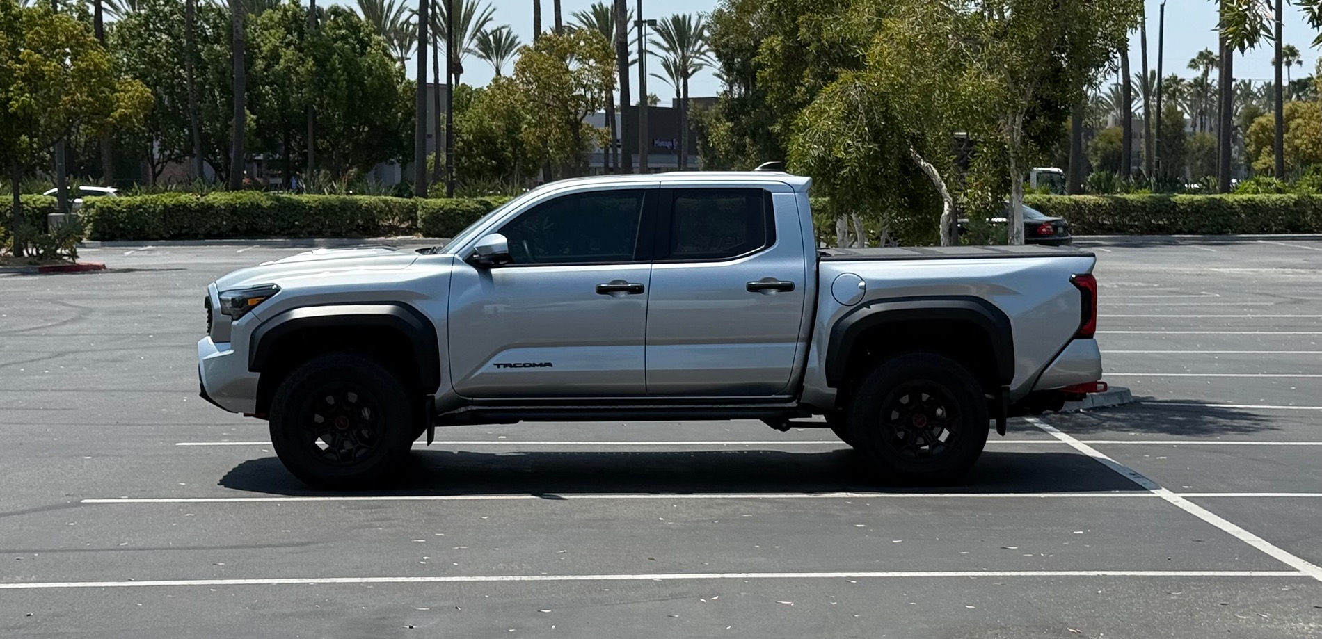

So far I’m liking the springs. No more hitting the bump stops. I’m also able to carry 600 pounds of salt without sagging now. First pic is just after install. Second is after it settled and bed empty. Third is with 500 pounds of salt.
