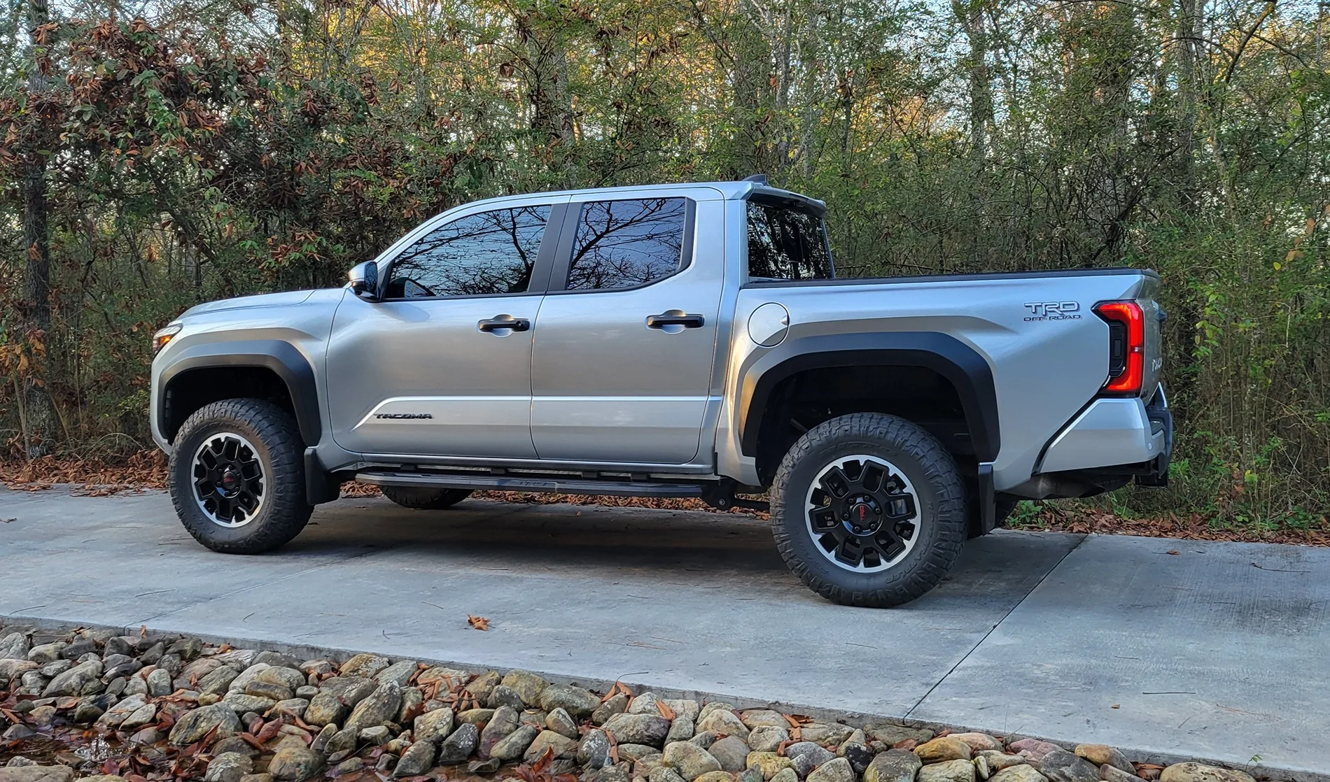

So far I’m liking the springs. No more hitting the bump stops. I’m also able to carry 600 pounds of salt without sagging now. First pic is just after install. Second is after it settled and bed empty. Third is with 500 pounds of salt.

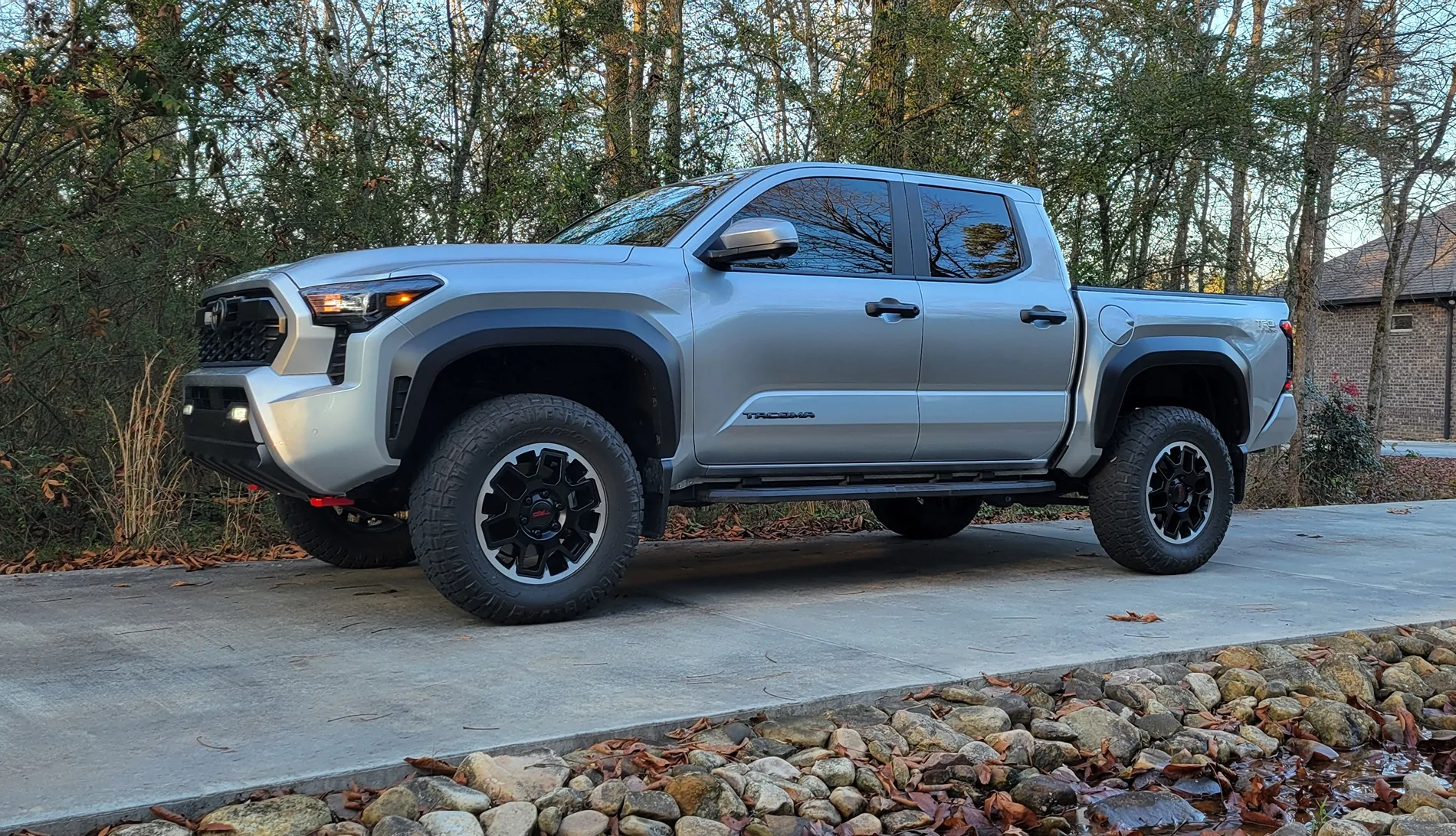

Thanks, Toyota won’t make me a non hybrid Pro with under seat storage and regular front seats so I made my own.
This one in front of my house is after it settled. But I wanted the front a little higher so I put 0.9 inch Trailhunter spacer from Peak Suspension (next to building photo). Caveat, this did take it out of range for the offroad upper control arms so I had to get the TRD ones.
Haha, Thanks. I wanted the non-hybrid for the same reasons. :) So the bottom two photos are with the extra .90" front spacer, right? I may get both front and rear coils and cut a little of the coil off the rear if it's too high. The rear seems to be pretty easy to deal with.

Haha, Thanks. I wanted the non-hybrid for the same reasons. :) So the bottom two photos are with the extra .90" front spacer, right? I may get front and rear but cut a little it of coil off the rear if it's too high. The rear seems to be pretty easy to deal with.
Yes I tried to get the same angle as the springs only photo but couldn’t quite figure it out so I just put both. When you do the rears make sure they transfer all the rubber pieces from the factory spring and loosen and retorque all the suspension links.
