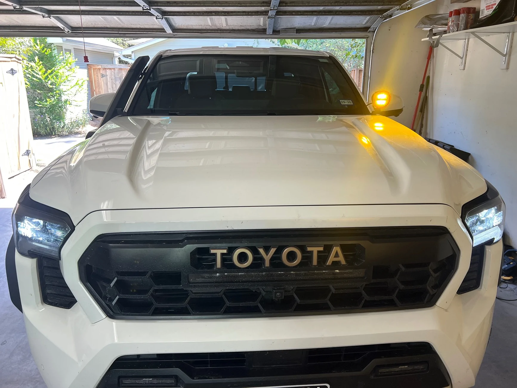

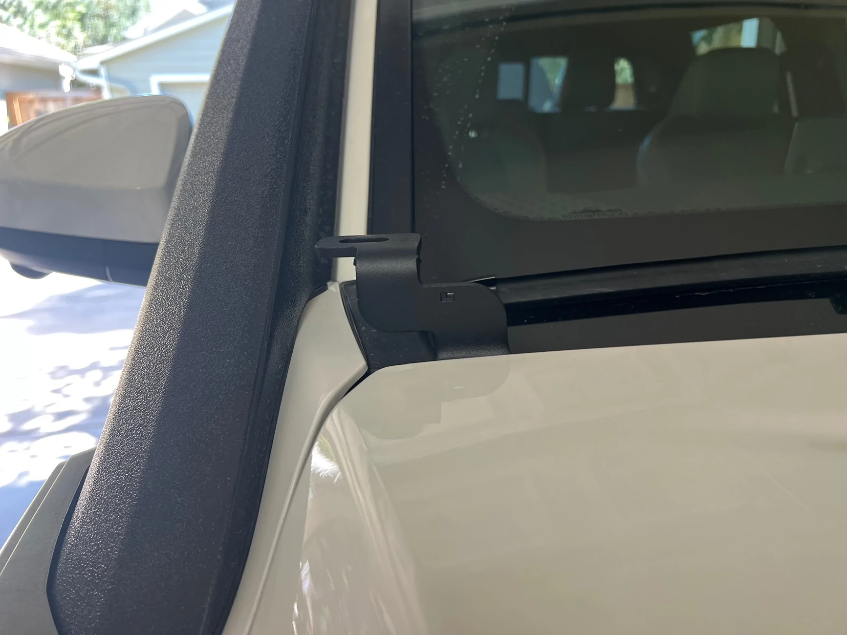

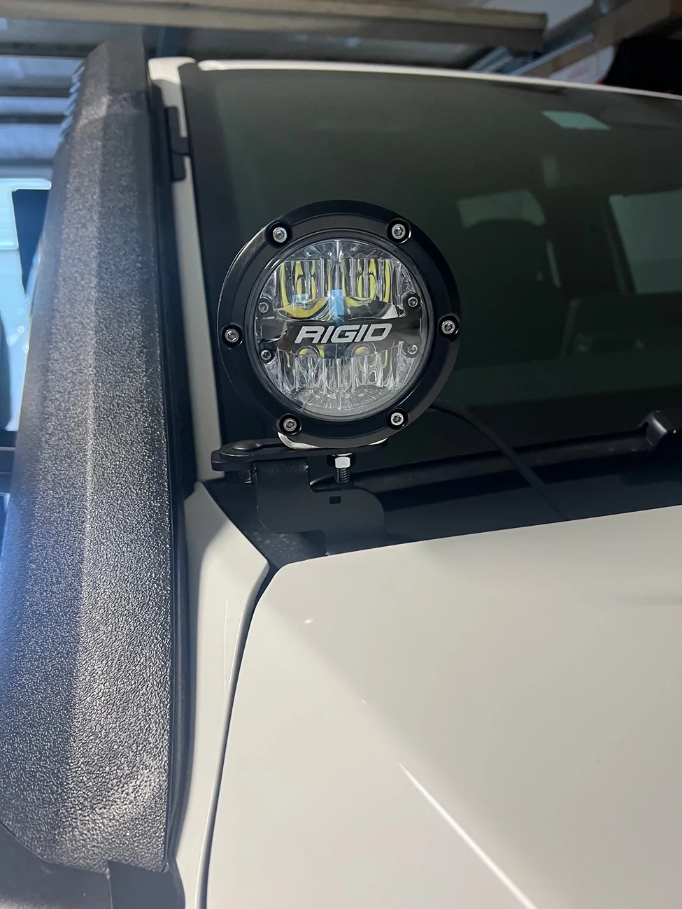

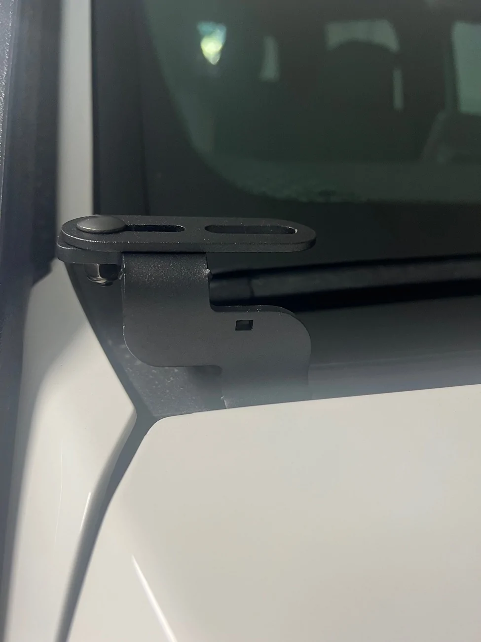

Hey guys - I got some kick ass Rigid 360s from SPV. The only issue is the passenger side ditch hits the snorkel when I open the hood. Even if I rotate it, it hits. All I can think to do is find a 2” piece of mounting hardware with a slot that I could use to shift the light toward the driver side by an inch (it would bolt into the Rigid bracket and then I’d bolt the light into that new piece of hardware to the right). If anyone has an idea where to get such a piece of hardware or if you have another solution, I’d appreciate it.

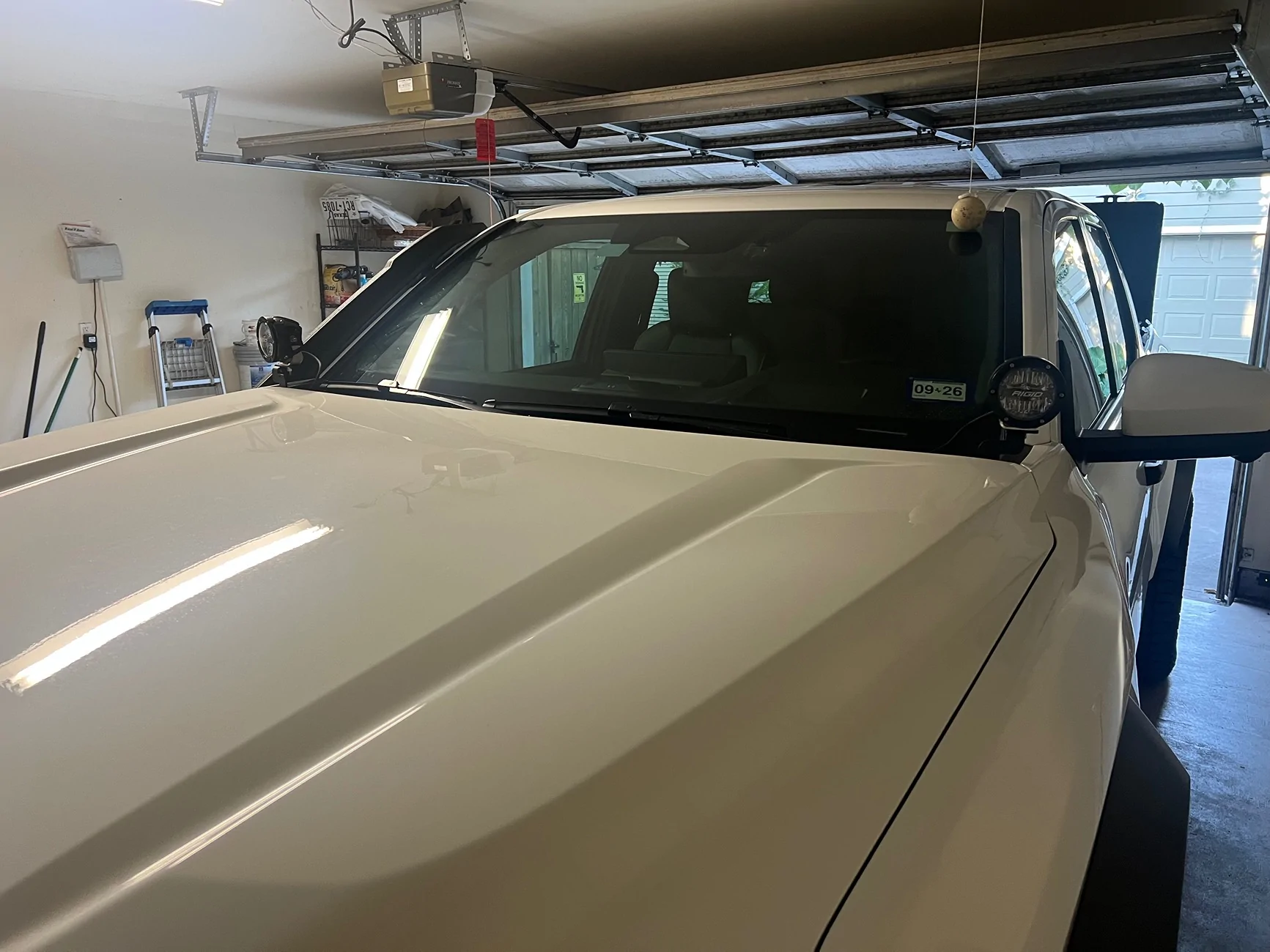

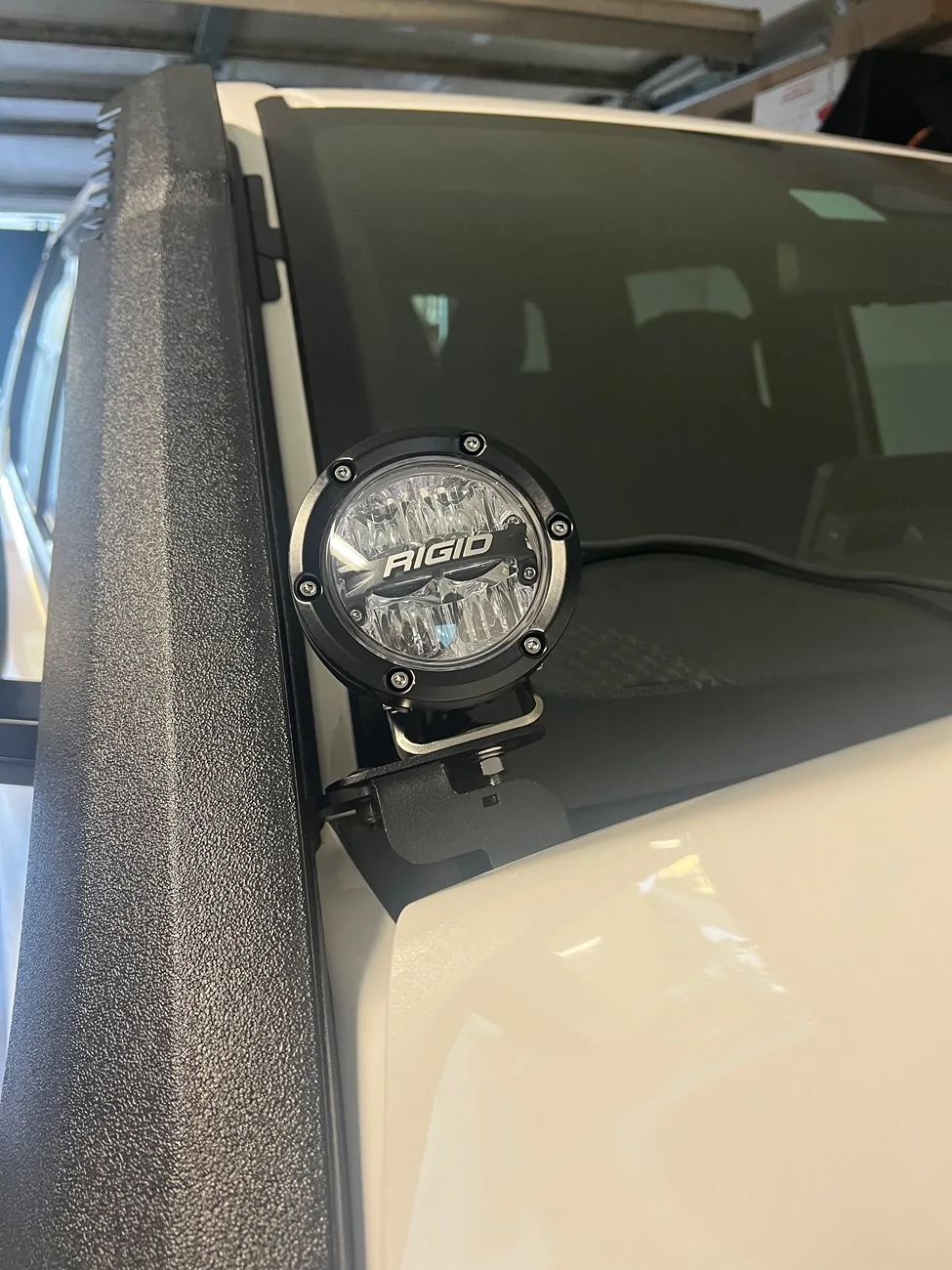

This little 3” piece of hardware (also Rigid) solved the problem entirely. Hood opens all the way without touching the snorkel. Is it aesthetically perfect? No. But it works and nobody will notice. Thanks @SPV Parts for helping me fix the issue!!!

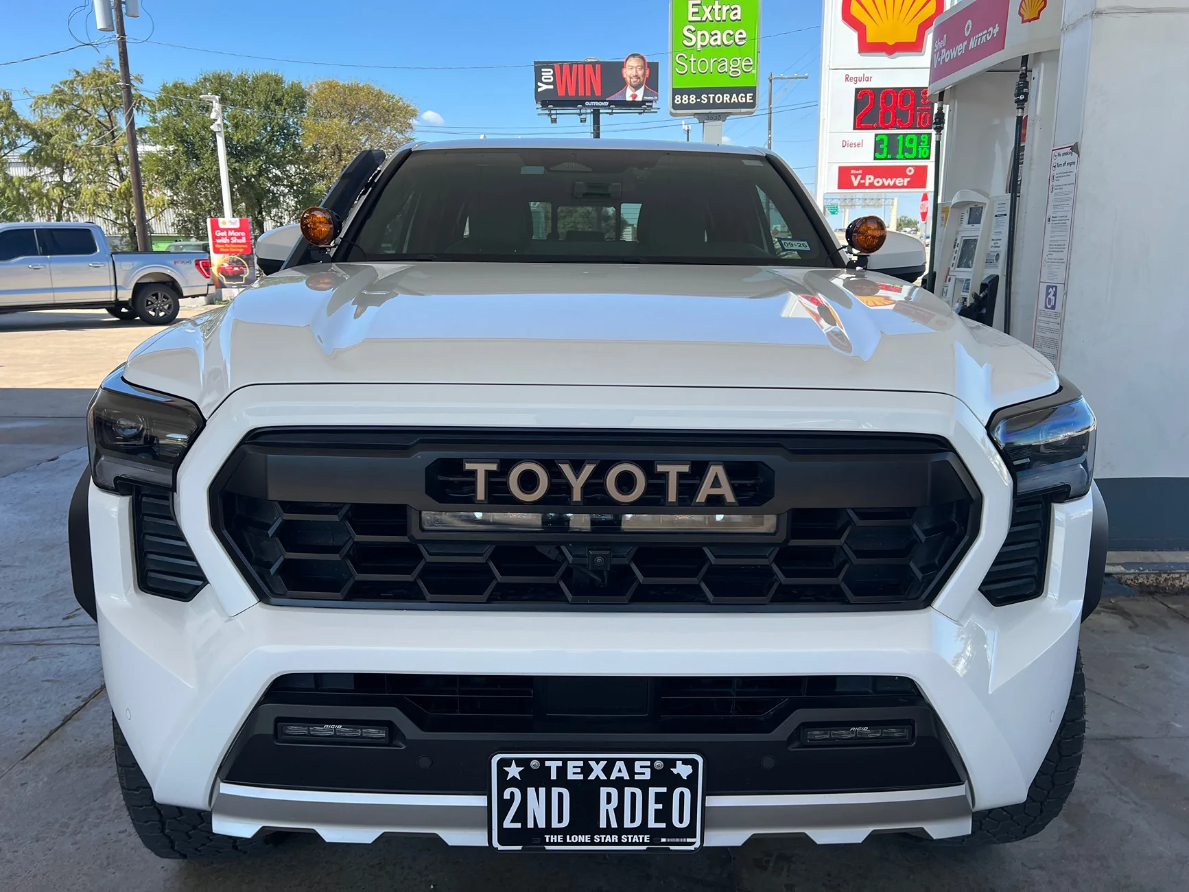

Loving the running light setup! I will put out a video on the installation process this weekend for anyone interested.
