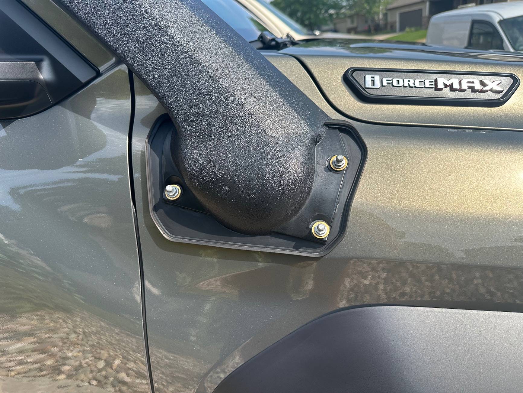

I'd be VERY CURIOUS as to the snorkel part!!! I've already complained directly to Toyota about the cheap crappy way that the cover on the bottom of the snorkel DOES NOT hold the cover on well at all. I was contacted my my local dealer customer service manager and all he was able to say was that Toyota acknowledged that there was a problem! Mine came off drying my truck and another TH owner said his fell off driving down the highway! Wow!! ...and they tested these trucks offroad? Obviously not on any washboard tracks!!! Pic of mine. These little balls on the protruding bolts are supposed to click into the plastic holders in the cover. While they do, they don't well at all. Sad design for a $65k truck.

2,395
3,086
@brentbba So Toyota has acknowledged that there is a problem with that snorkel cover but are they getting you a replacement? Do you know when you will get it?
I suspect it is a QC issue with a supplier, but Toyota is still on the hook to quickly fix something so lame on a halo model.
They acknowledge there's a problem, presumably with the design. No solution mentioned. I have my cover. I just took it off and am saving it. We'll just have to see if Toyota acts on the acknowledged problem.
No solution mentioned? They haven't said that they are going to get you one that fits properly?
Toyota usually does a good job of supporting their products so I assume they don't want one of their most expensive Tacos with exterior parts falling off. It makes you wonder if this is part of the TH QC holds.
Good luck.
Good luck.
No solution at all. We'll wait and see. I can't believe they're releasing Trailhunters with this.
Rope_photo said they did fix the ones that are being released, and others waiting on a part still...My ETA was actually moved up today, should be taking delivery in about a week, will definitely test the cover before driving it back ~750mi home.
All things being equal, I'll likely buy an aftermarket intake if there's a hydrophobic pre-filter design developed. I can't see the OEM high intake preventing a wet clingy 12" snowfall from entering that intake as-is....
I saw that post and speculating if the snorkel part is a redesigned cover.
given the issues you’ve had with your TH, do you think they should’ve held it for QC? I don’t know of anyone that took delivery sooner.
It’s like a catch 22; many are facing 70 day waits, some took very early delivery but don’t have [known] problems…
Good question. Bed scene lighting DOA should have held it. Snorkel cover, who knows. Everything else I've tested is good so far. Four wheel hi and low, rear differential lock and sway bar disconnect to be tested on a local offroad trip this weekend.
Yes, I did take early delivery June 18th!

So I have had my Trailhunter for 3 weeks. Last week we had some heavy rains and some water about 1-2 feet deep on the roads. After driving though this I was about 1/2 mile from home and the truck went into limp mode. Check engine code was for mass air flow sensor.
Had it towed to dealer and they said the mass air flow sensor was fried and because of water that it wouldn’t be covered under warranty because of “act of god”
Now how on earth water damaged the sensor is still unknown because the dealer did absolutely no looking into where it came from
Now when I bought my truck the cover was missing from the snorkel that looks like other people are losing theirs also. And the QC hold seems to be an issue with that gasket where the cover goes.
So if this is a know issue but toyota isn’t telling anyone then how are the dealers supposed to know there is an issue? If this is supposed to be a warranty thing because of failed parts so how can they turn down the warranty repair and how do you argue this?
Also the dealership said there was an unknown back order on the mass air flow sensor. Said it could be two months. So I made some calls to Phoenix area where I was told had two sensors. Both were special order for customers. I was then told there was one in Minnesota and one in Missouri. The one in Minnesota was spoken for so I called Missouri. They had one but it was for a customer but said it had been sitting there since July. He called the customer and they didn’t need it so I was lucky to get it.
Now after all of this I have fixed my own truck by finding the part and have researched the snorkel issue and have gotten absolutely zero help from the dealer. If this is how they are going to treat people who buy a $65,000 truck then I might sell it. I’m not going to put up with a company that ignores their customers. This is the way the world is going and I refuse to play the game anymore.
