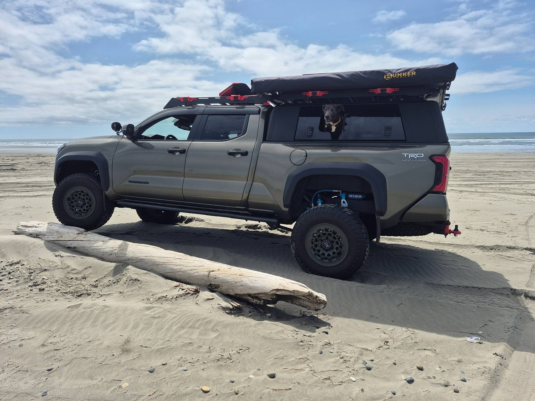

Happened to me in 4 hi on the beach. Running 255 80 17's with full air pressure. I have not tested it again but I bet it will happen again. My truck carrier some weight, but not enough to make 4 hi worthless for any length of time.
