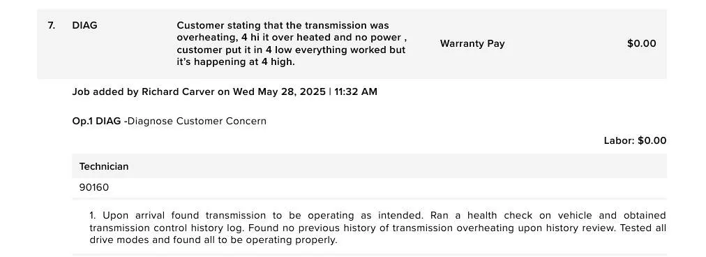

How is the technician supposed to duplicate the concern?
They can't fix what they can't find.
The technician's reply was that the truck's "transmission control history log" did not show a problem. That is how he/she is supposed to know what was going on. Apparently the data logging function is also broken, or else you got a technician who doesn't do the work but makes a denial of problem report anyway. OP: complain about BOTH problems to Toyota.

How it happened:
I was driving on a grated 2 lane wide dirt road in 4HI when the transmission overheated. I was loaded down with about 400lbs of gear and 2 people, 285/70r17 tires aired down to 20psi (2k miles on the truck.) I've done that road in a built and loaded down 4th gen 4runner and a F350 on 37s with a 3,000lb truck camper, and they both handled it no problem. I crossed an old Chevy Astro van that was coming downhill, and it made it. All this to say I expected my brand new TRD Off-Road Tacoma to be able to do this road no problem. I could see the transmission temp gauge start to go up as soon as we started going uphill, then the temp gradually climbed until it reached the red about halfway up the mountain at about 6k feet elevation. I lost power and it kind of felt like the truck stalled. I put in in 4lo and the transmission temp dropped a little below the red and stayed there consistently as we continued our way up. But 4LO was painfully slow for this type of road, and I was just itching to actually make some way up the mountain. So, I put it back into 4hi to see what would happen. Sure enough, within minutes the transmission temp was back up to red and the truck stalled. So I put back into 4lo and stayed there until we made it to the top.
The road it happened on:
I brought it to Toyota and this is what they said:
I asked the service advisor for his advice because the problem I had was real, and I expect that if it happened at 2k miles, chances are it'll happen again. His advice was to use my phone to record everything I can in real time and submit the evidence to Toyota. But the thing is I don't want to have to "prove" anything to Toyota, I just want the truck to work the way it's supposed to.
Has anyone else experienced this? What does the 4g community think? I'm thinking maybe I should have bought a 3rd gen...
