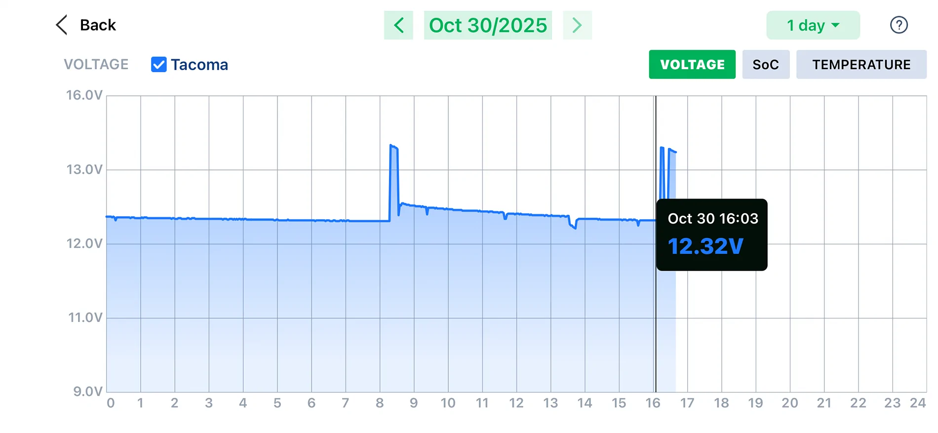

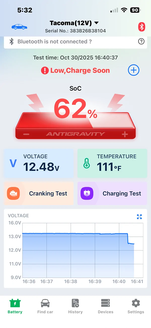

I got a handy battery monitor from anti gravity that I’d recommend. I have the aux switches and 180amp alternator. The truck always starts but not with a lot of confidence.
The battery was warranty replaced back in may (truck sat before sale) and it hasn’t been a daily driver.
this week is has been, and I had 12.3v starting voltage, or 50% charge leaving work today.
That was in 75 degree weather, so it will be interesting to see how it keeps up as it cools off.
I moved the low charge alert down to 45% to minimize notifications after this photo.
I’m probably going to upgrade to an optima yellow top because I’ve had great luck with them in the past and I’d recommend the battery monitor to anyone wanting to data log the battery.
