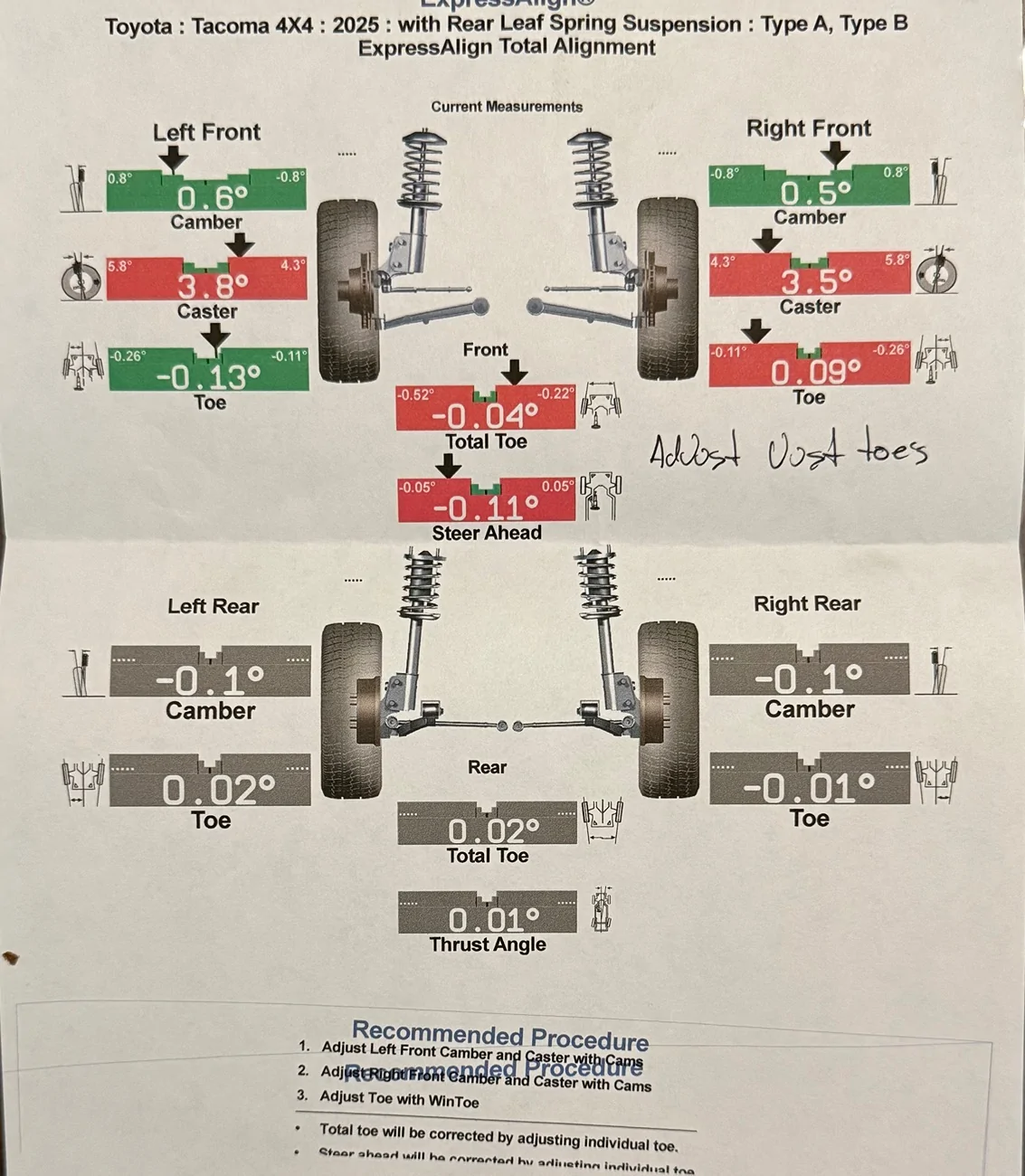

What do you think about this alignment. Recently done by a dealership, truck still pulls to right and steering needs constant left pressure to track straight.

Looking at that alignment sheet, I'd be looking at a different cause, like a brake hanging up or something causing drag on the right side.

I went to dealership again, they wanted to rotate front tires, which I told them I will do myself since their wait time was almost 2.5hrs. Even after rotation I still feel the same pull. Went to dealership again and they said they need the truck for a day or more which I refused because i don’t have another vehicle. Talked to toyota afterwards and they started a case, will hopefully hear from them. Later on I got a free alignment check at Brakes Plus and this is the result. There’s considerable difference. Would the tire rotation from L to R have caused this?
Your toe is totalled fked. I would just ask an independent shop to zero it out. Toyota doesn't do that for ? reason. A little toe in -.10 may make for a slightly less darty truck on the freeway but zero toe is easier for techs to aim for.
i don’t understand how does the previous toyota alignment and this alignment sheet can have such difference. Does that mean the toyota tech didn’t do it right? You will see the toyota sheet two or three comments above.

You have a really great thrust angle, that truck is a keeper...!
Your caster is making it pull to the right you need to turn it around
Aim for:
+.5 camber both sides
+ 3.5 caster front driver /// +4.0 caster front passenger this will take care of road crown a bit.
+.05 Toe equally on both front wheels
That should fix it.
Explain how is you truck driving now.
The fact you got such a different alignment result by going to another shop is telling that Toyota dealer tech messed up on the first alignment.
Yeah for a 4 link that is pretty dialed in. It's kinda crazy, it's such a dice roll for 4 link trucks.
