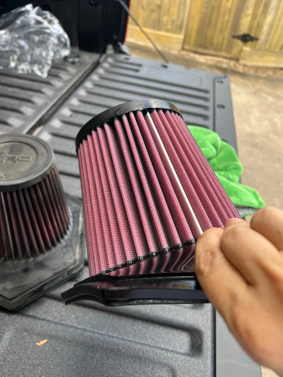

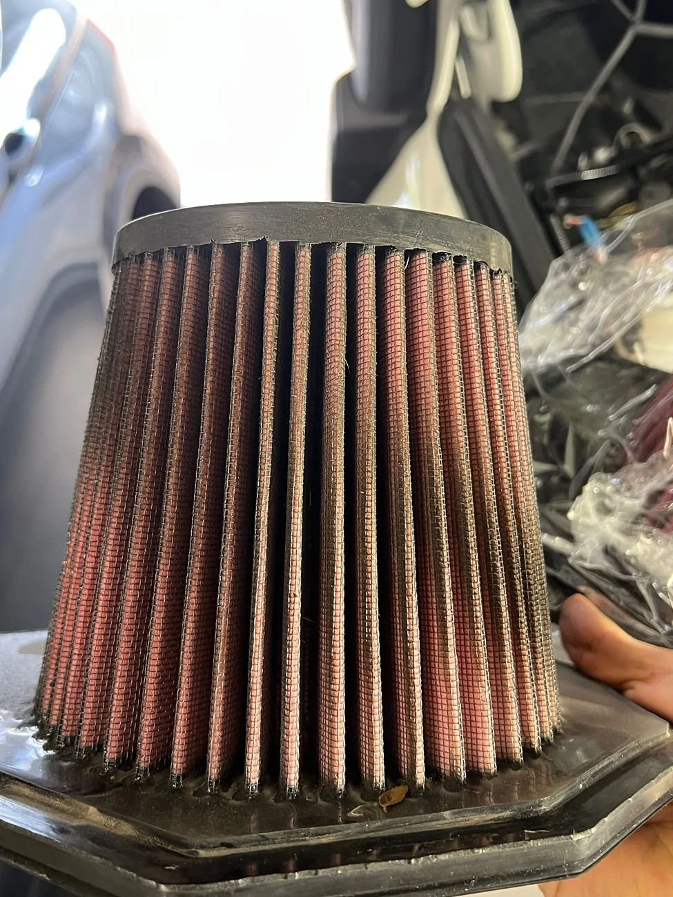

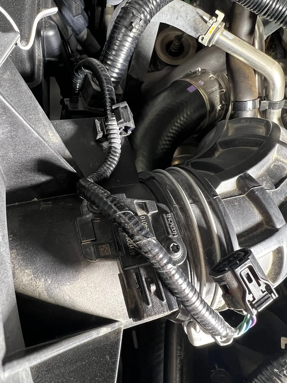

Just replaced mine. If you disconnect the mass air sensor it’s super simple and quick.
2024 Tacoma Trd Pro / Trailhunter engine airfilter IMG_8187
2024 Tacoma Trd Pro / Trailhunter engine airfilter IMG_8182
2024 Tacoma Trd Pro / Trailhunter engine airfilter IMG_8183
The new filter only had a tiny bit of oil on it. I was tempted to add more, but I didn’t wanna mess with the OEM spec.

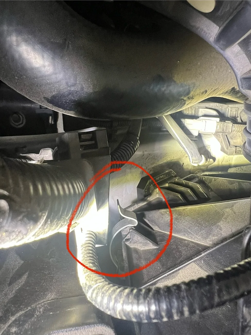

Did the filter housing clip back together this time without any distortion?
It just goes on and off easier now - everyone with a TH reports the fourth clip does that so it’s probably breaking in now

I haven't had that open on my Pro, so it will be interesting to see if it fits the same way. Do you plan to clean the original filter and then use it again when the new one is ready to change?

I do indeed - got the
I do indeed - got the KN cleaner and oil kit
