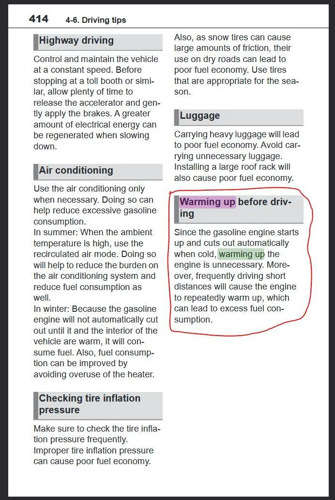

This is what my 2025 Hybrid manual says, and we have the exact same engine, however I do notice better shifting of the transmission on cold days when I let it warm up before pulling away
I always let it warm up if I'm jumping right on the highway.
Thanks for the feedback brother ! 👍🏼

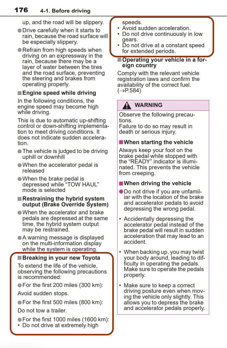

Anybody follow the break-in procedure? LOL. I have only 175 miles on mine and I've 100% given it the "sudden" beans 😏 !!
Was also interesting to see Toyota mention that the hybrid system may not start when it's -35c and below. The resolution is to wait until the temperature warms up. Ha! All I know is I watched the lot guy walk out to my new truck (just before I bought it)...get in, start it up, huge plume of black-ish smoke out the exhaust pipe, shift into revers 5 seconds later, back through a snow drift, and pull it into the showroom. Was -30c at the time 😩 poor thing
2024 Tacoma Engine Idle Warm-Up how long? Screenshot 2025-02-22 at 11.03.07 PM
Some of my location and travel is in really cold places. Never more than a minute seems fine and I don't do high speed or hard acceleration until I see engine oil temperature and transmission temperature building.
My wife's German car with VAG EA888 gen 3 in many Audi and VW vehicles manual said no hard acceleration until oil temp starts registering and that's 150 F. I treat the Toyota engine much the same.
