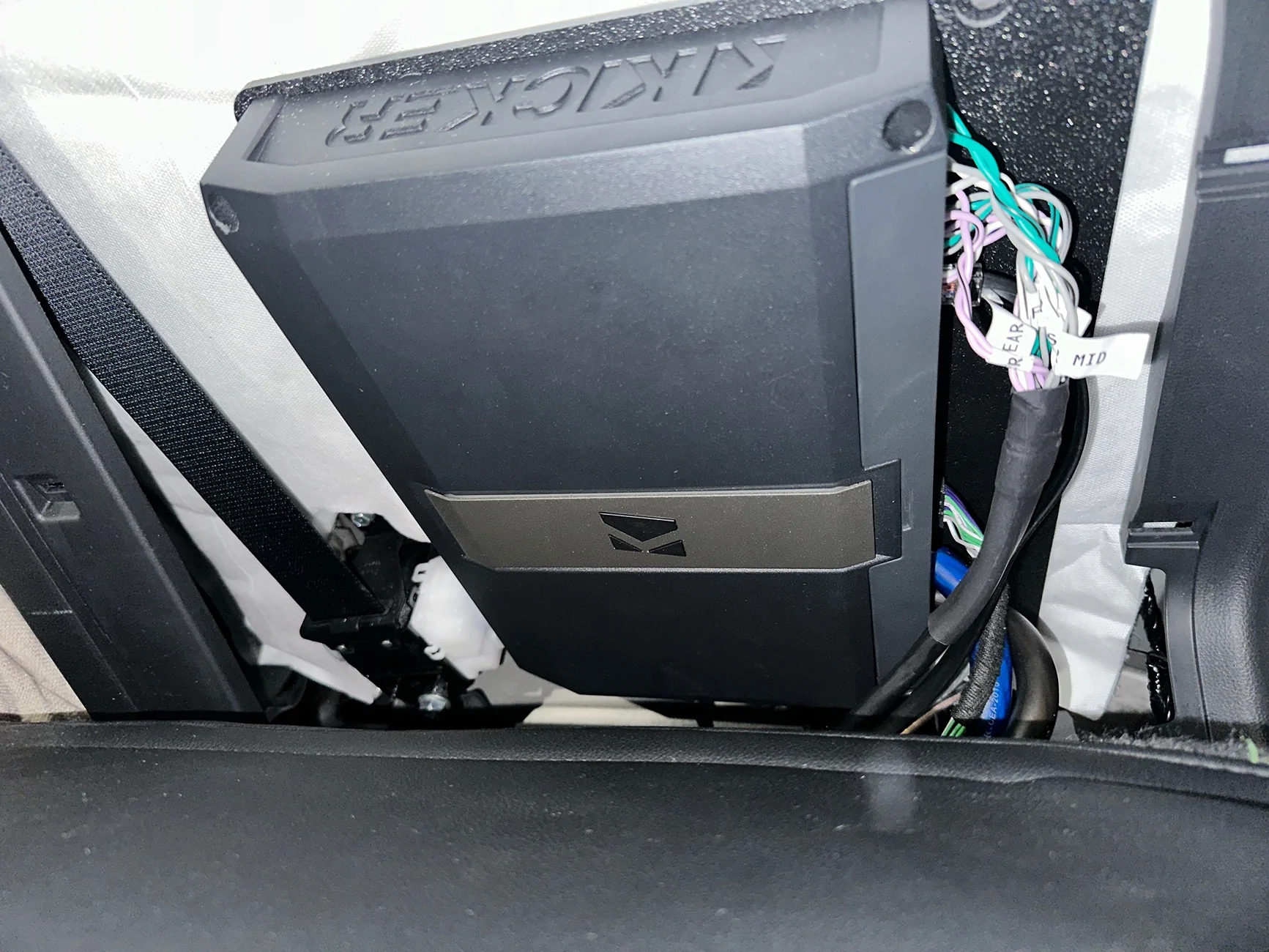

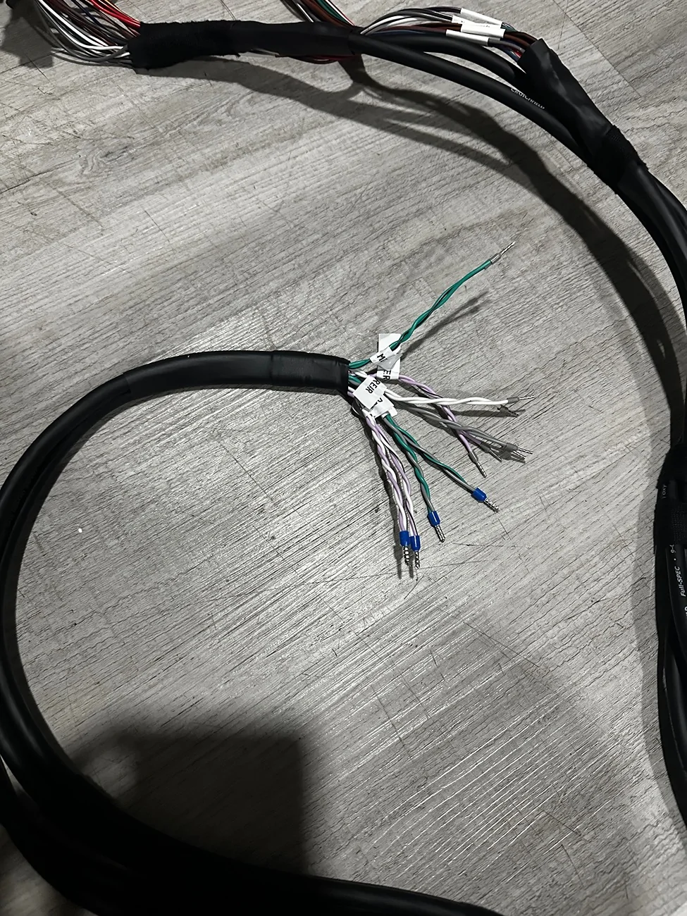

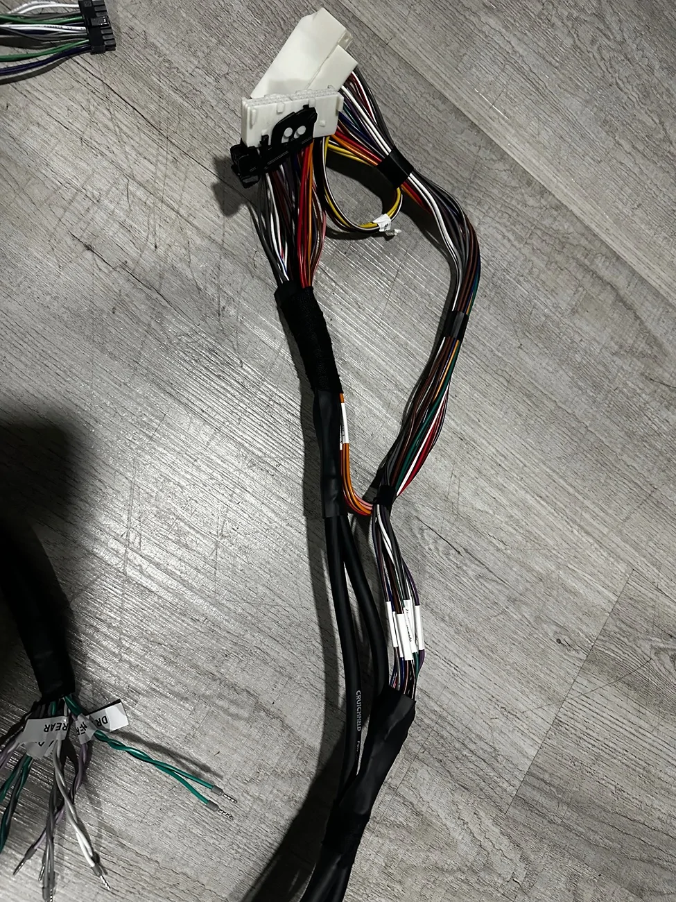

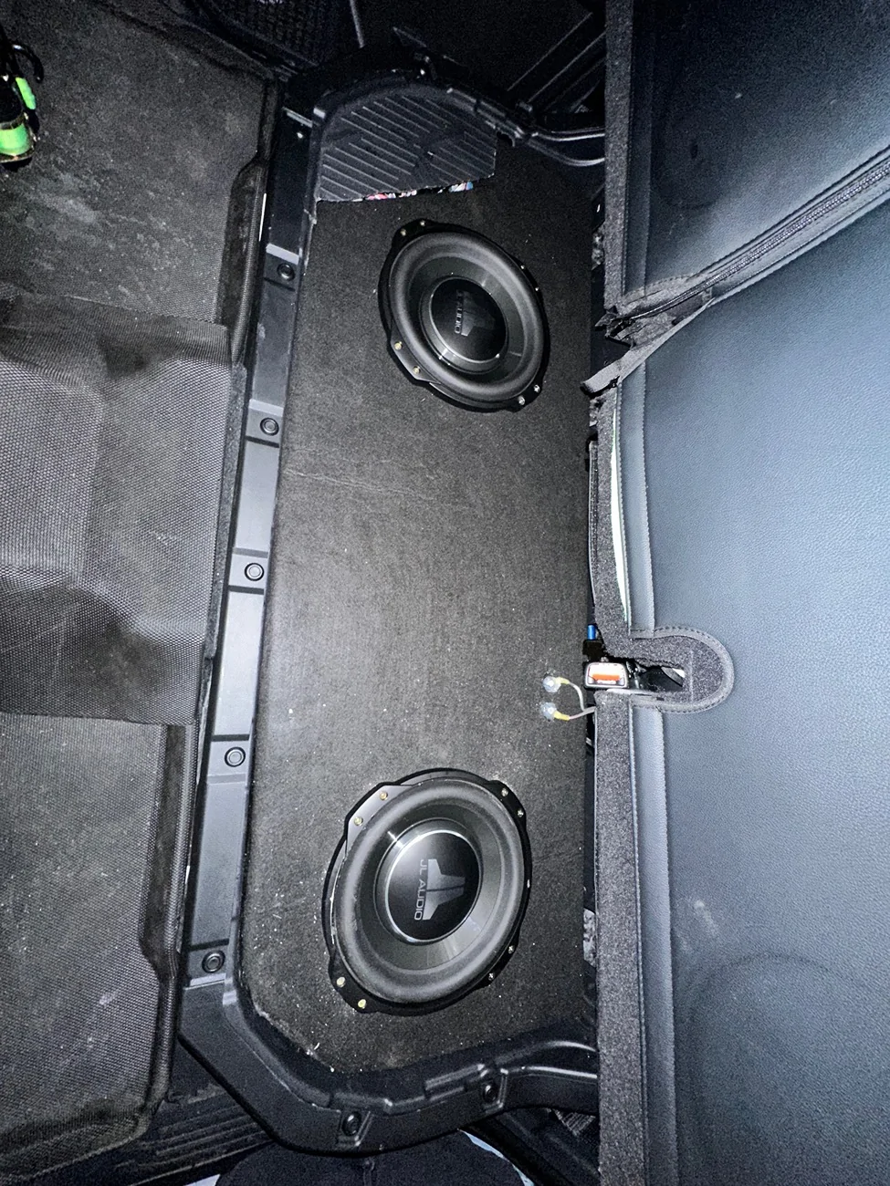

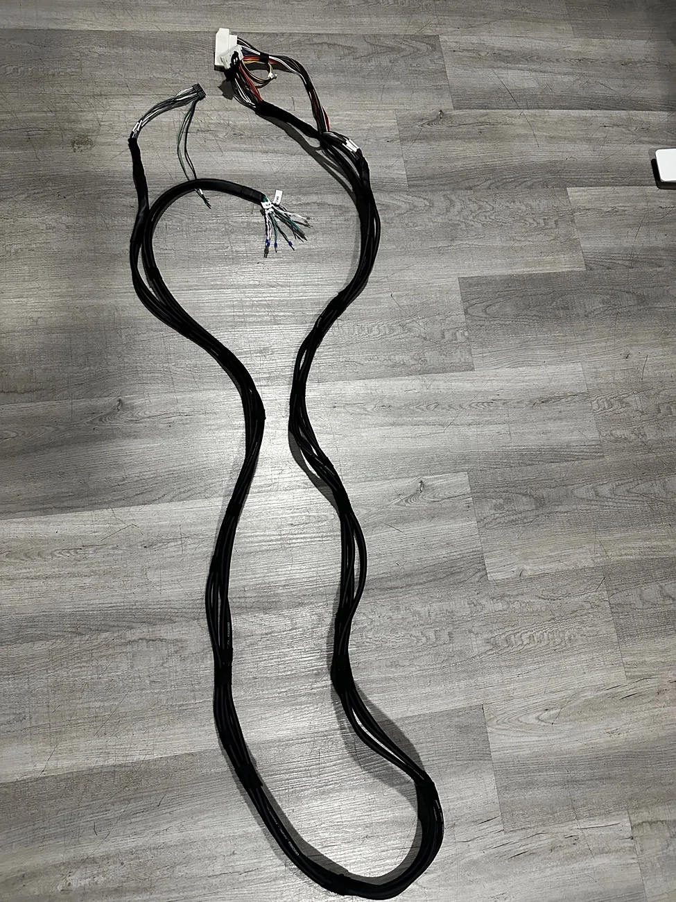

Here's a sneak peak of my work in progress...
Equipment list:
-Front Door/tweeters: Alpine type R 6x9 components
-Rear door: Alpine type R 6x5" coaxials
-Dash: Hertz 4" DCX-1003
-Sub: (2) JL Audio 10TW3-D4 wired to 1 ohm
-Amp: Kicker LX1300.7
-Custom fiberglass subwoofer box
-T-harness made using APH-TY02
I've been slowly upgrading my sound system in stages over the year and a half of my ownership. I've been waiting to make a full post about the details of my sound system, but I'm seeing a lot of posts about others trying to upgrade the JBL system. Figured I'd share what I have so far. I'm definitely not an audiophile nor am I a professional car audio installer. This is actually my first sound system i've installed that was more than adding a subwoofer. This time around, my goal was a decent SQ system. I wanted to be able to hear the vocals but still wanted bass. I'm sure I could have better results using the PAC AP4-TY14 amp integration interface, but I didn't want to spend the money at the time.
For starters, I used TechStream to disable ANC and the fake engine noise. Technically the 2024+ models aren't supported, but I selected the 2023 model and I was able to communicate with the ECU still.
It sounds better and louder than factory. Mirrors shakes. My only complaint is that the center jbl speaker (still on factory JBL amp) can overpowering/harsh at times. I'm using passive crossovers for the front speaker and tweeter connection at this moment. My next plans are changing the wiring to a full active crossover for the front speakers and putting the rear speakers back on the factory JBL amp. I have a set of focal tweeters I've been waiting to install but it's been too hot to pull the wire harness out and make changes. I'm also going to try to replace the removable JBL center speaker with a pair of JL audio 3.5" speakers I have laying around. Planning on wiring them down to 8 ohms so it's not as overpowering.
I don't have DB readings comparing factory to now. But TacomaBeast has a video showing their comparison between stock JBL and their upgraded amp at the same volume I normally listen to.
Skip to @30:12
Sound clips with DB readings. I think the file was too big to upload directly on here. Listen with headphones for best results.
https://drive.google.com/drive/folders/1Jc8OKUduIKegXyB6O9qK_cClR4psh370?usp=sharing

What harness did you use instead of the pac ap4???
