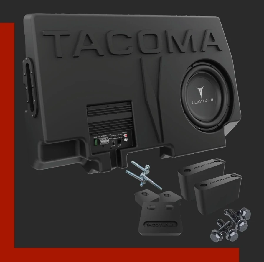

I was hopefull the JBL system would be a little better. It seems the IB 10" is just too light duty to do much (must have 1/4" ptp excursion?!). I have the Tacotunes enclosure ordered to replace the JBL sub. I dont typically buy premade boxes of unknown tuning, but this was a really tight spot. I would like to measure the truck with the minidsp now and then after with the Tacotunes sub in. The next step would be finding an easy way to cut-off some bass going to the front door speakers, trying to keep it all cheap/simple.
If this doesnt do it, I may have to go to Orella or Audx...but Im hopefull this will be enough to save me all that time and money.

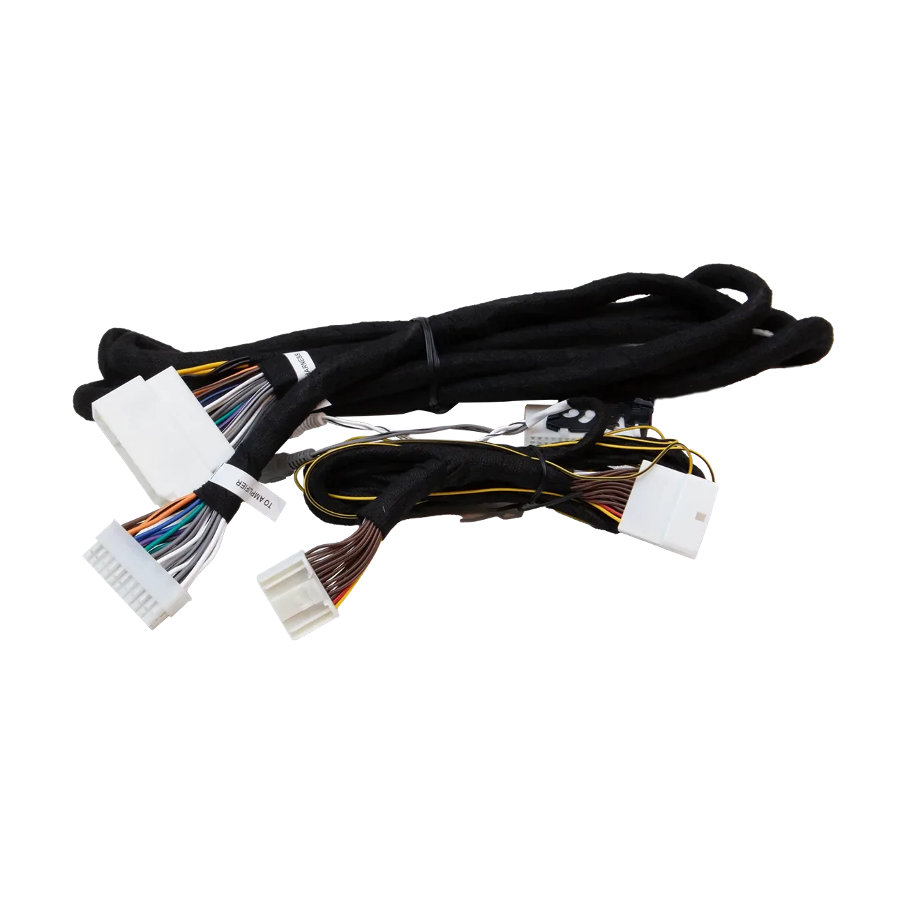

The JBL system upgrade harness from AudX is now available. I know some will complain about the price but before you voice your dislike on price check the quality, competing product availability and the amount of time it will save you to upgrade your system.
https://www.audxsound.com/products/tyaih22uf10
2024 Tacoma JBL Sound System Upgrade? TYAIH22UF10
OGC3102
Omar
Feb 21, 2026
Colorado
2026 Tacoma TRD-Offroad Hybrid
I forget how new our vehicles are, lol thanks for sharing the link for the harness I was searching everywhere for something plug and play for my hybrid with the jbl now I can reuse my old sound system
