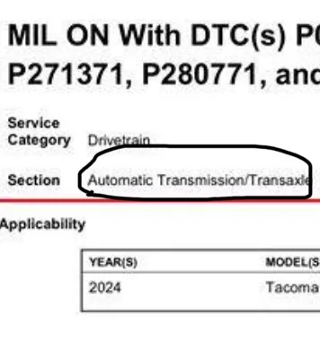

Good info but I still think he gets it wrong. There are manual transmission VINs in the TSB.
The manual is excluded. It doesn’t have solenoids. Just gears. The TSB clearly states automatic transmissions. My vin has is outside of the TSB so it’s excluded in the same way as the manual transmissions. It is in black and white.
frosty4x4
Aug 23, 2024
39
Midwest
I wish that were the case but the E in 3TYLE5JN stands for MT and is in the TSB…
